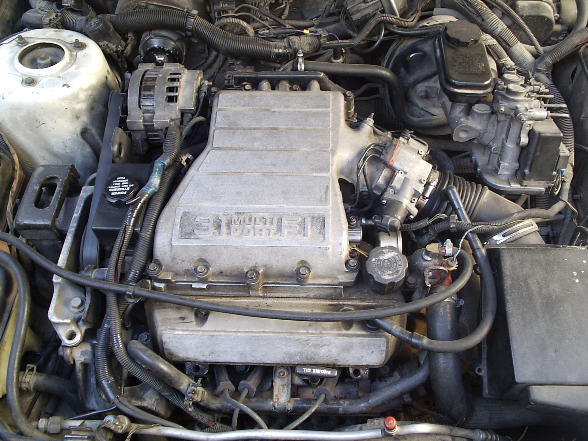

My engine. No EGR

Re: Hello from Ukraine. Pontiac Tempest
I asked because the coolant temperature sensor has plastic on it. Yours dosen't.
