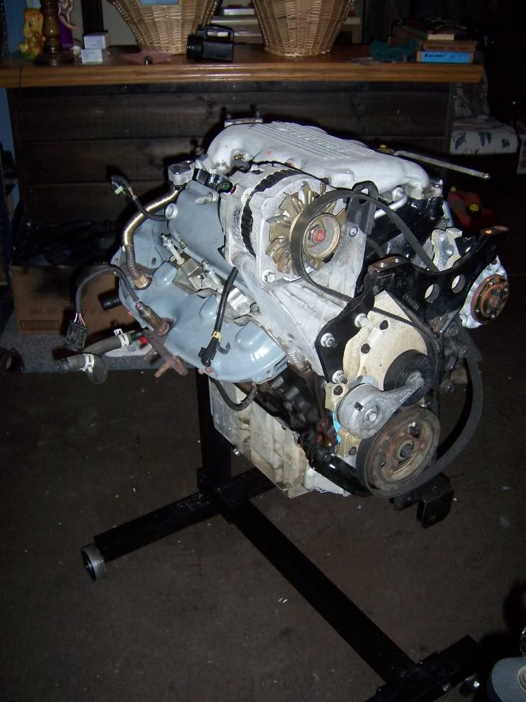

No. The tensioner is located below the alternator area (the pulley that is near the top back of the engine, right near the firewall) Follow that down and you will find the tensioner below and slightly forward.. The water pump is the most forward upper pulley, has a smooth side, the belt goes around it upside down with the ribs facing out (bottom side of the pulley). There are 4 bolts that hold the pulley to the pump. You need to crack those loose while the belt is on, so it doesn't move on you. Once they are cracked loose, then you need to remove the belt as described earlier.
Here is a quick pic to give you an idea where to be looking:
That should give you an idea where to look.

Here is a picture of where the tensioner is and slight belt routing path, missing there is the PS pump and the AC compressor.
If you do not understand what needs to be done after seeing this, then do not attempt it and bring your car to a shop or have a friend with a bit more experience lend you a hand. If you have trouble visualizing things and putting 2 and 2 together then you should not be using a forum to help you, you need hands on help. I will not respond to a post that says "Help I removed my belt and now I can't get it back on!"
Also this is as much as you can see with the splash guard removed so don't expect that to solve it all, and you only need to remove the motor mount to remove the belt... which you are not doing.
