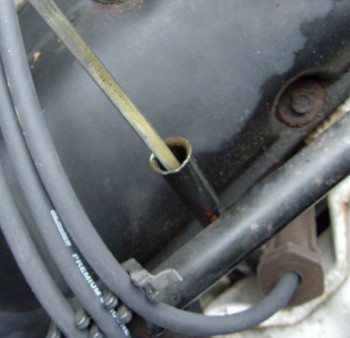

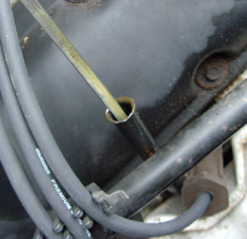

Well... this is the end of my car. I started it up to let it run and see if it would blow warm air, if the hoses were warm, if the radiator was warm. I got more than just "hot air meets cold air" mist out of my exhast.
When it hit the halfway mark and still no warm air, I turned it off. Hose exiting the radiator was cold and squeezing it gave an audible gurgly air sound. Radiator was cold, hoses were cold. I was not looking forward to checking the next thing because I had a feeling I knew the answer.
The head gasket is shot (I assume). The other day when I did this, oil was perfectly fine. This time? Milk. There's nothing I can do for the car at this point. Having a head gasket done is likely in the $700 range, and I'm already broke (and my card is maxed out). -_-

With the symptoms, the results she posted, looks to be a head gasket failure. I was concerned that this may be the result, from what she described earlier... Sucks. 3400 time! IF we can rouse up a charitable solution... Though with all the rust issues its had, not sure if its worth saving?
