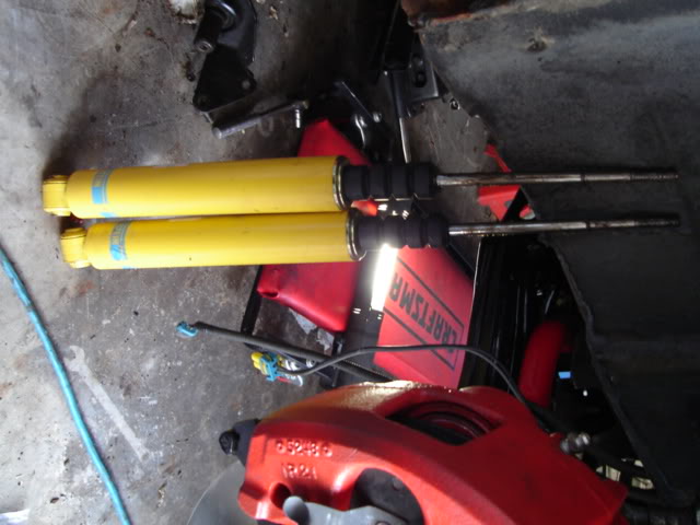

I'll put some pics up later of the struts... How can I tell if the shocks are Bilstiens though?

bilstein rear shocks are yellow. i dunno if boner painted them.

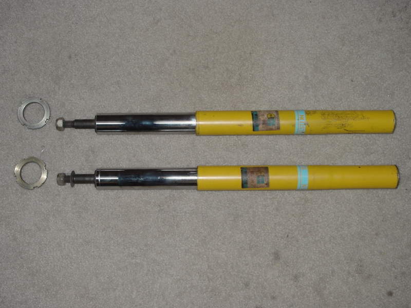

Those front struts are very nice and use a unique double valving. Not all the Bilsteins are like this..as they do OEM replacement for some cars. This double valving makes the shaft much thicker.
The valving is very nice for aggressive springs. There is different strut insert valving depending on the design. Geoff could chime in about the race inserts he first got that were incredibly stiff and for racing only. The 5 other sets besides yours were sports.

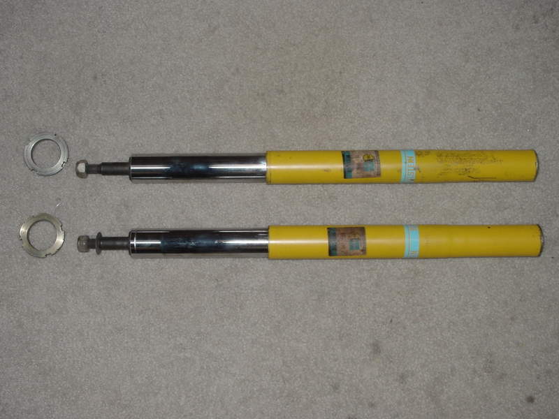

Look at this photo...these are strut inserts...and i believe the same or similar to what is used in the Beretta.

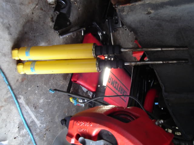

Re: It's Geetee; and I have a GTU and a 3400 engine
Yes they are the real deal - I got them directly from B-rad.
Heres the pics - and yes you got Eibachs as well - going way back they where in a group buy that Ribz put together.
If you look at he struts and or shocks - the part numbers where ground off of them as I am guessing Mantafart bought new struts and used the shells for there racing struts.
I POR-15'd them years ago, then primed and painted them as well.
