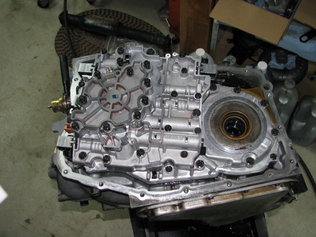

Side of a 4t60e where the valve body and solenoids are located.
I'm not a newb at this....
You can see the bottom in this photo with the accumulator pistons and such, filter removed.

That's a little inconvenient. On my 4L60E the shift solenoids, 3-2 solenoids and pressure control was all accessible from the bottom by just removing the pan & filter.
Re: Anyone ever have an Auto Trans do this?
Yeah I know tell me about it. The only convenient thing about this trans is you can swap in a diff rather easily so if you wanted to go from a welded solid one to a open one you could.
The only thing you can do from the bottom really is shim the accumulators which will help with shift firmness and shift time so its not all bad.

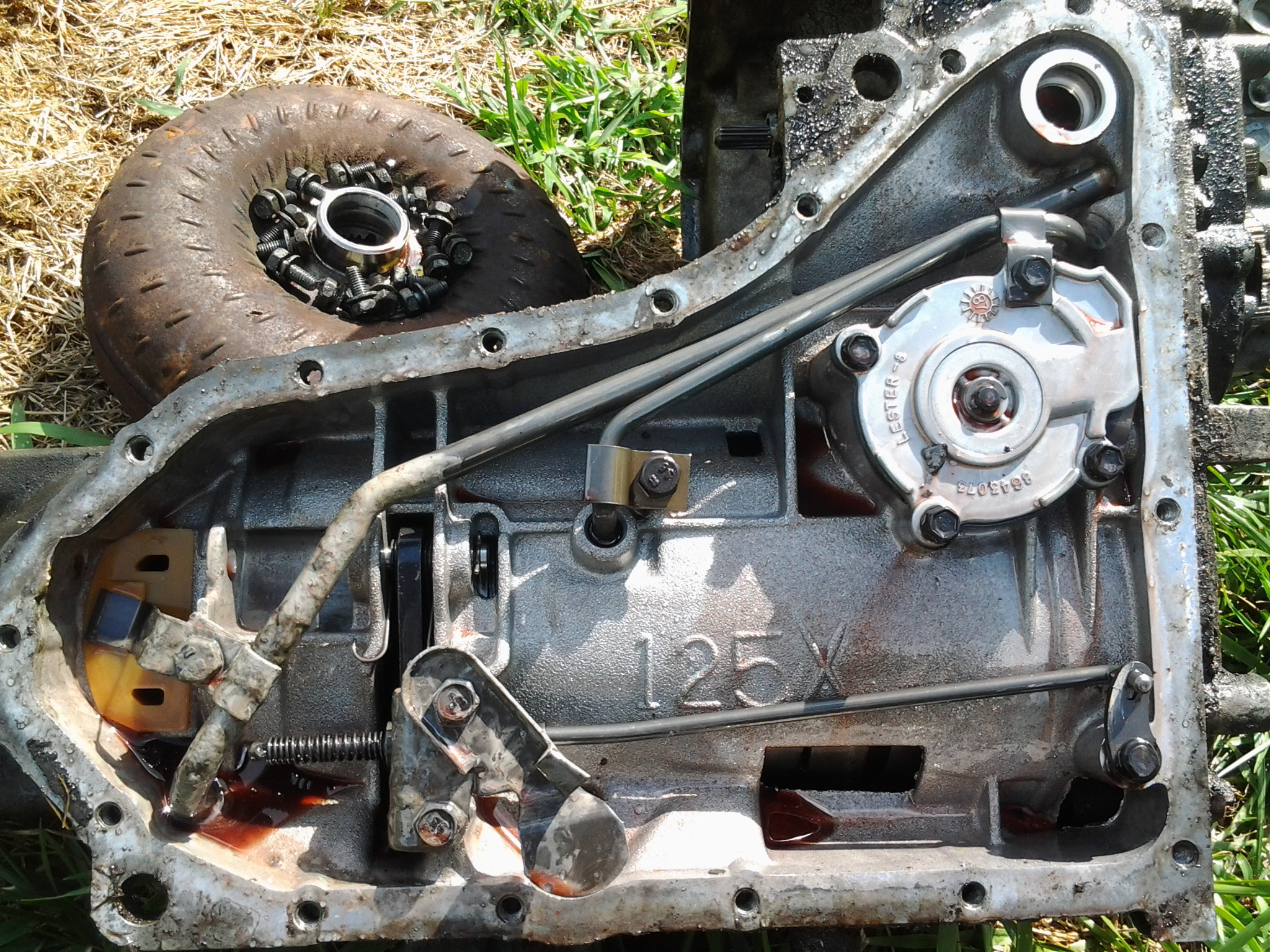

A day later than I said I would, but here it is.
Transmission 3T40.
Transmission 3T40.
Thanks. Well my mind is gone for sure then. I have had a THM250,350(two of them) and 700r4(1983) before the 3T40. None of those would have anything like what I was talking about. Sucks to lose ones mind. Well it runs in the family.
