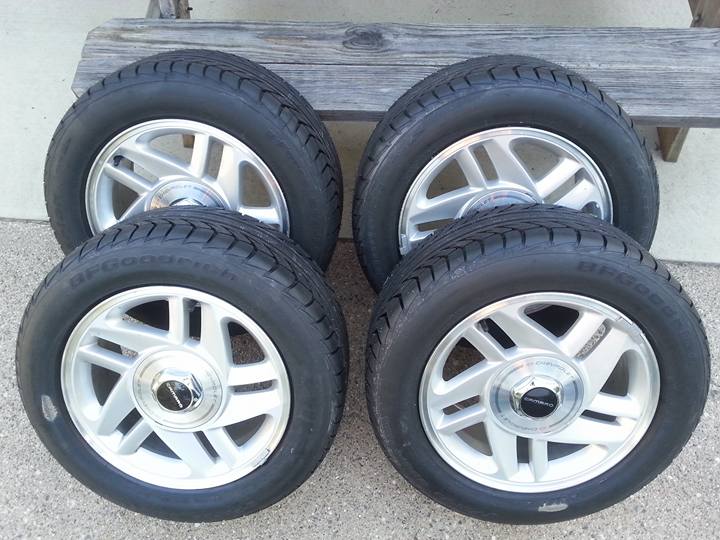

Got a spare set of 16s that were in near perfect condition for free. And got a new set of 245s to burn off

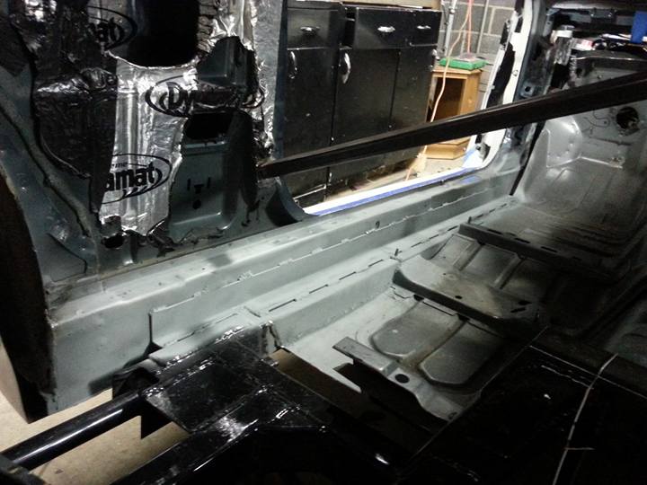

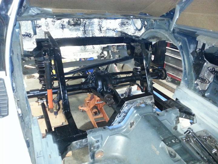

Post by jjanke »

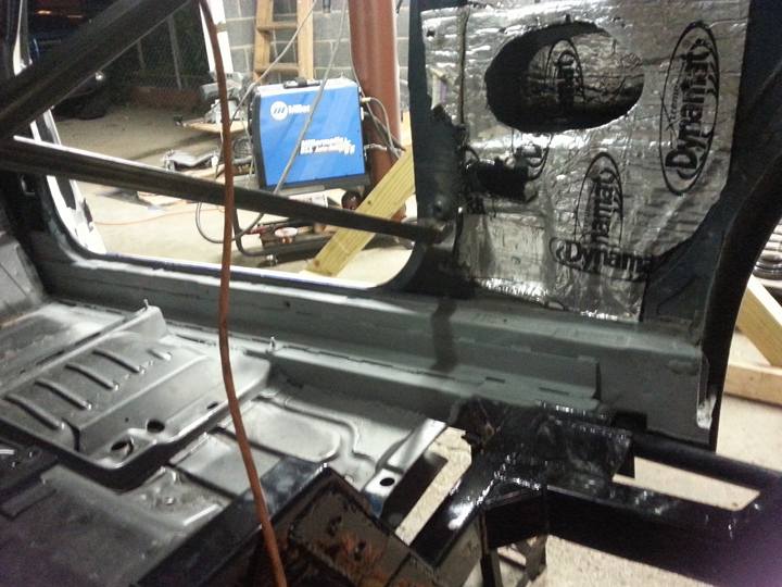

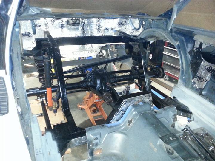

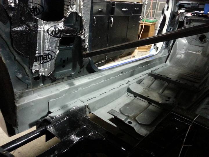

Cut out the x body braces and stitch welded the body flanges to the frame rails

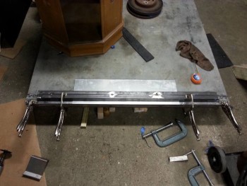

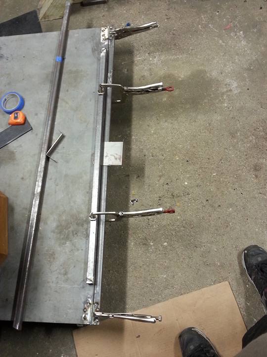

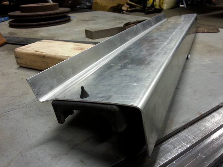

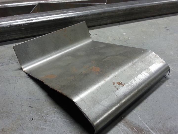

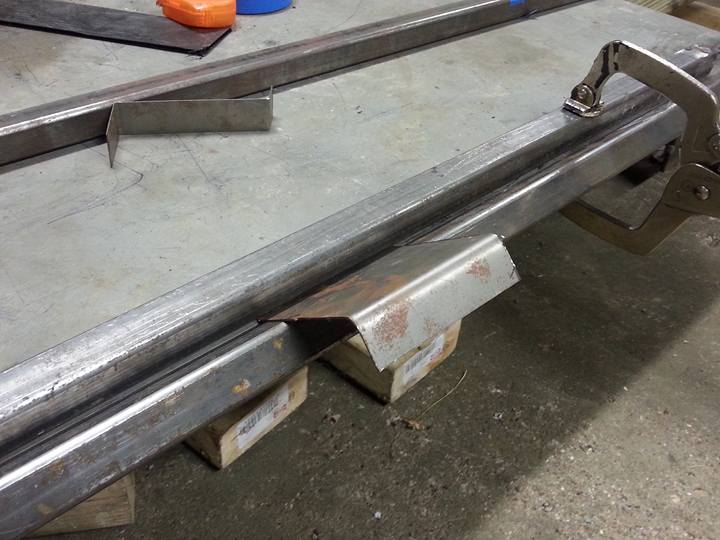

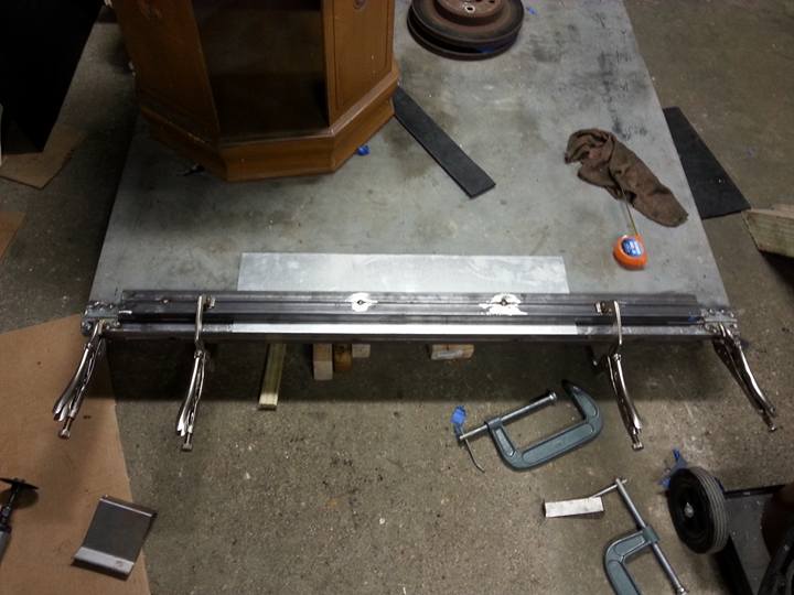

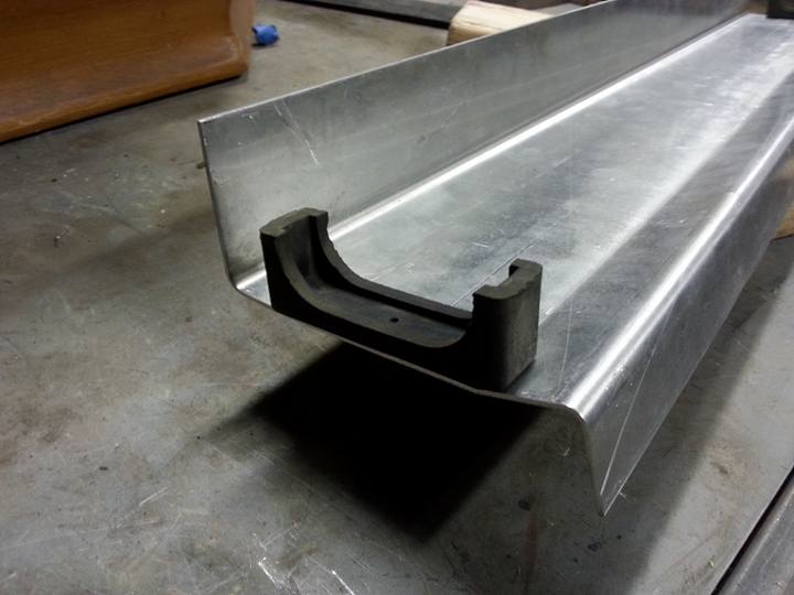

Post by jjanke »

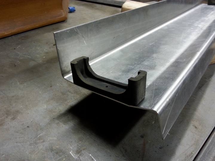

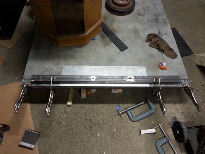

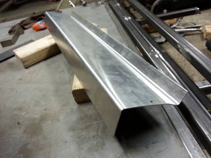

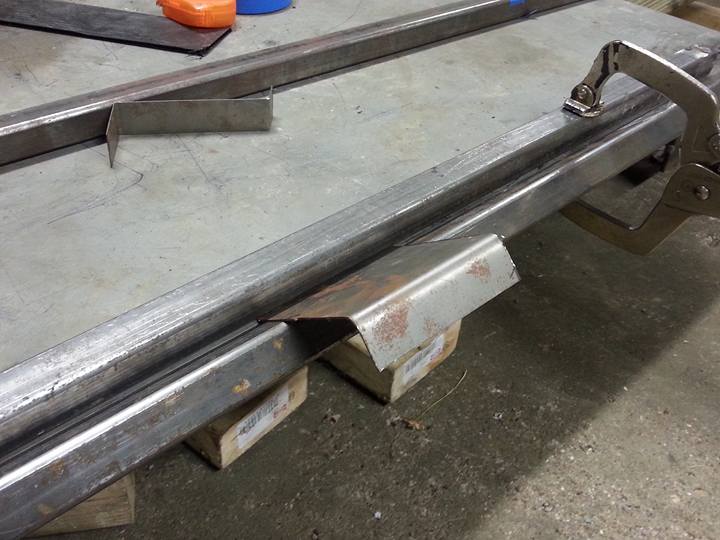

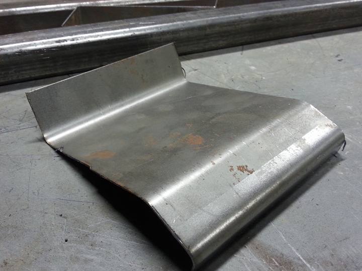

Put together a sheet metal brake with some 3.00 $ hinges and some scrap 1x1 square tube. Made some test bends and think its gonna be great for making some quick panels for the build and what ever else...radiator shroud and wiper cowl coming soon

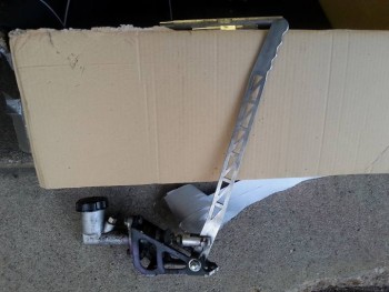

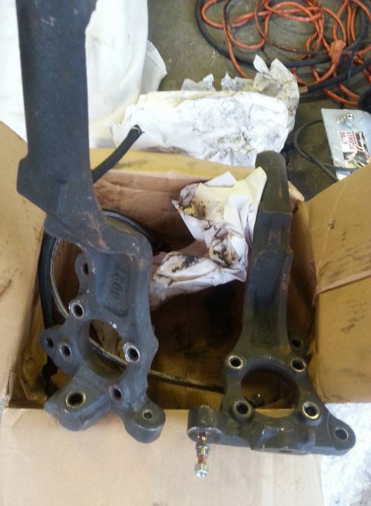

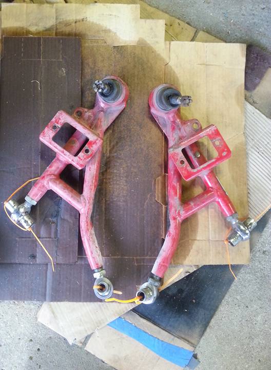

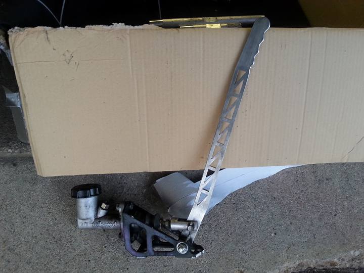

Post by jjanke »

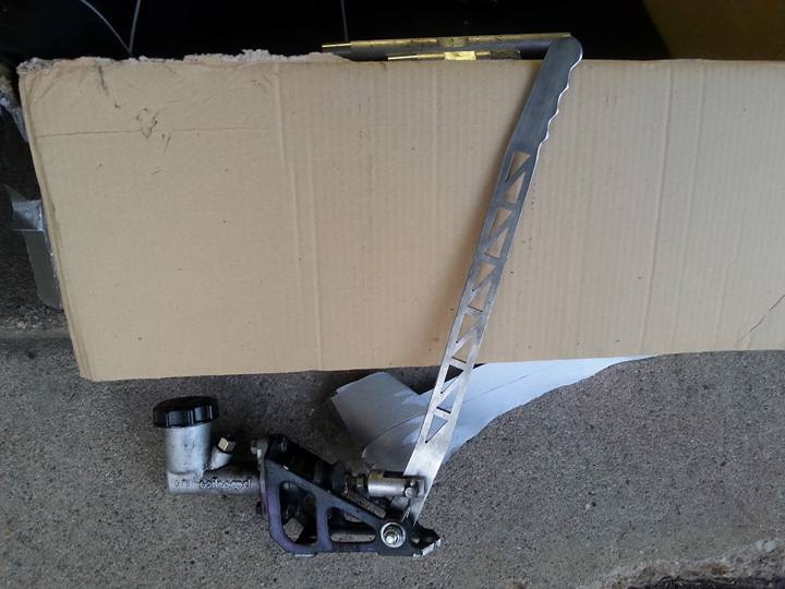

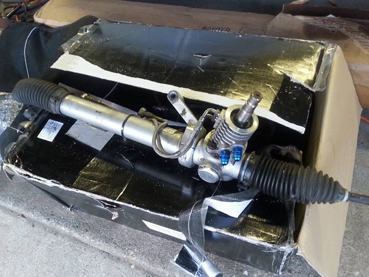

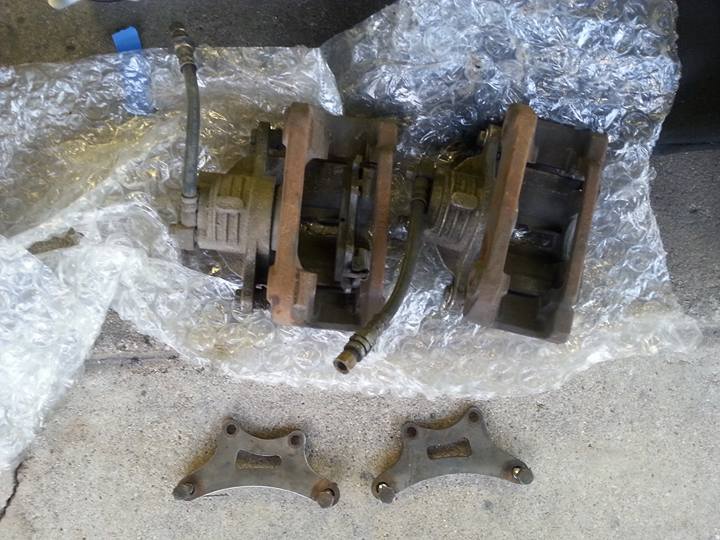

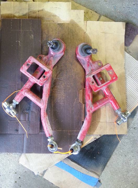

picked up some goodies!!!! Modified front spindles, power steering rack with extended tie rods, tubular lower control arms, hydro handbrake, and dual rear caliper set up..... this is the stuff thats gonna make the bere
tta or camaro a competitive chassis with lots of steering angle !!!!!!!!!!!!!

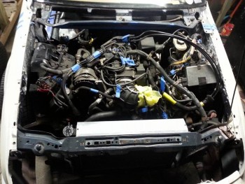

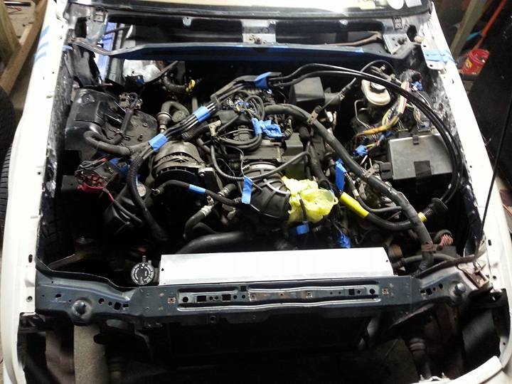

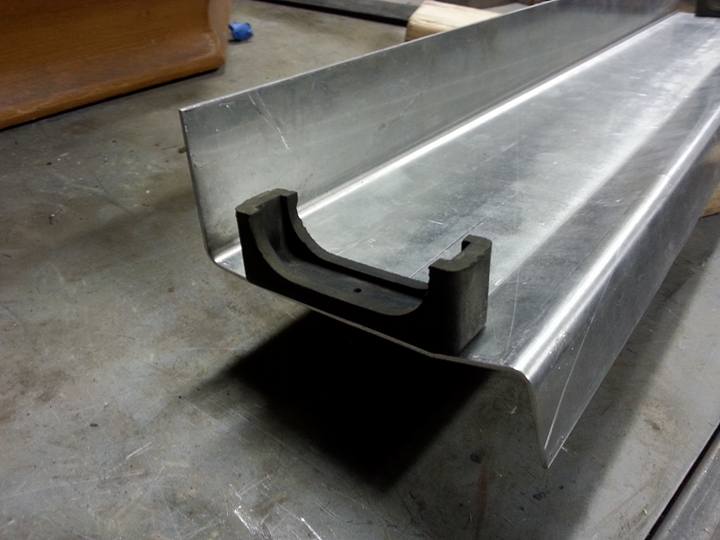

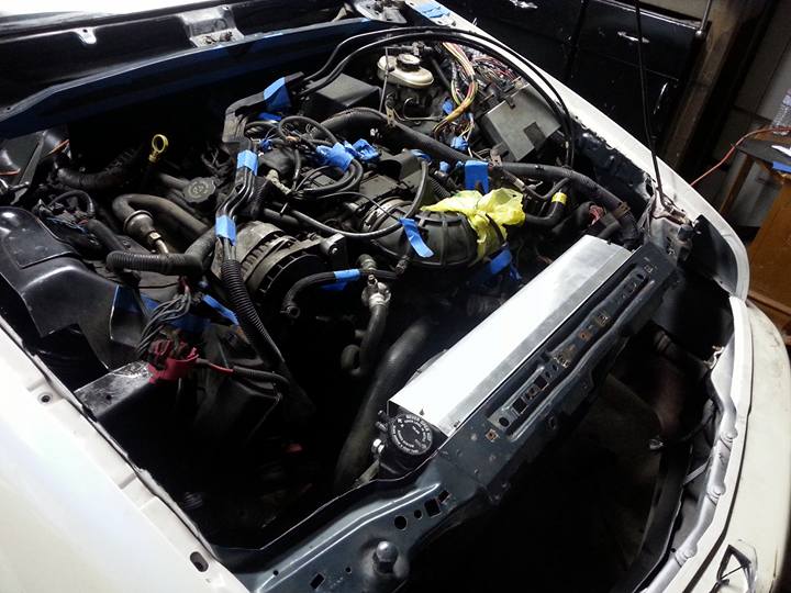

Post by jjanke »

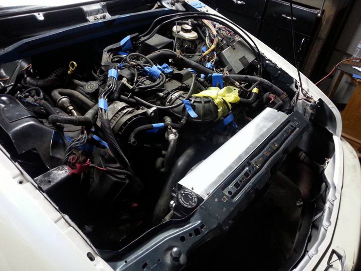

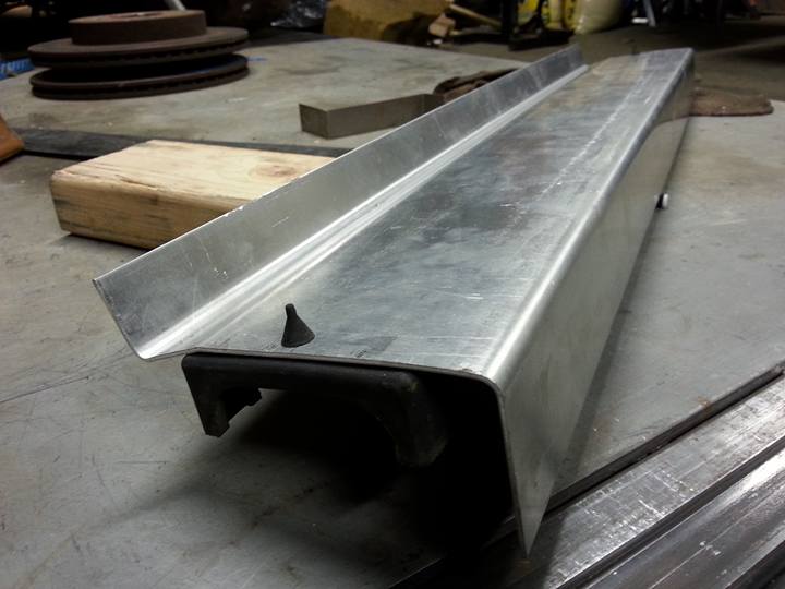

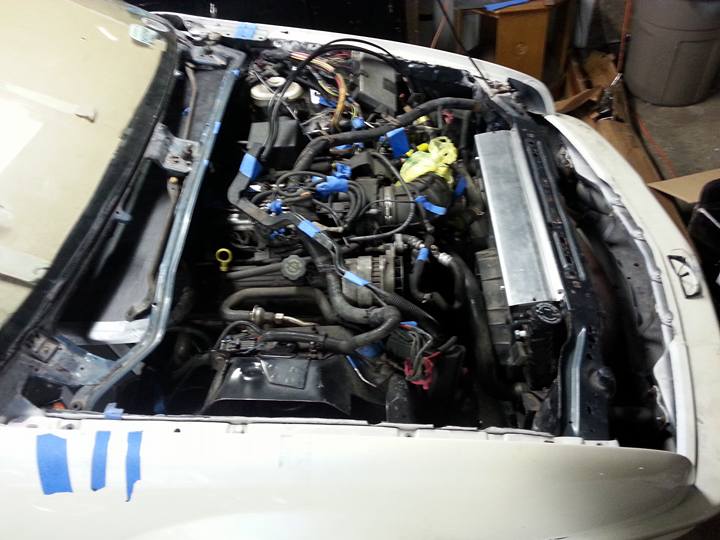

Finished the radiator shroud/bracket

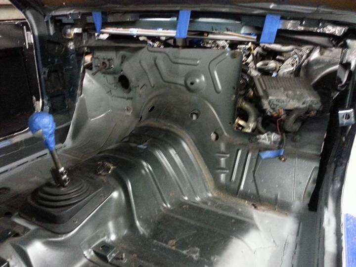

Re: Beretta Z28

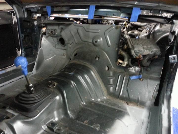

It looks like the footwell area is pushed back quite a bit. Using the deep Camaro dash I take it?

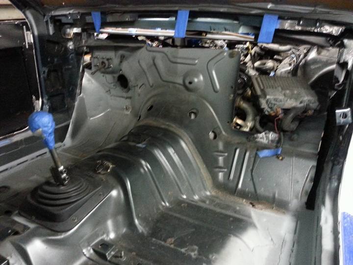

Post by jjanke »
..the camaro dash is just to wide.....im definitely gonna use the stock camaro gauge cluster.....and see if the beretta dash or chopped up camaro dash will be less work ....... or some kind of bent metal im thinkin might be the easiest

Post by jjanke »
I definitely need to re focus on the metal work and filling all the small gaps and patches in the fire wall and inner fenders and rear/trunk area......

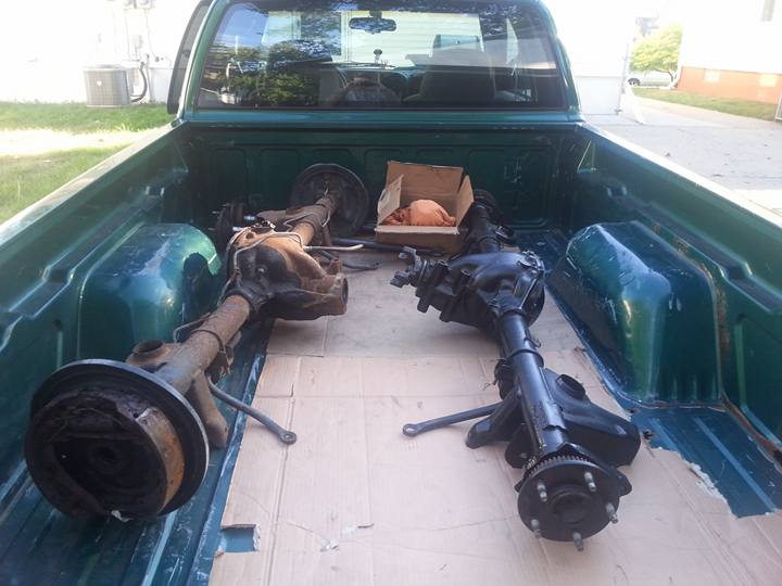

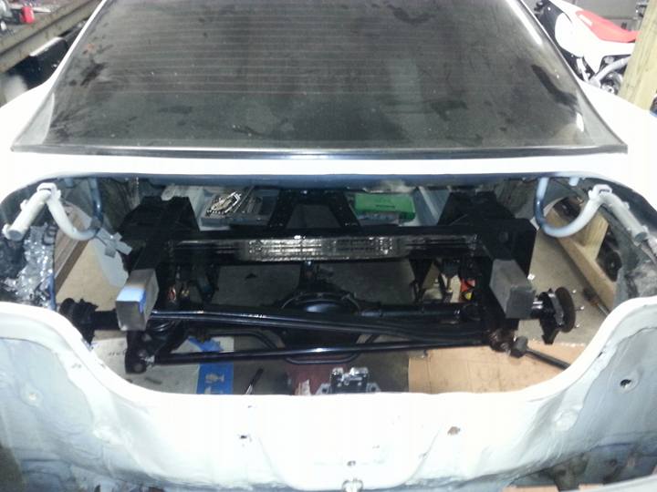

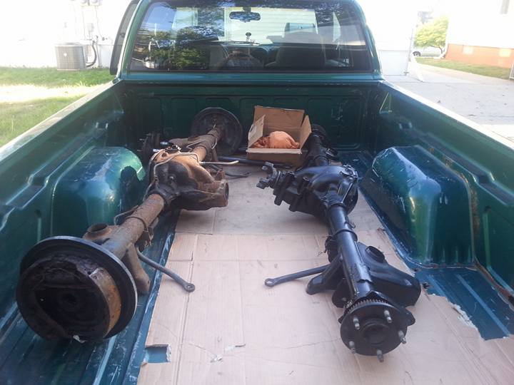

Post by jjanke »

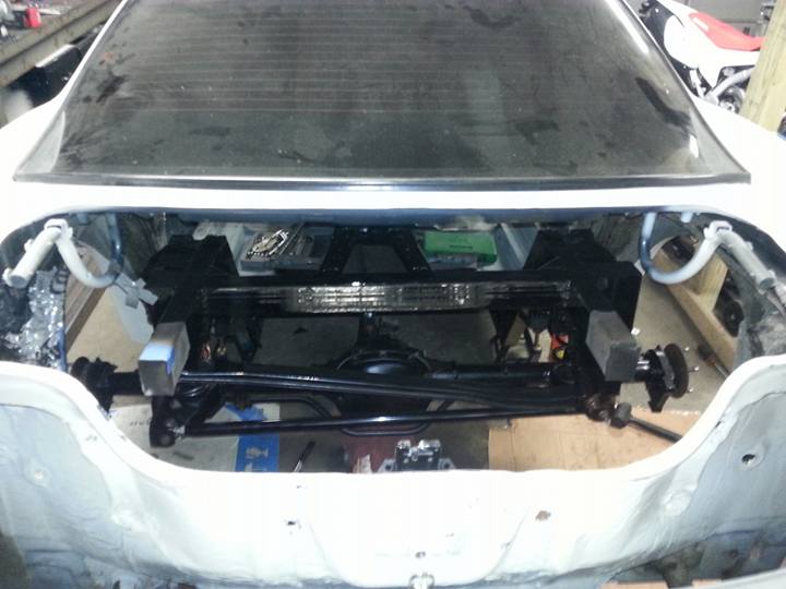

Got my rear differential back. Swapped in a 373 gear. And the open carrier from the 6cyl which now is welded. Also had to replace one of the axles due to the Bearing collar wearing into the axle shaft .also all new bearings seals and gaskets. Rear diff is back in full of fluid and ready to rock !!!!
