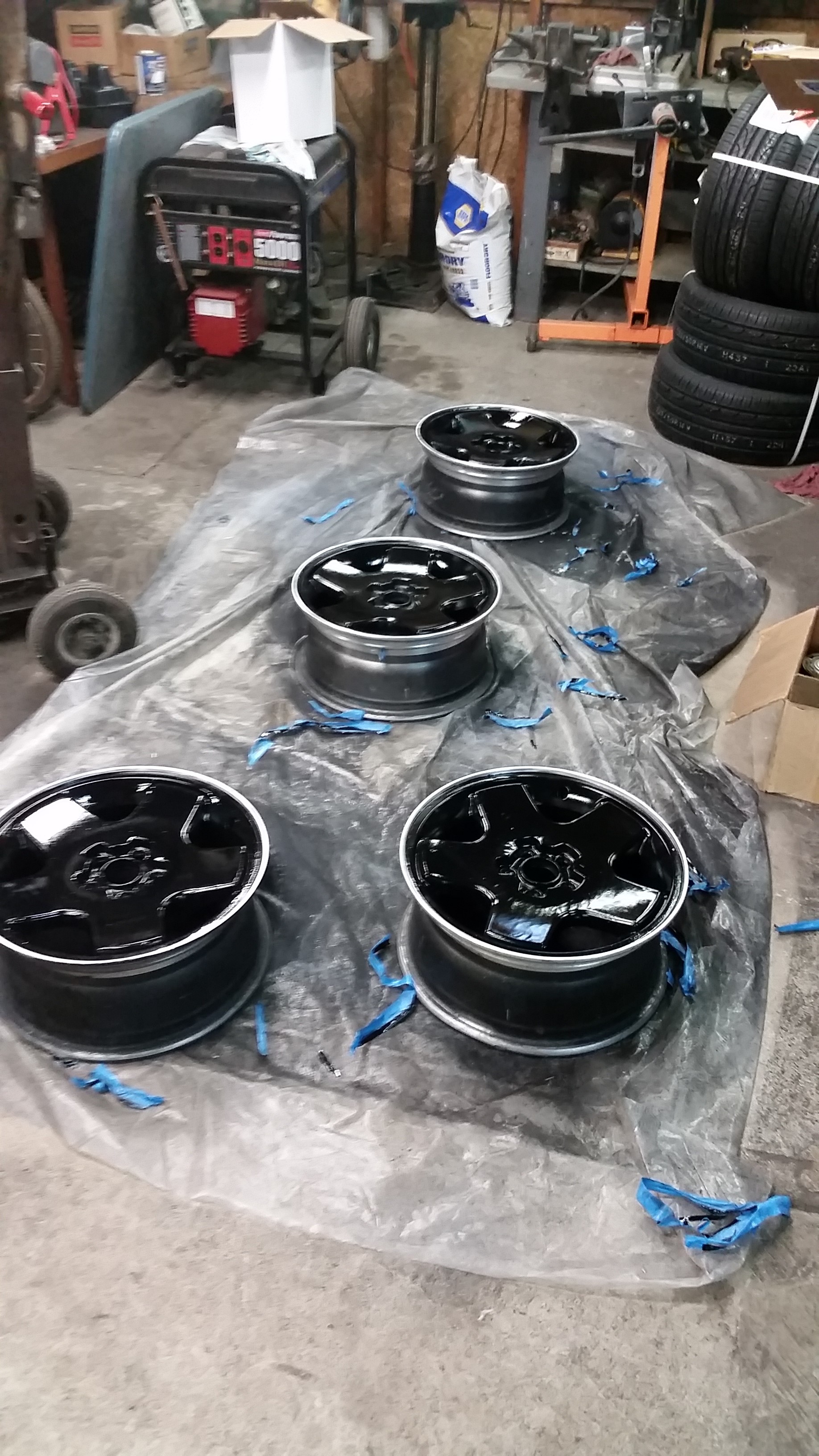

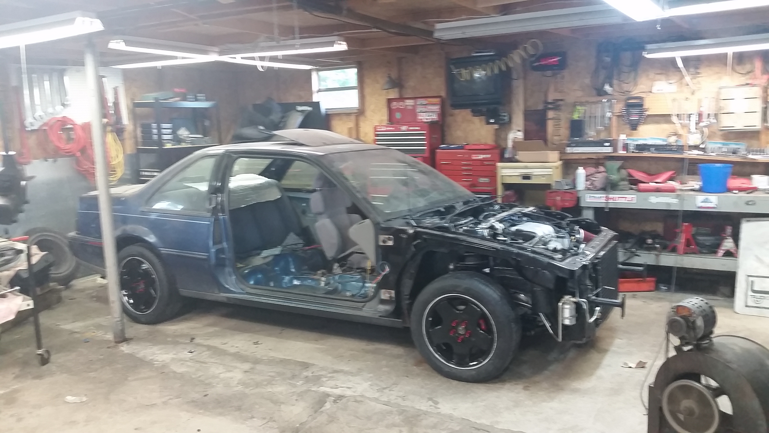

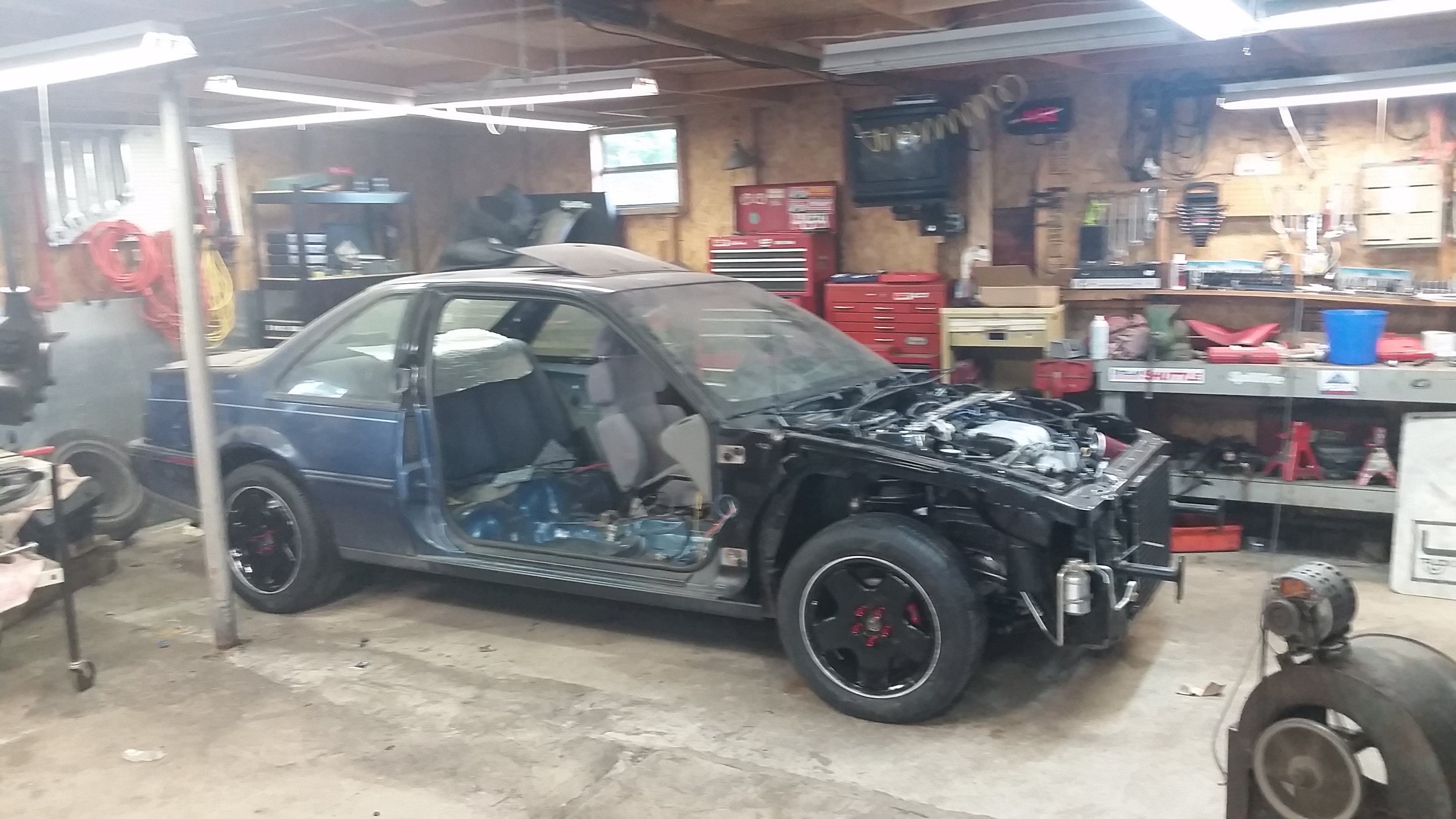

Project B has been on hold for awhile. But recently it has been getting a lot of work done to it. The engine bay is about 90 percent done. The inside is about 60. Suspension is done. I ended up putting in a sun roof and stripping the rims down and painting. As of right now I am cleaning the garage out so I can work on the car without being crammed. I was able to drive the car out on its own power a few weeks ago. I am having some idle problems and starting problems. I need to check my fuel pressure but my gauge broke working on another car.

Re: Project B - 1991 3400 OBII 5-Speed
I wish my engine bay would be half as clean

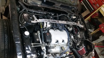

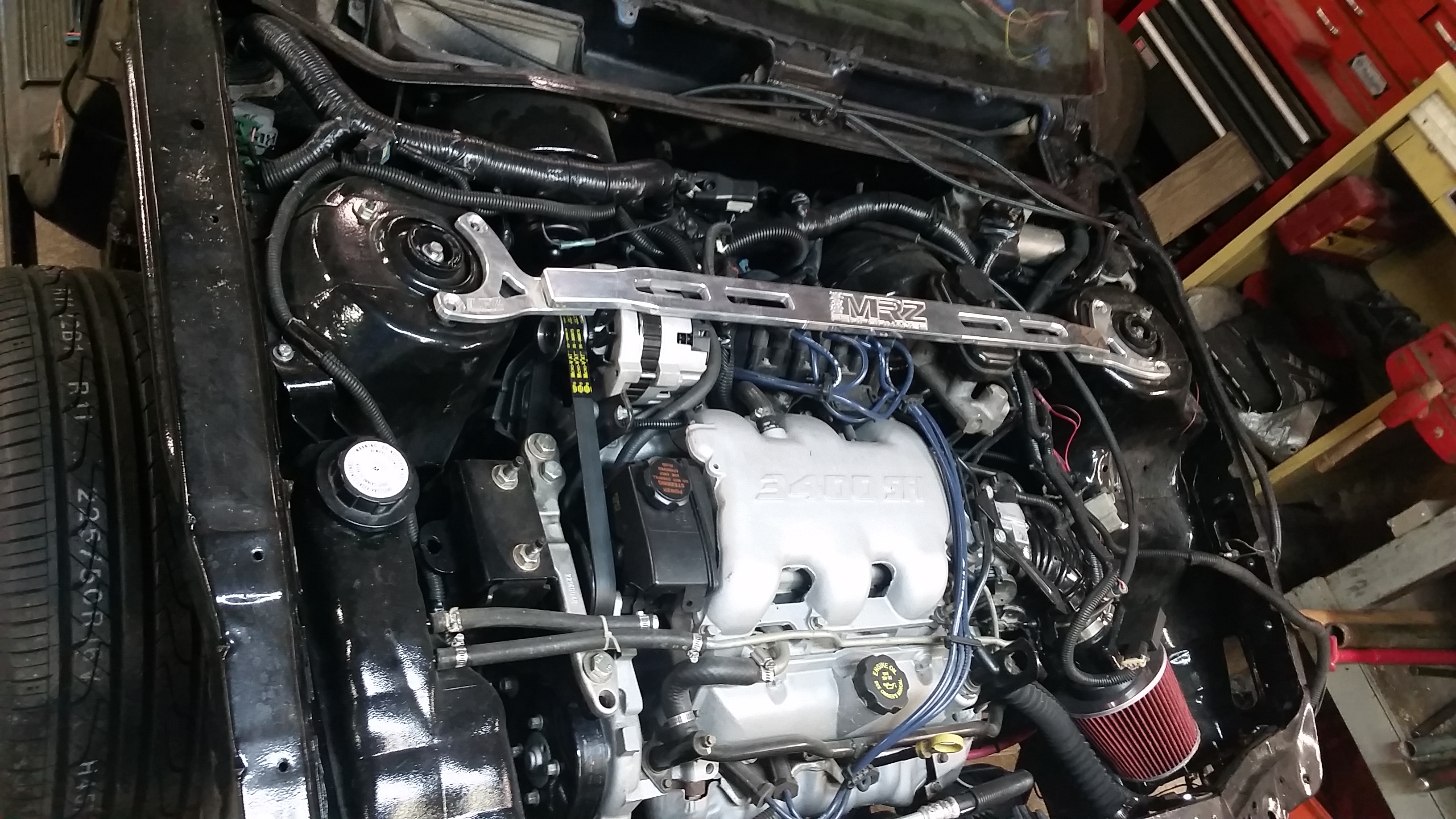

Damn good to see progress. Been following this for a long time. Nice photo of the engine, may be my eyes or it's not there. "It" would be the plug that is on the back of the upper intake(the front of the engine). The is a vacuum nipple there that must be plugged.

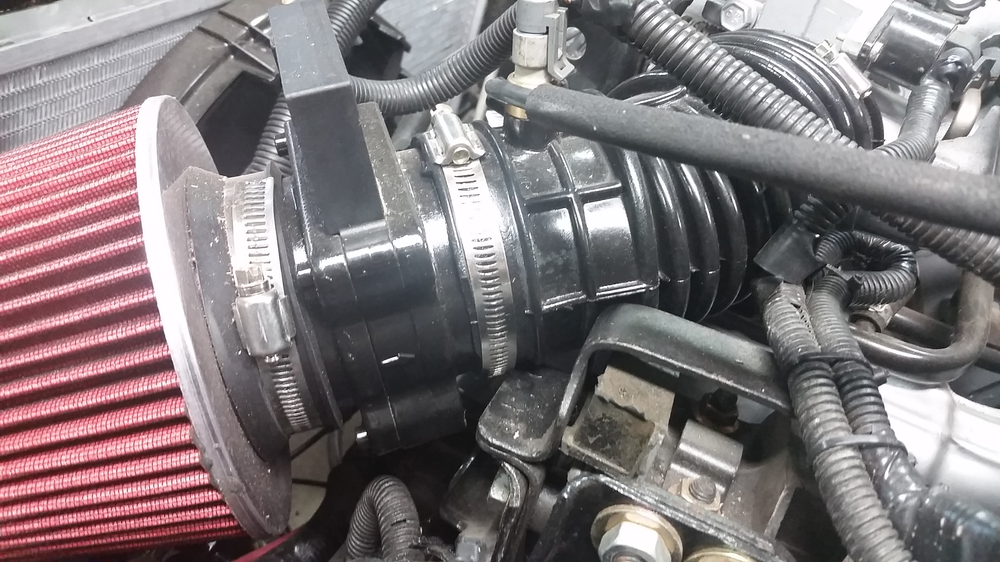

I trust you.....still have to ask if the MAF is facing the right way.
Looks backwards.Money pit Beretta wrote: I trust you.....still have to ask if the MAF is facing the right way.
There should be an arrow to indicate air flow on the MAF's center plastic section.

Money pit Beretta I think your talking about the port next to the alternator. That is plugged. I happened to be at the garage when I saw these post working on a DHP logging problem and I jumped out of the car and checked out the arrow.... Looks correct.
LOL that's great! Right place at the right time. Had to check on the port(just something that could be missed). MAF is right and so was I on the trust.Luckymc420 wrote:Money pit Beretta I think your talking about the port next to the alternator. That is plugged. I happened to be at the garage when I saw these post working on a DHP logging problem and I jumped out of the car and checked out the arrow.... Looks correct.
Not to nit pick, but it looks like the rear clamp on the MAF is a bit off center and the intake tube could be moved closer to the MAF. Thinking there could be a leak there. Bet it's not leaking, but making sure everything is covered at this point is best.
