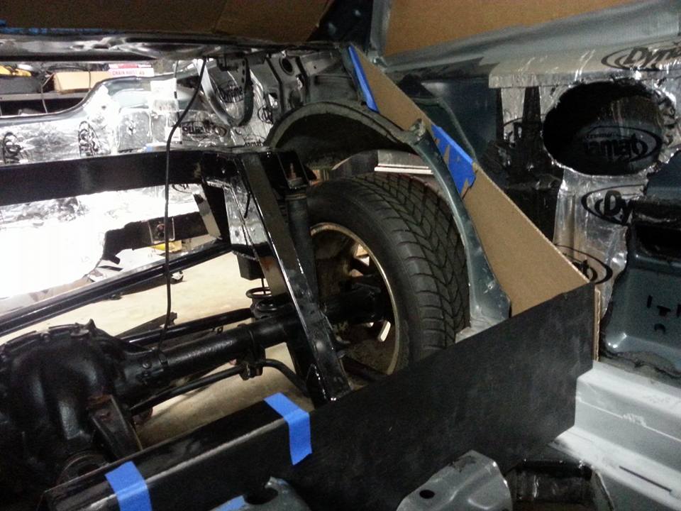

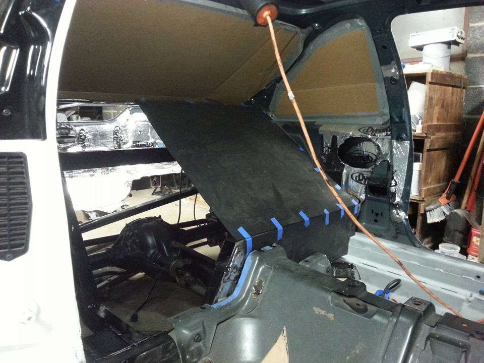

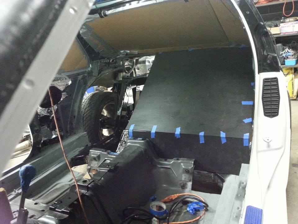

mocking up the rear firewall
Re: Beretta Z28
looks rad!

Re: Beretta Z28
Post by 90GTZHO »
Still think it would have been bitchin to have a back seat, but lovin the work! Still watching with much enthusiasm :-)

If you wanted to have more of a "back seat" look - instead of just a 45* angle of sheet metal - you might look into a prefab metal trailer fender and plug in more sheet metal from there:
http://www.etrailer.com/Trailer-Fenders ... 32-1R.html
Fairly cheap - and I think would require a lot less rolling/bending metal into a tub shape.
Or there are prefab wheel tubs out there - since you've got a hybrid car - might not work too well. Plus they are more expensive.
http://martzchassis.net/camaro/camaro-wheel-tub-sets/
jjanke
Posts: 425
Re: Beretta Z28
Post by jjanke »
I will definitely look into those trailer fenders maybe just to protect from rock throw on the inner wheel well.......i still have the "back seat" but with the cage I figured it would be pointless to put back there .....plus it was pretty chewed up from when I cut it out and had some rust spots too.......maybe I will take another look at it
Posts: 677
Location: Charlotte, NC
Re: Beretta Z28
Post by bonecrrusher »
Not sure how much room you will have - but you also incorporate some storage bins back there from a late 80's RX7:
