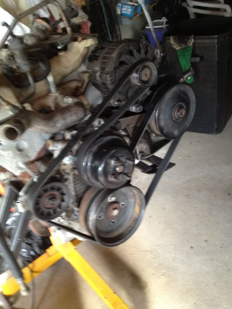

What way do these engines spin if your looking at the crank balancer? CW? I need to be careful of where I mount my spring loaded tensioner... Wrong side of the crank pully and it will slack under load wont it?
DTMAce
Posts: 3510
Location: Michigan EUP
Re: Project: Slideways z26
Post by DTMAce »
Clockwise. Pretty certain on that too. The alternator on the standard setup always spins the same direction as the crank.. Smooth pulleys spin CCW.

DTMAce wrote:Clockwise. Pretty certain on that too. The alternator on the standard setup always spins the same direction as the crank.. Smooth pulleys spin CCW.
Correct, and I think I understand what your confusion is... I believe the best place for a tensioner is just before the crank pulley but even on the other side, it should still experience the same forces though, thats why its spring loaded... I can't find any info online stressing either side, but if you look at a lot of stock setups they are either just before the crank pulley on the left, OR one accessory before the crank on the left.

Think of OHC and DOHC motors. The tensioner for the timing belt/chain is always on the side that is slack when the engine is running.
So say the tensioner creates 100lb tension in the belt, and the tension put into the belt by the balancer accelerating the accessories is also 100. That would mean the section between the crank and the p/s pump would have 200lbs of tension when the side between the balancer and the waterpump is 100.
As tension increases the belt wants to follow the straightest path possible. With a tensioner on the right side will cause slack under acceleration im 90% sure.

Which is why you find the tensioner to the left of the crank on the belt's exit path from it. I would agree with you on having it on the right would be a mistake. So try to keep it as close to the exit as you can.

Well, this weekend was a fail. Ended up working on other peoples crap all weekend, motorcycles, dirtbikes, lawn mowers.
I did build a sweet tensioner however. Honda v6 tensioner with a ford mustang v6 pully is a great combo for rwd berettas. Need to finish making some spacers and brackets and the belt system is done.
This is not a spring tensioner, its a bolt type for simplicity.

Made a tensioner from a v6 accord and a ford mustang. Gotta finish a few odds and ends and the accessory system will be done. Turns out that it uses a stock beretta 3x00 belt too, convenient.

Why don't you come off the crank, go around the water pump then over to the PS pump and then alternator? I think the crank belt wrap is way more critical than the others... and currently you don't have much there.

Oh yeah... the beretta.... I finished the belt system minus one small bracket. Thats it.
