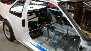

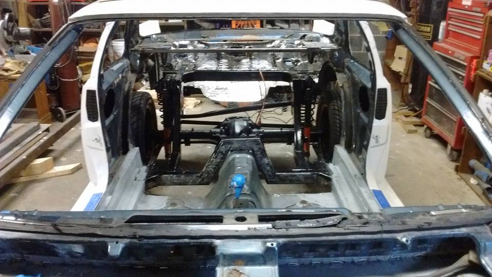

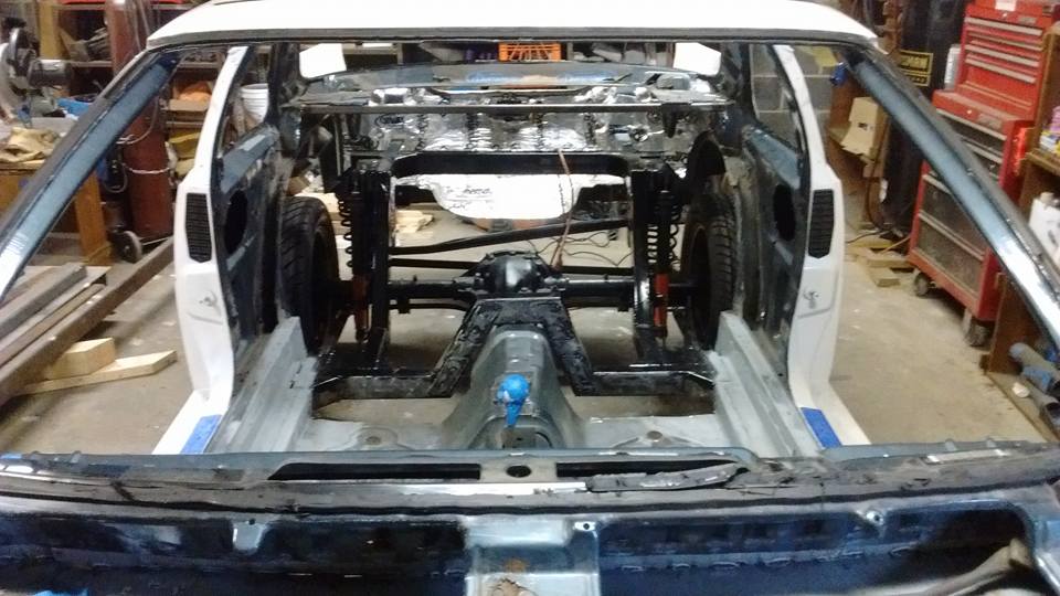

Had all the glass pulled so I can get the interior sheet metal work underway

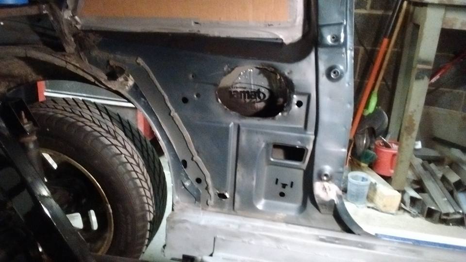

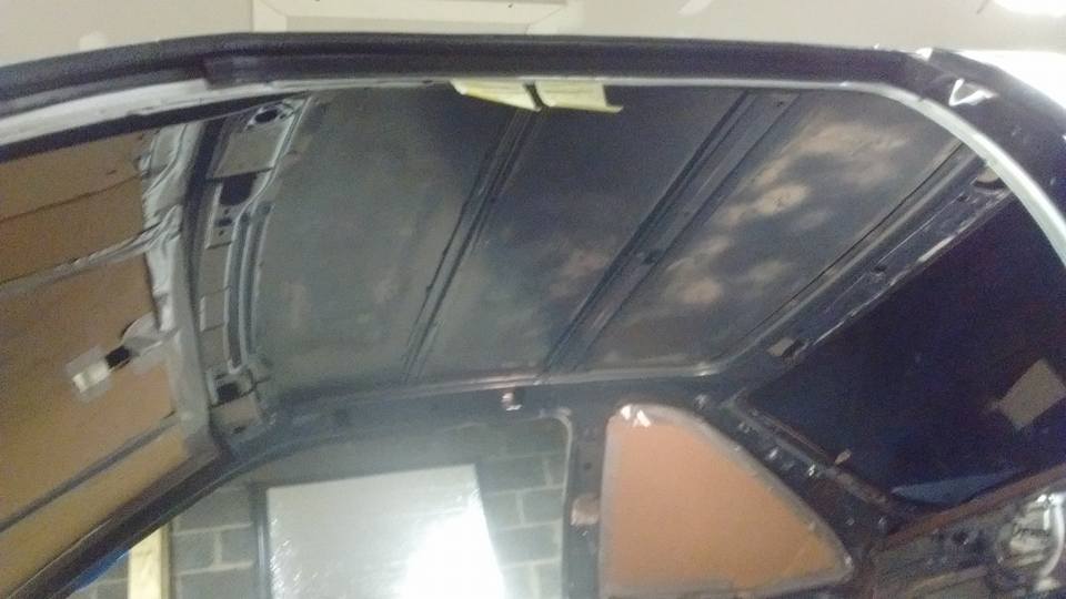

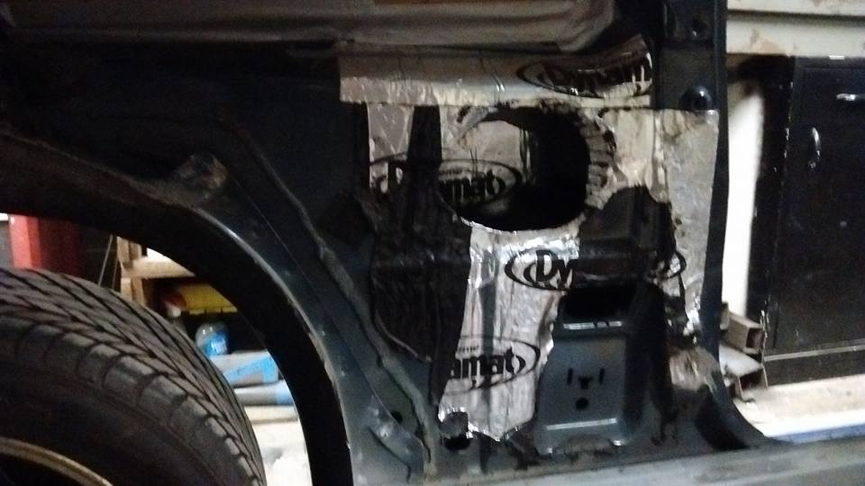

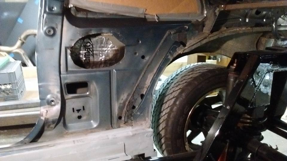

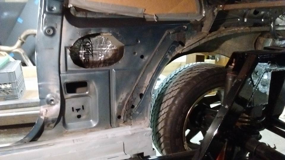

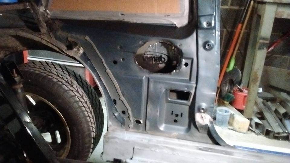

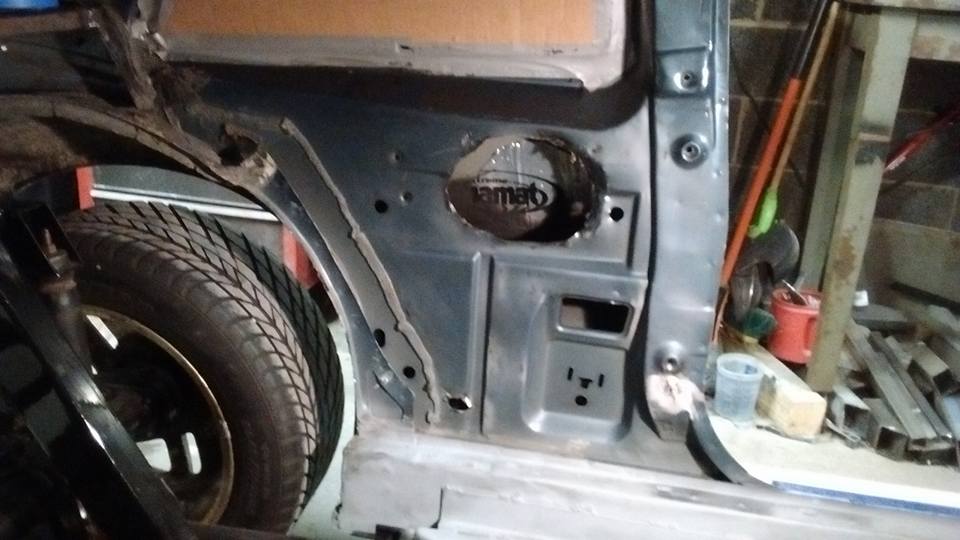

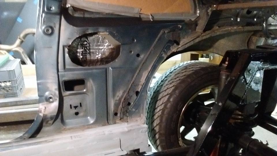

Not the most exciting progress update .....but removed the dynamat from the interior of the quarters, roof, and rear speaker package in prep for rear fire wall stuff.....and for eventual interior cage and paint......had to get it out now before cage and fire wall are in the way.

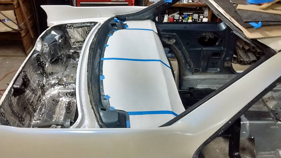

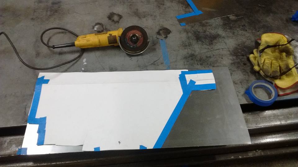

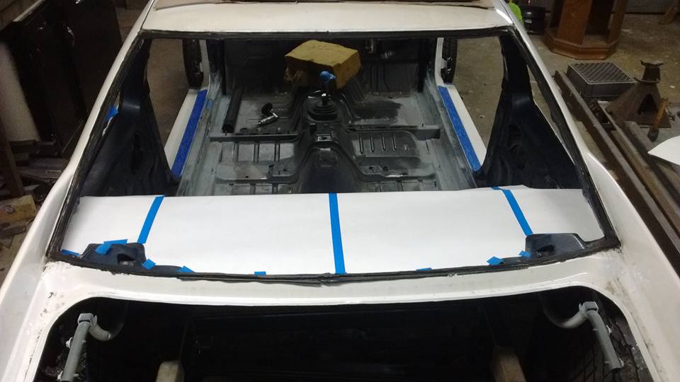

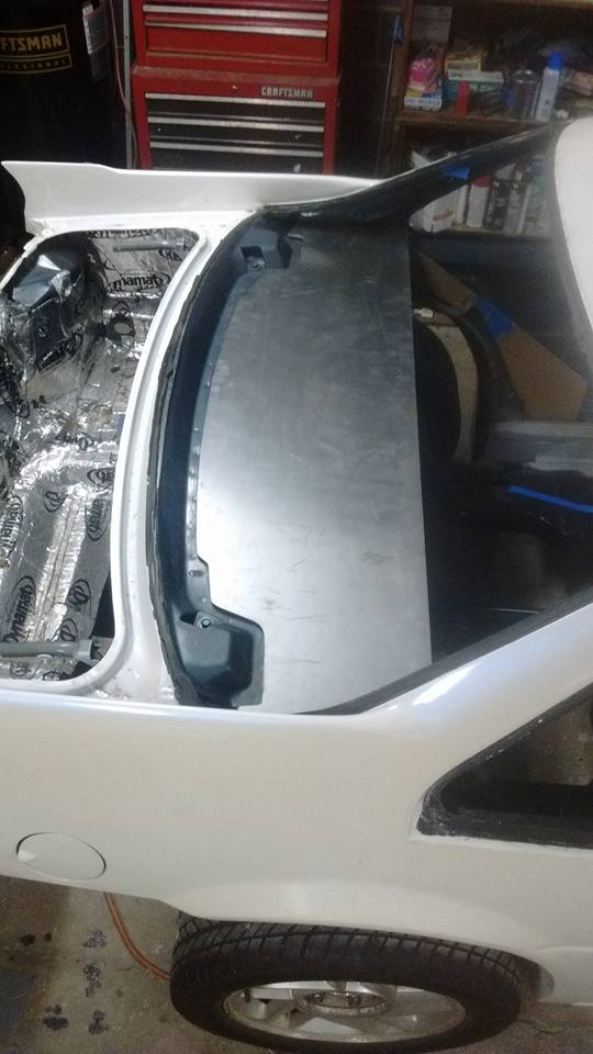

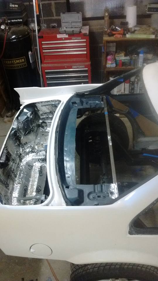

Made the final template for the new rear speaker package tray and mocked up the cross bar for where I want the leading edge of the rear fire wall to be

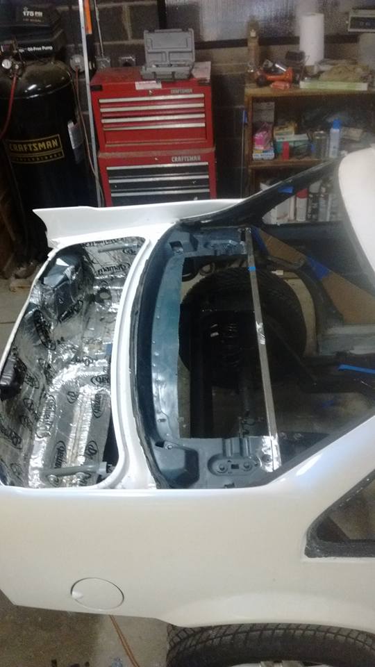

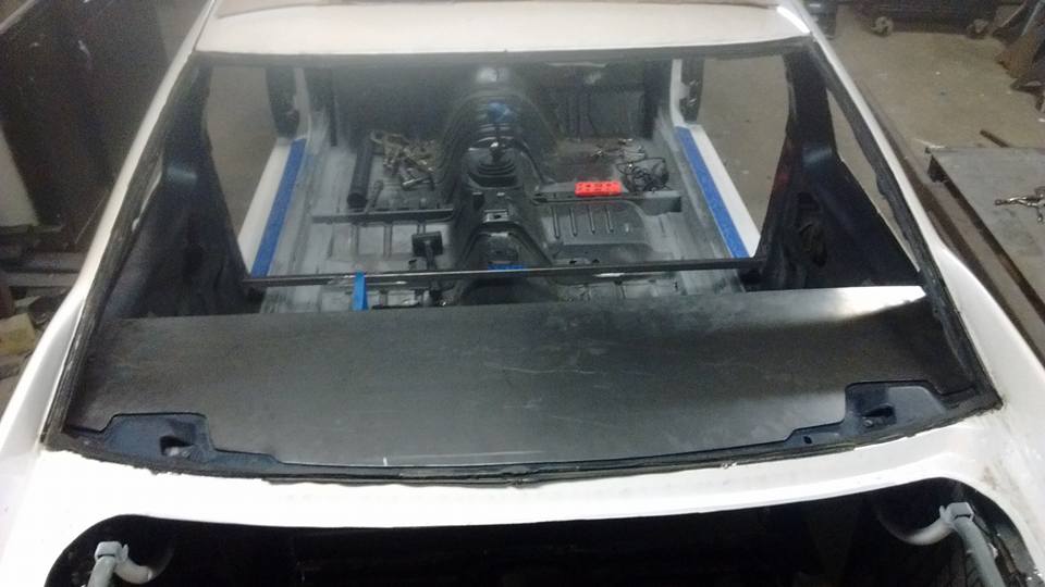

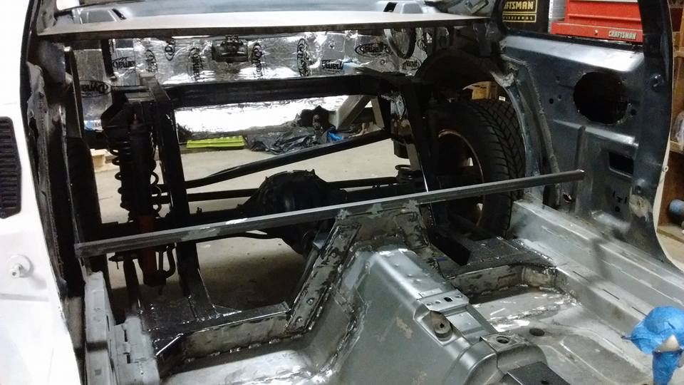

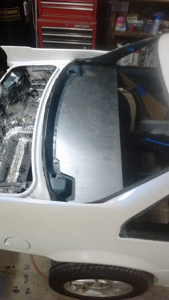

Welded what was left of the factory speaker package tray (where the trunk hinges bolt to) to the 1 by cross brace to support them and fitted the new speaker package tray filler panel.
Re: Beretta Z28
Very well done!

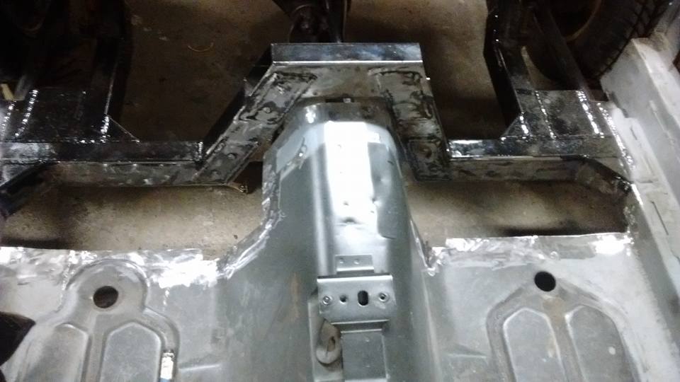

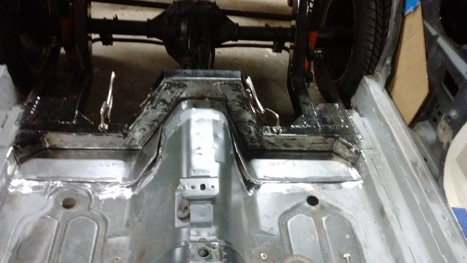

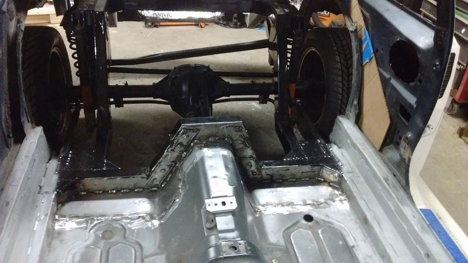

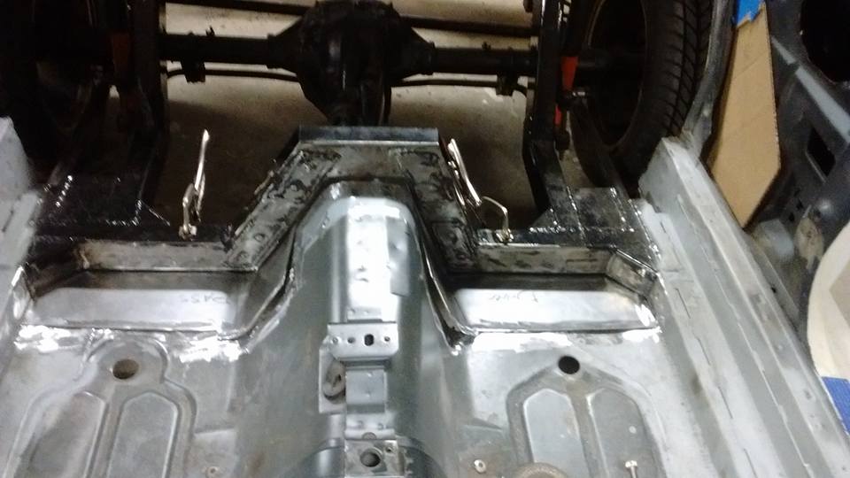

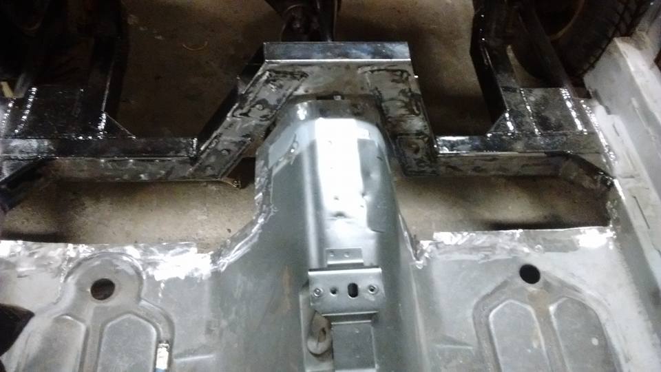

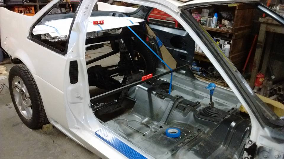

Just more patch work. Stitch welded in the missing section of floor pan

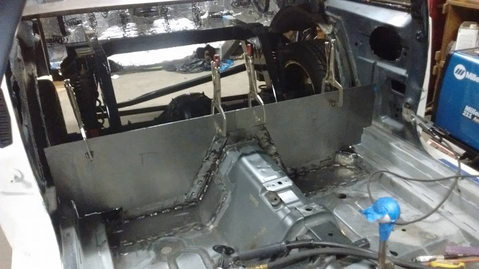

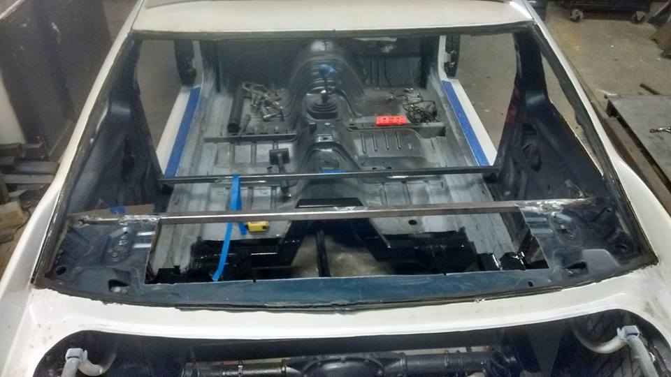

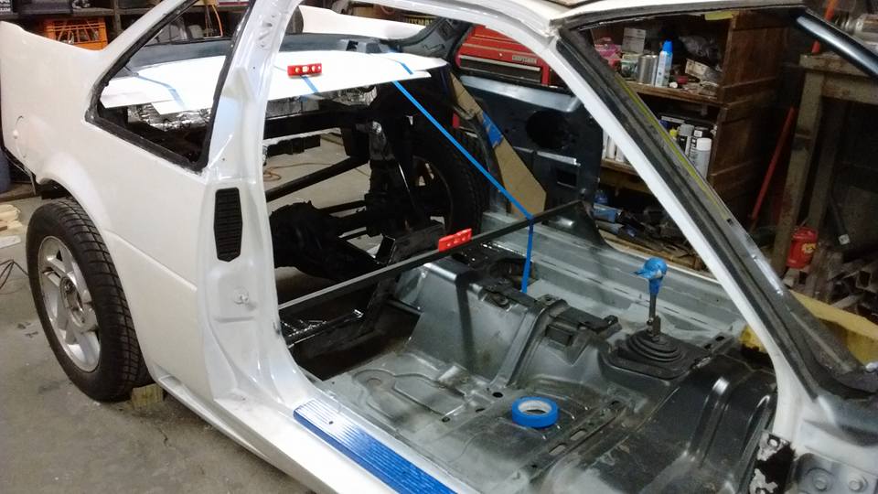

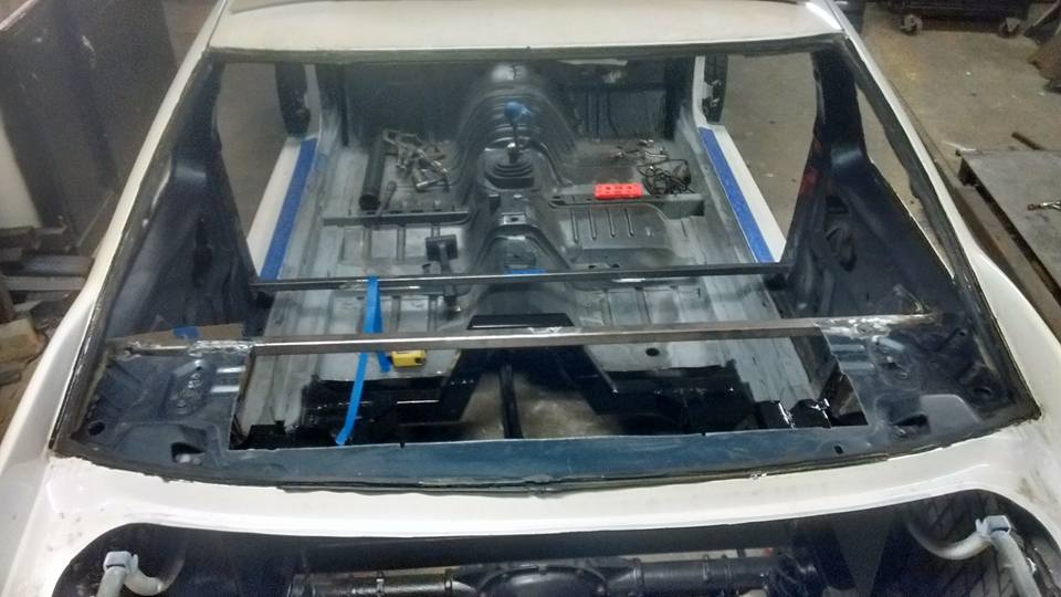

more work on the rear firewall. Cross brace welded in and front panel mocked up
