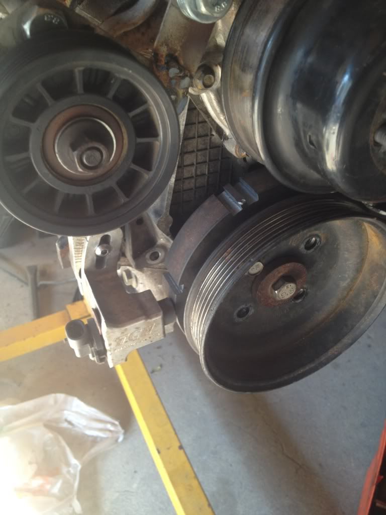

Progress finally.
Belt system finally complete with al brackets and crap. Works awesome.

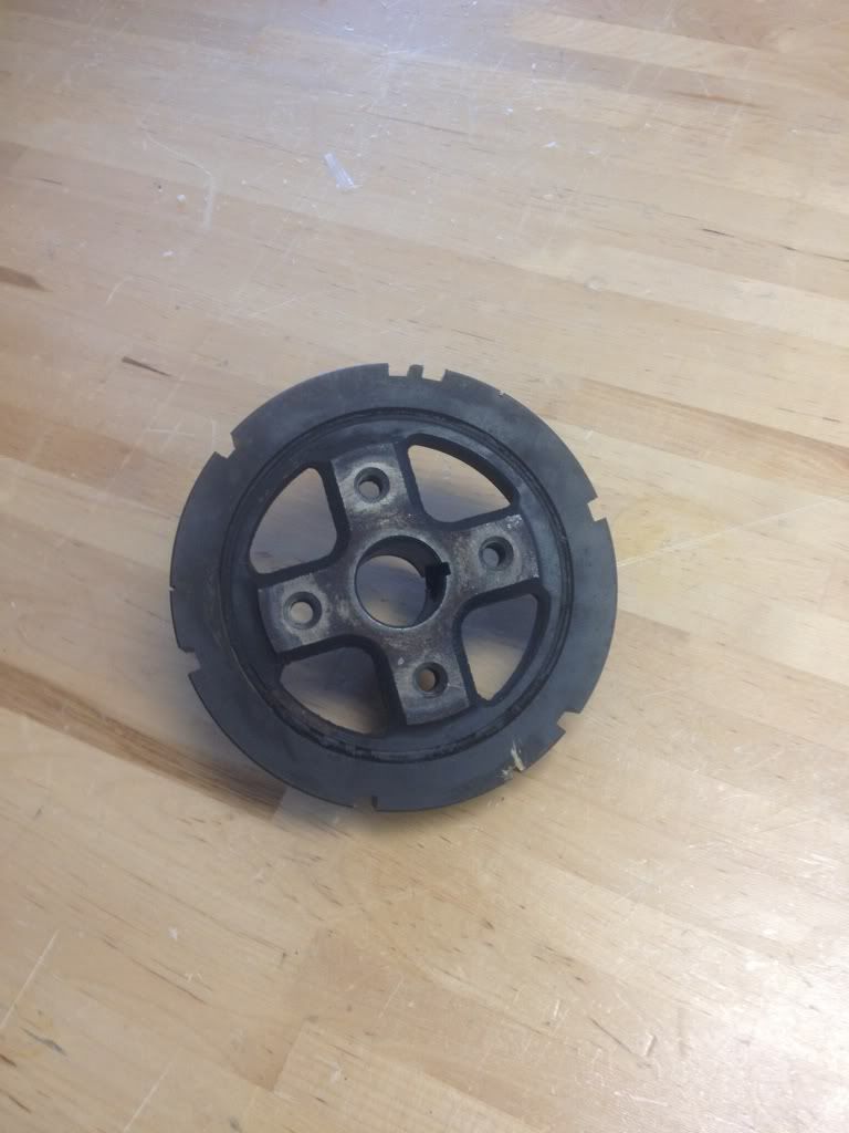

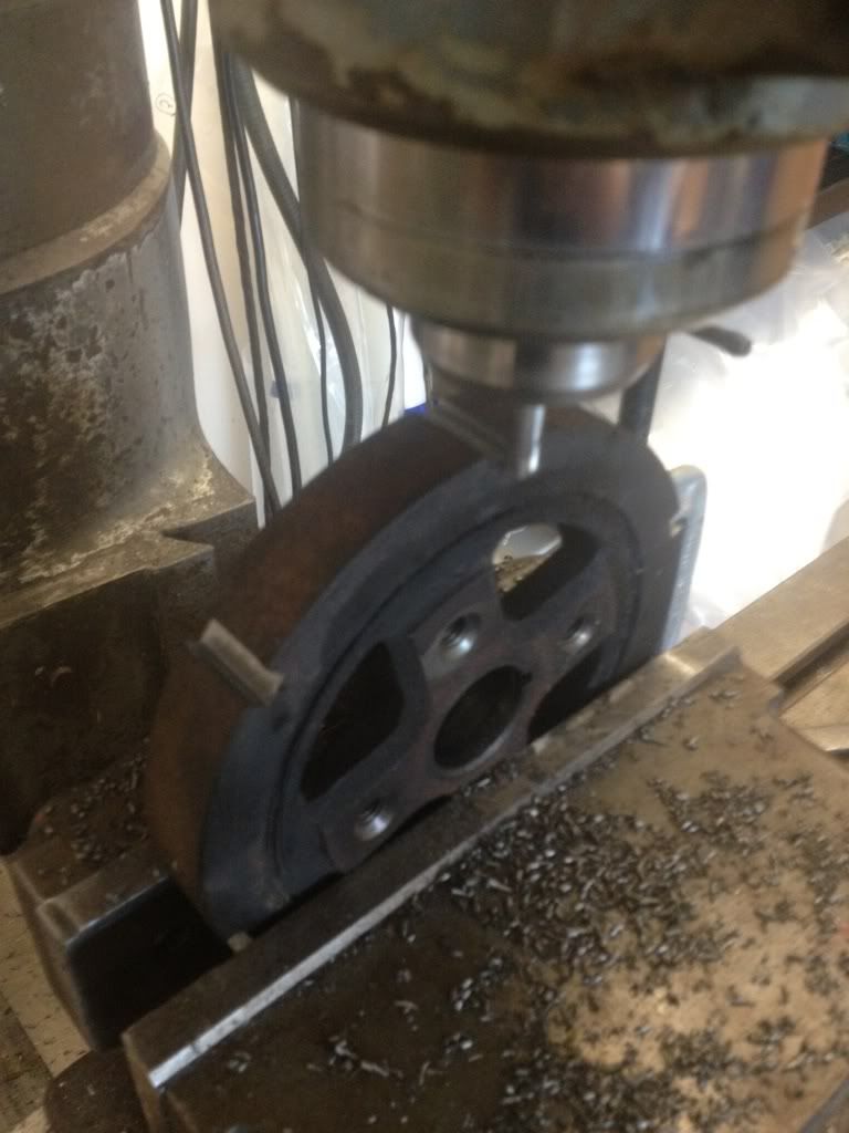

Poor man RWD crank sensor. Cut notches right into it so I didnt have to mess with cutting my TCE trigger wheel. I need to weld over the stock timing marks on it to eliminate the possibility of a false trigger between some of the real ones.
Cool beans.

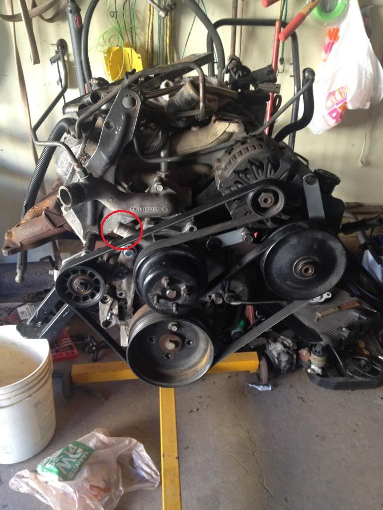

Sooooo would it be okay if I block off that hole next to the thermostat that used to feed the heatercore? Its useless now.

And yeah you can block that hole just add a bleeder in it to be able to fully purge the system thats what cahilj did when he did away with his heater core.
Or you can loop some hose from the water pump outlet boss to that?

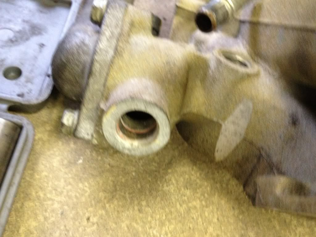

So I can plug this hole:

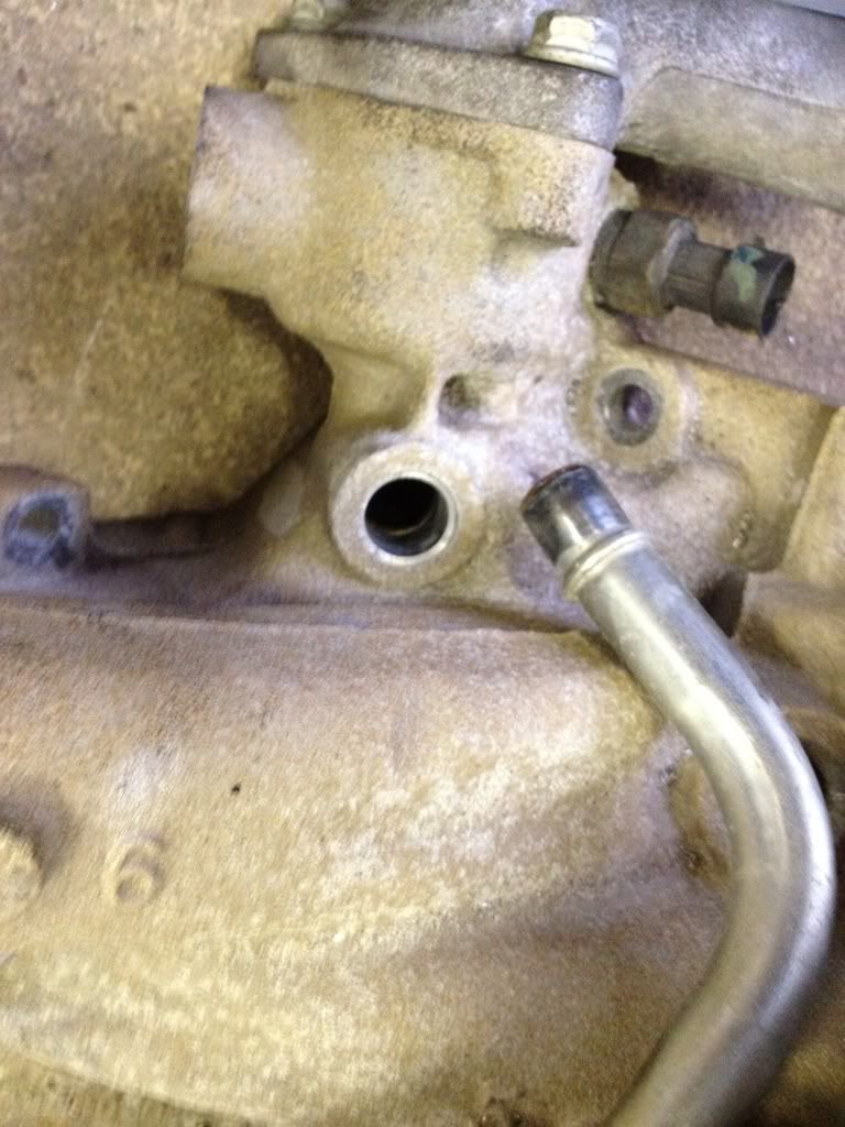

And this hole?

http://i97.photobucket.com/albums/l216/ ... G_6763.jpg This one im not sure on but the other two you can either loop together with hose since the one off the water pump feed the heater core and the one on the lim took the water back in iirc. or weld what ever just make sure you have a way to bleed the system.

I'm going to tap and plug them with pipe taps. The top one is 3/8 and the side one is 1/2. I just hope none of these are critical to the coolant flow of the engine.
Re: Project: Slideways z26
The pipe that goes over the intake may be critical to coolant flow since its a thermostat bypass... without that the coolant will not flow when the thermostat is closed to my knowledge...
You may not be able to re-use that port but you might have to figure out a way to allow coolant to flow when the t-stat is closed.... not sure how they did that with the 2.8's unless they just used the Heater core as that loop, where ours has two loops, one for the heater core and one for the TS bypass.
