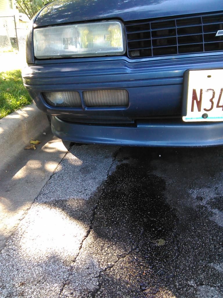

The struggle is real...my car decided to dump out all of its power steering fluid this morning. I haven't had the time to see exactly where it's coming from but it's a big one.
Re: Chevy Beretta FF
You were work on the Cavy and the Beretta saw that. A guess would be the low pressure line.
Once you get that fixed(here we go again) don't forget to bleed the pump. They will burn the bearing quick if you don't.

After filling my reservoir and following the the leak to the culprit, I found out that my power steering tank was shot and spewing my expensive power steering fluid all over like there's no tomorrow.

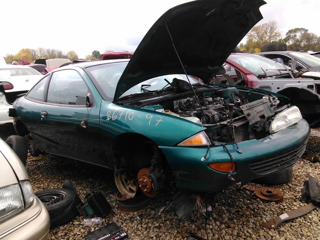

So I go get myself a new one. By new, I mean pulling crap from my local junkyard. Out of courtesy, I'm posting a pic of the donor car. I've harvested so many parts from this Cavalier for my Beretta, it's just the gift that keeps on giving.

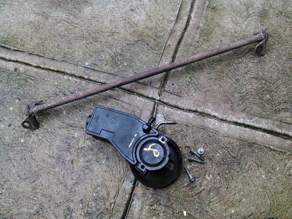

So I pull the power steering pump/reservoir and as an added bonus, I pulled an internal rear sway bar from a '94 Z26. I have yet to know if this will fit directly to my revised '95 suspension with little to no fuss but figured I had nothing to lose. Just figured since they both share the triangle shape torsion beam in back, the only difference being mine has holes cut out from the revision that it could work. Whatever, it's a thing for a later day. This plus my ADDCO should be perfect.

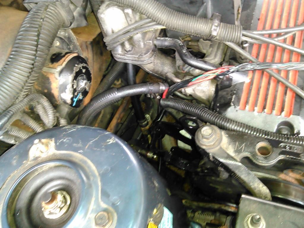

Gaping hole from where I pulled my pump off the car:

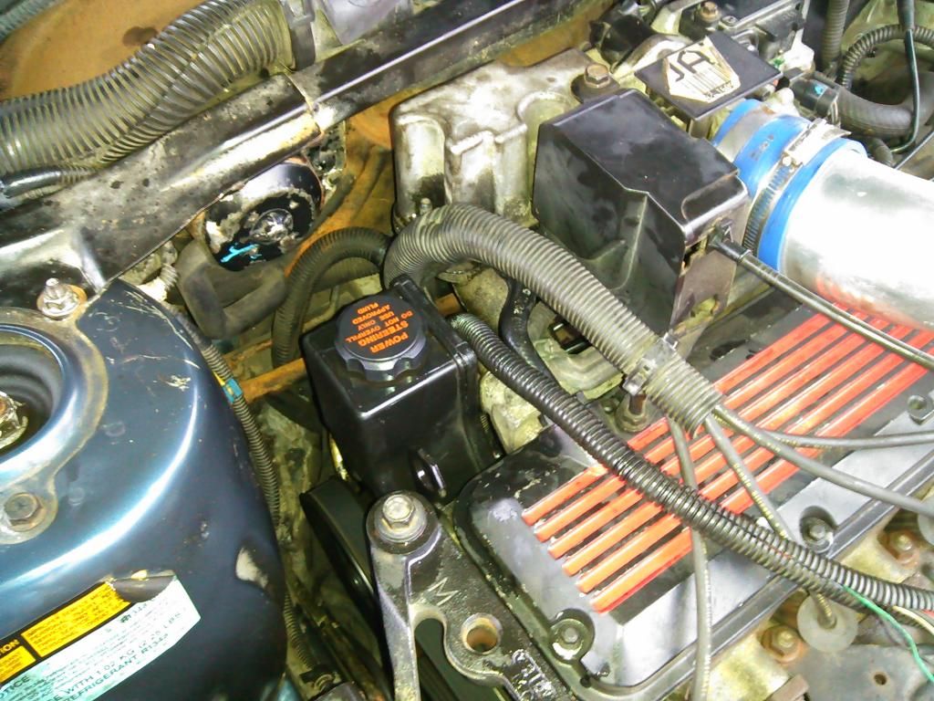

annnnd newish pump all ready to go:
Rear bar may not fit... IIRC on 95-96 it was changed to a welded bar because the holes to mount it are not there anymore as well as the rear beam has weight saving holes drilled through it. But you may be able to drill holes to line up with that bar, just not sure space is there.
Oh yeah, I got the bar knowing that fact but I figured it wouldn't hurt to see if there was metal I can drill into to mount it when I tried to line it up back there. Worst case scenario, I sell the bar to some needing Beretta enthusiast for cheap. Nothing ventured, nothing gained?
