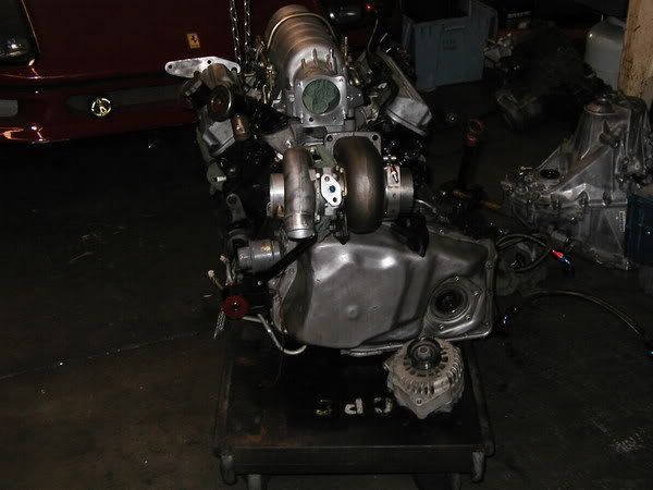

Life blood of turbo and engine..."tee'd" the oil pressure sender
Will be using AN fittings...old hoses are visting the trash...

Final engine mount...Chris West helped box the dogbone, I must have been making an @ss of myself trying to fabricate a ghetto mount...lol!!!
Made a bracket for the ignition module (aluminum piece)...
Kay that all for now...

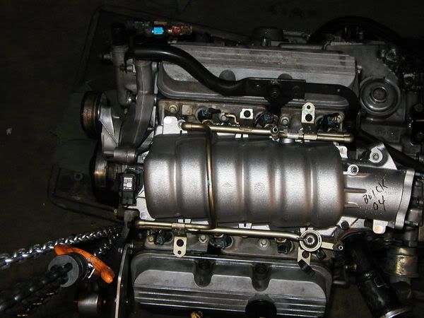

Ok to continue my soliloquy
...I received my injectors and had them balanced locally...just to make sure!! I am still contemplating if to change fuel pump...it has been a while...I use a corvette Fp. The injectors are 36lb injectors eight (8) of them. 2 are auxillaries and will probably be used somehow...my plan ultimately is to run a max of 14psi nothing more...for now I will keep boost 'lowkey' and see how the engine responds to little increments...
I am also debating what MAF to run and how to run it blow-thru or suck-thru...
they are 3", 3.5" non--ported and 3.5" ported...I also have a 4" (no pic)...I want to really run a bigger MAF because of the MAF recalibrator, the bigger the MAF the slower the air velocity and hence the larger the injector I can potentially run (up to point at least) however my piping will be 21/4" onthe cold side...jumping to 3" or 4" will look like @ss...
I have a reprogrammed PCM however I absolutely do not trust the tune for fuel and timing several thousand miles away. I opted for a rev-limiter engagement at 6K RPM, no speed limiter, different shift, ability to read 2-bar, EGR delete and purge delete...that is it. Dependent on how things go, I might end up buying the DIY reprogrammer.
