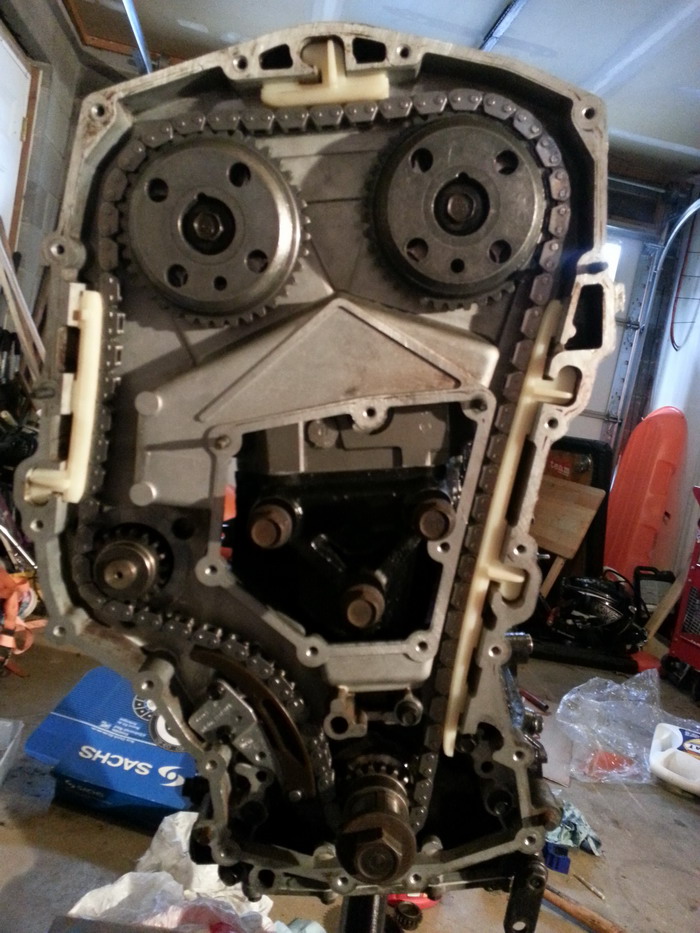

Well, waiting on more parts. I have been getting everything together and am waiting to do the final assembly on the engine.
Hopefully my timing chain set will be here before the weekend, along with some specialty Quad4 tools.
I was able to have some parts, including the intake manifold and blower housing sandblasted and refinished. Before the engine goes in, I'll be resealing the couple of small leak points in the engine bay.
Ugh, I really REALLY R_E_A_L_L_Y and looking forward to getting this engine back together and in the car. I've spent WAY too much with this Quad4 rebuild, but it'll all be worth it in the end. I just really want to get behind the wheel. I've had the car now for almost 2 months and have yet to spend more than 30 minutes total in the driver's seat (and that was sitting in it admiring it!).

It took ALL WEEKEND (first time reassembling a Quad, had to make sense of the pile of bolts as well... BUT - It's all back together now. I still need to install the water pump, but aside from that, it's READY TO REINSTALL!
It is nice to see this pile of parts getting smaller as I get things together.
Re: Finally - A BERETTA OWNER ONCE MORE! :)
More progress this weekend; I had to take the timing cover back off and retime the engine; I was one tooth off. I spent Saturday doing that, getting the water pump put on, and I pulled the engine cradle out. Gave it a coat of paint and called it a night.
Today, I tackled a few things that were still left to do in the engine bay and got the flywheel, clutch and trans bolted up. I got the engine/trans mostly installed - Apparently my main pass side mount is warped (or not the right one?) because even when I took them both off the car and engine, the bolt holes were like 1/4" from where they needed to be. VERY irritating.
But, oh well, I'll have to fab something to make it fit.
