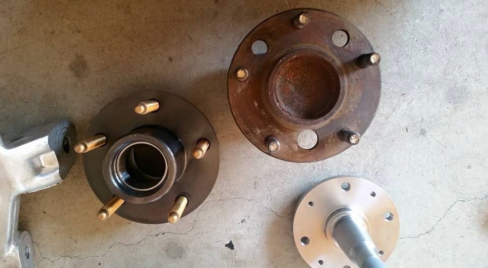

coleman racing hubs/spindles came today!
the bad.......... my wheels have a big enough bore for the oem c4 hubs, the coleman hubs are the same diameter. The issue is the coleman hubs are longer, the bore in the hub on the wheels has a "cap" I guess you could say. On the face its smaller than the hub so the center cap fits.. that needs to be machined off the wheel... if that makes sense. I shoud have grabbed a pic. basically bore the center of the wheels out due to a lip on the face. Its gonna happen..

small update, I got the wheels back from the machine shop and ended up buying the rest of my rotors and had them all redrilled.
no the spindle is not bolted on correctly, I just tossed a bolt in so I could see what it all looks like
fix one problem, find another!! with the new spindles, due to them being round, it hits the caliper bracket. Ill just grind the spindle down a little bit. Not a huge deal
progress should start to pick up again in the next week or so

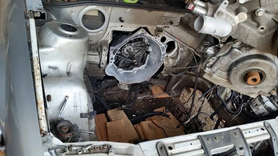

got a little more done, still juggling a few projects at once.
the hole!
needs to be refined but it will work for now till I know where the engine/trans will sit exactly.
notice the pedals.. it will all work out in the end. not a huge deal.
yeah... the t56 is really that big! I thought it was small till I put the belhousing on... its just sitting on the floor, the tail will go down for sure, I hope the whole thing ends up going down! well see what the suspension allows..

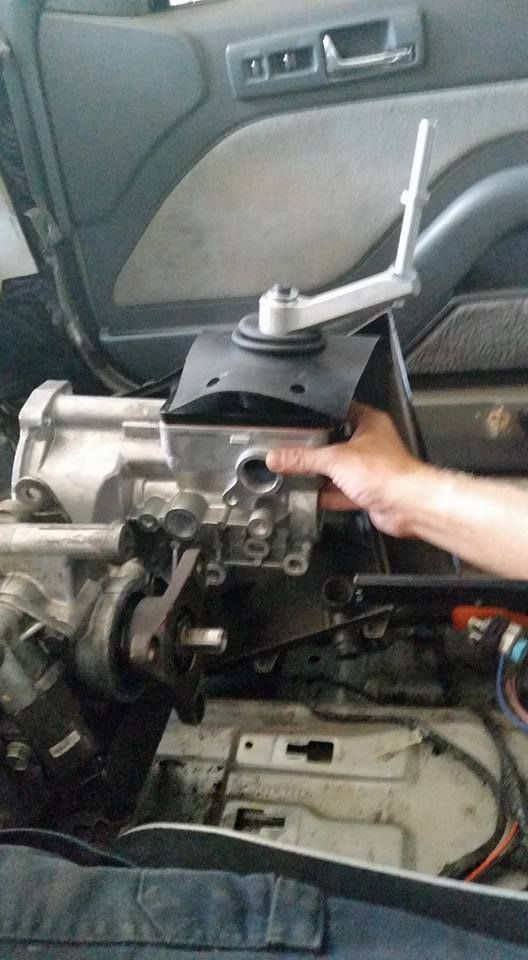

note the stock shifter location (written in sharpie).
ctsv tail housing on the trans, I have the parts for the GTO conversion. pictured is the GTO tail housing with a short shifter.. it sits too far back. the Fbody shifter is 2"? shorter.. (no kickback). I may have to go that route. and or move everything back in the car. pedals, steering wheel, seat, dash, ebrake. all very doable just not sure what route to take yet. Im going to try and spend half a day on it monday
the hole!
86 Subi - Supercharged @7psi

If you turn that shifter 180* it will likely be pretty close to where you want it.

I never thought about spinning the shifter around, that could actually work i think! I'll give it a shot once the location is a little more set in stone. Thanks for the idea!
