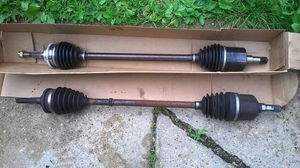

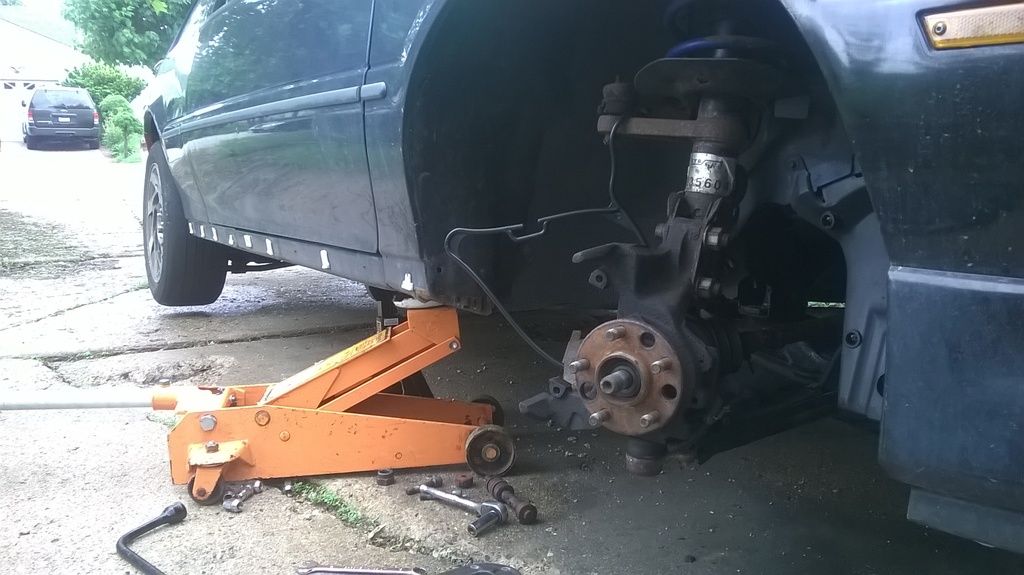

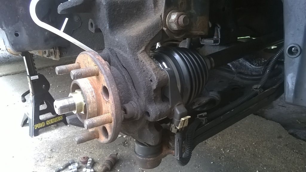

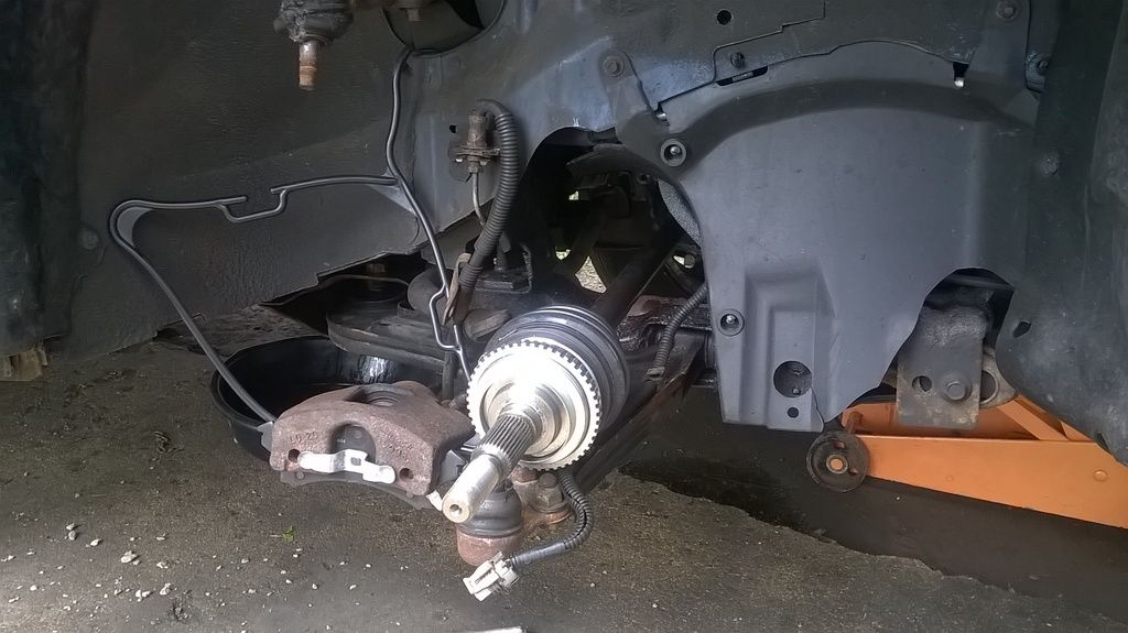

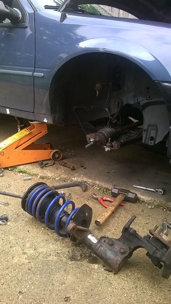

So I'm tackling the car to do list: first and foremost I had to change out the passenger side half shaft. the cv axle boot fastener gave out awhile back spewing precious grease everywhere and adding some accelerated wear and tear before I finally noticed. I just found it cheaper and easier to buy a new (not remanufactured) halfshaft and plop it in. All it took was 2 hours and 3 beers.
You can see how stiff the rear is as the wheel lifts readily when jacked up

old vs new, notice my lazy ziptie until I replaced it:
coming along nicely

All done!
coming along nicely

All done!

If it helps you later in the future; you dont need to remove the strut assembly.
Pop the bj, unbolt brake line from unibody, tap the axle out from hub & swing the knuckle away tying into position. its doable. Dont need to worry about an alignment afterwards. Save u some modification monies.

As long as he gets the upper bolts of the strut back in the same spot he probably doesn't need an alignment with the way he did it. Hell I had my whole front end out and I put it back together and it still tracks straight. I expect the toe to be off just a bit but I never separated the knuckle from the strut and that's where 90% of the adjustment happens.

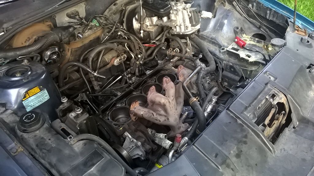

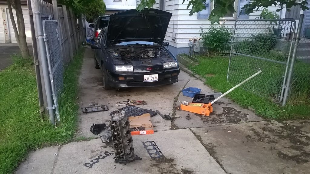

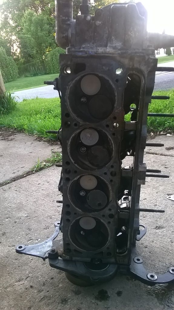

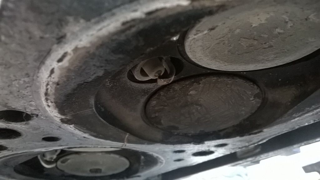

Well cracking the ol' girl open to remove the engine to ideally do a budget shortblock rebuild considering the timeframe.
My car does silly things like fusing the spark plug onto itself in one of my cylinder banks. Seriously, no gap at all. Way to go car.
My EGR is looking like it needs a good cleaning

Ever thought about indexing the plugs? Looks like that one took a hit. The two facing the intake look the best.
- Posts: 10915
Re: Chevy Beretta FF
I was going to say the same thing, but that one would be indexed correctly... electrode facing towards the center of the cylinder where the dish in the piston is... The other plug is facing near the edge of the cylinder and pointing the electrode down. I will say it looks like it hit something, Perhaps you bumped it while removing the head?

What gets me is the other plugs are clean, that one is a bit dirty. Seems to be something that happened not that long ago. Unless the others are new and that one was left in there for the photo. Those other ones are the cleanest damn plugs I've ever seen in an engine. More like they just came out of the box.

I'm just going with the benefit of the doubt that the spark plug crushed itself inadvertently during the head removal as there are really no signs otherwise to cause this carnage.I was going to say the same thing, but that one would be indexed correctly... electrode facing towards the center of the cylinder where the dish in the piston is... The other plug is facing near the edge of the cylinder and pointing the electrode down. I will say it looks like it hit something, Perhaps you bumped it while removing the head?

All the plugs are the same age, usually when I change them out, it's an all or nothing deal.What gets me is the other plugs are clean, that one is a bit dirty. Seems to be something that happened not that long ago. Unless the others are new and that one was left in there for the photo. Those other ones are the cleanest damn plugs I've ever seen in an engine. More like they just came out of the box.

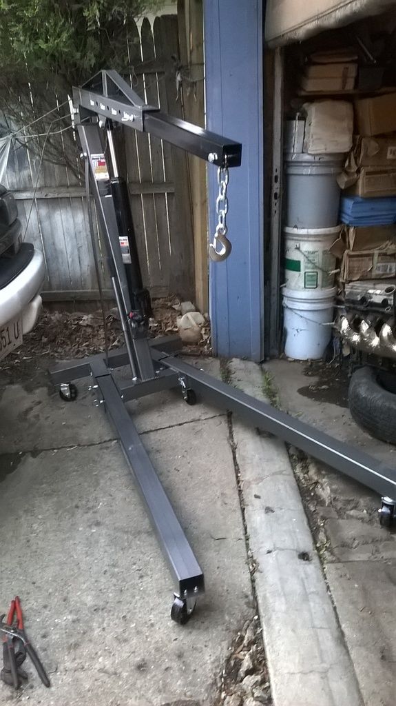

All that's left is to unhitch the transmission and undo the motor/tranny mounts and the engine is set to get yanked out. Work has been slow as I've been working and it's been rainy these past few days. I did make a milestone by buying a new, super cheap engine hoist from Harbor Freight. Now I had one before that I used to swap motors on an Olds intrigue and quickly sold it on craigslist.
Now the battle plan is there is no plan. Seriously. To rebuild the shortblock would require the work of professionals as I've never done it before nor do I have the proper tools and measuring equipment for the tight tolerances this would require. Parts alone is about $350+labor and any machine work. So I'd average that out to about $800 in all+a week to complete.
The other route is to acquire a low mileage long block from a salvage yard for about $500 with a presumable 30 day warranty.
