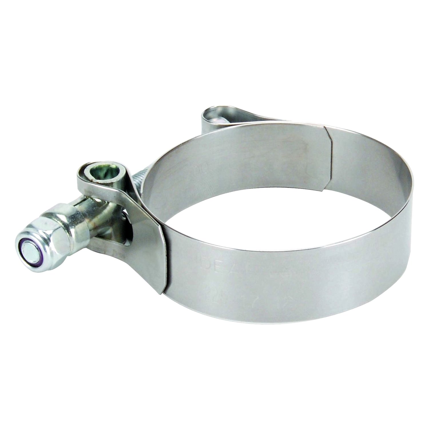

I feel like hose clamps aren't strong enough for that considering I've stripped them easily with a screw driver when changing radiator hoses. lol. Do they hold good?
I hope those are stainless steel.
whiteretta
Posts: 767
Location: New Carlisle, Ohio
Re: The Derretta, 1994 base with some attitude.
Post by whiteretta »
The 12338017 is the exact number it shows on their diagram, I'm sure it's stronger than your average parts store hose clamp. Another seller on eBay is selling sets of 5 for $9 shipped, so I ordered a pack, and will see how they work!
GT_Indy
Posts: 615
Post by GT_Indy »
whiteretta wrote:The 12338017 is the exact number it shows on their diagram, I'm sure it's stronger than your average parts store hose clamp. Another seller on eBay is selling sets of 5 for $9 shipped, so I ordered a pack, and will see how they work!
I hope they work out for you!
This is all I can think off for a stainless clamp that might be made stronger if those dont work:
Posts: 4768
Yeah, I've been using those t-bolt clamps on mine. I like them a lot better.
