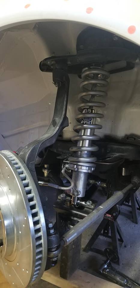

Felt great to get back to some stuff I had put too far on the back burner. Beretta progress!!!! Viking coilovers. Extended Spohn upper and lower tubular arms and extended tierods, shortened knuckles, flaming river power steering rack, power stop disc brakes

Some more trimming and cutting in the inner fender/wheel well= more steering angle
I'd say
this kit has some angle !!!!

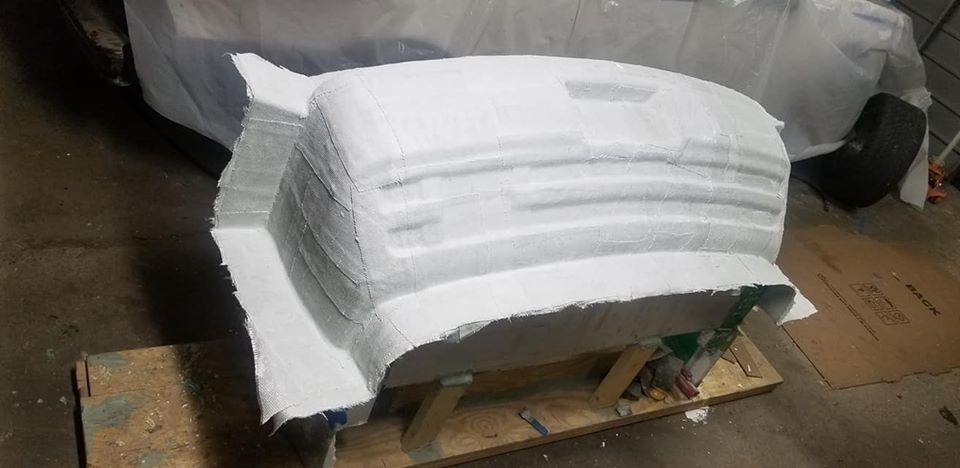

Made some progress on casting the rear bumper. Still need two more layers but ran out of laminating resin and cloth. Back to the store

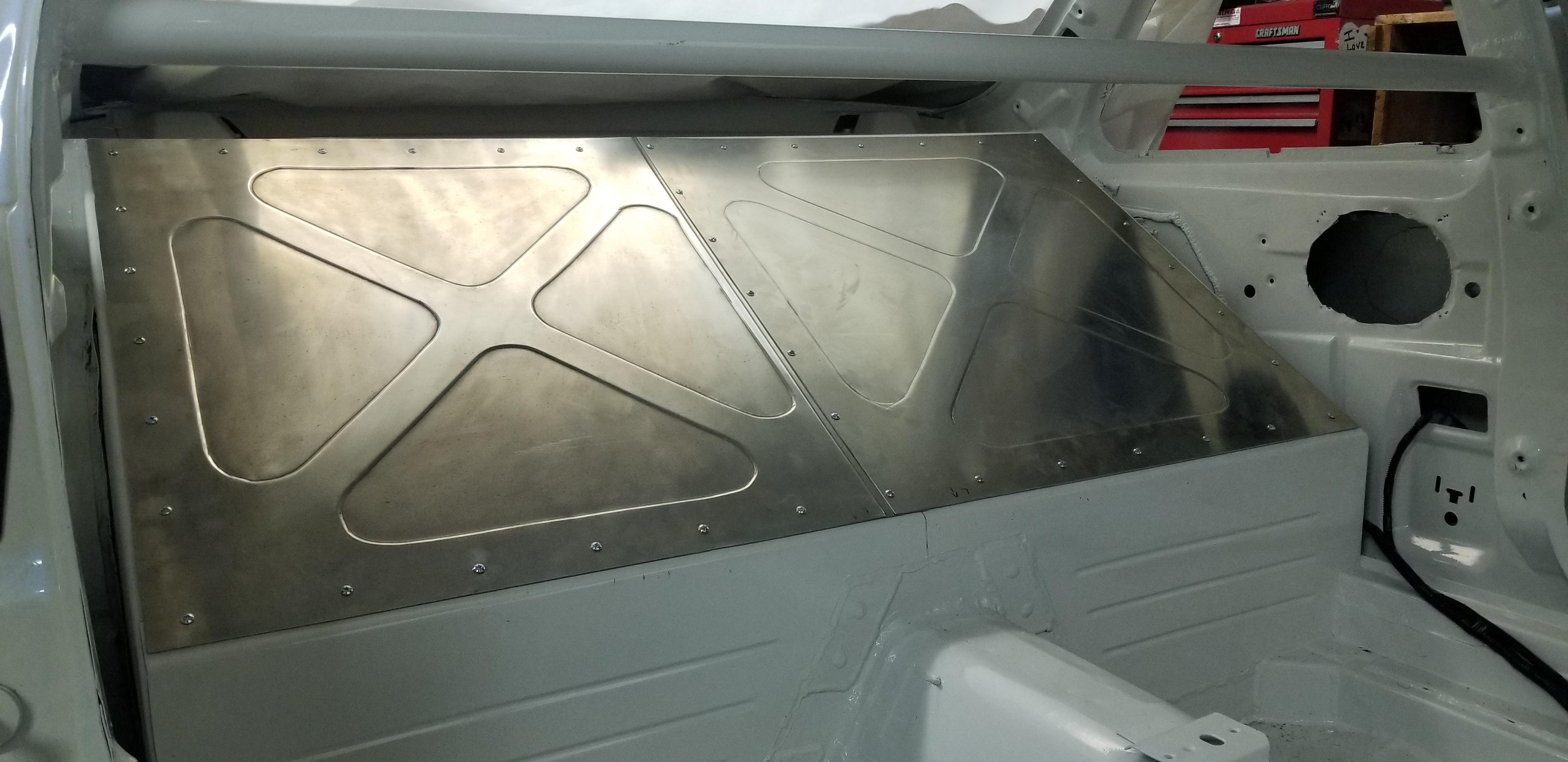

Finally got around to installing the new X rear firewall panels made out of thicker aluminum. Also installed rivnuts forball the fasteners on the rear firewall and door panels

Wow! Great progress, that is an impressive steering-angle, I am personally always laughing at GM's biggest failing in that department with the phrase 'turns like a Chevy' as I make a multi-point turn...
You won't be able to say that about your car!
Those aluminum panels look oh so clean in there... I can't believe how nice those door panels look.
