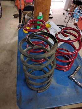

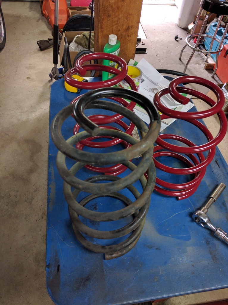

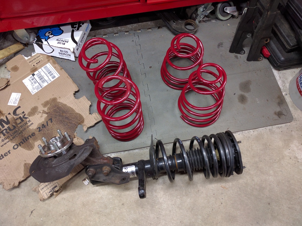

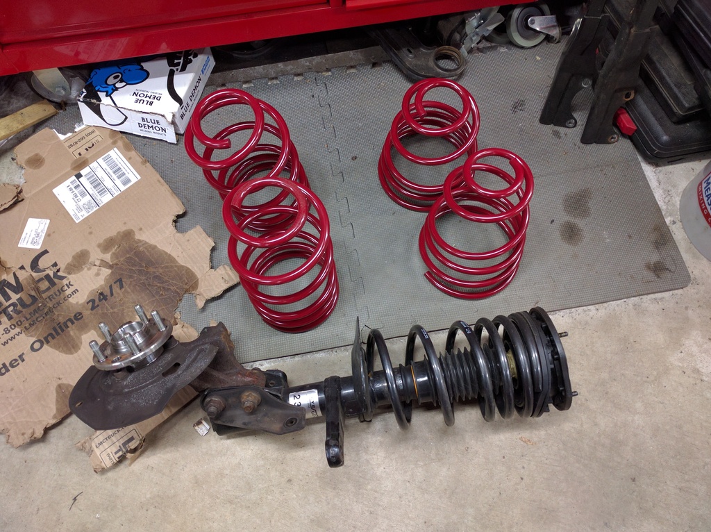

Also pulled apart struts to inspect tophats and try Canuck springs. The insulators have been sitting on top of Eibach springs for too long and have somewhat conformed to them so when attempting to fit the Canuck springs things didn't go smoothly and I didn't like how the spacer was fitting and the end angle of the upper mount when it was all assembled... It's going to take some more time and thought to get it to be right since looking at the Eibach vs the FE7 and Canuck spring the last top coil ends in a different spot... The 90's upper mount is designed to compensate for that, where the 95+ upper mount has a spacer to do the same but they are not equal. Maybe not right before Bfest I'll re-hash those out and see how the car sits. I also did a fat ass standing on the rear spring test and I can barely compress a FE7 rear... but I can really compress a Canuck rear. That was another thing that steered me away from swapping. I may check that against the Eibach as well to see which one seems stiffer... Right now its FE7 over the Canuck, I'm wondering where the Eibach will land.

FE7 spring next to the Canuck springs.
Nice and level top hat of the Eibach/95+ mount setup... These are 87-94 Eibach springs too so I'm not sure why Eibach's last coil stops in a different spot.
