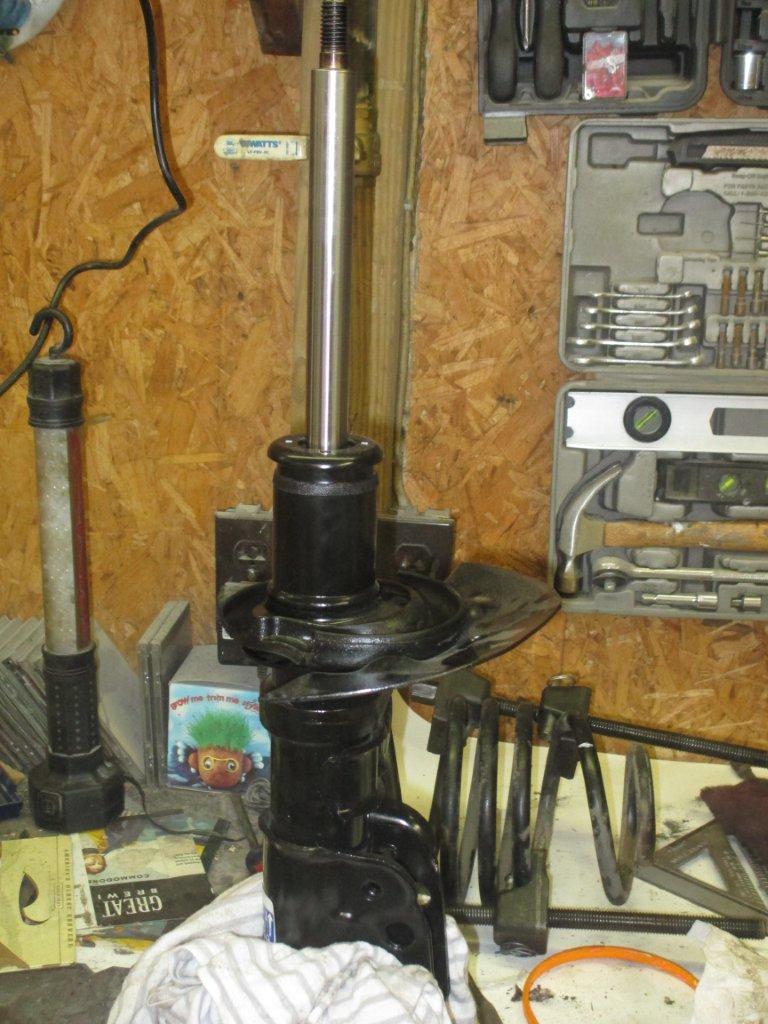

After ordering/returning 11 total struts I have a pair I am satisfied with and installed on Sunday.

11?! Wow. So what brand are those that you settled on?

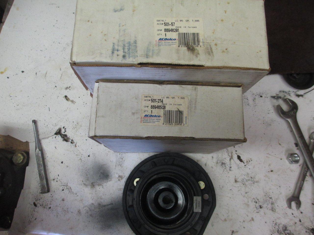

ACDelco strut mounts, nice. I put Monroe on mine and one of the studs broke on the 2nd or 3rd tightening. I'm not super impressed.

Those are Monroe struts, P/N 71921 & 922.
Not my first choice, but..
Some of the 11qty were good ones I had returned so I had a matched set. I broke it down in a thread on the suspension forum.
The ACDelco mounts seem nice even though they are made in Taiwan, and the bearing had a made in India sticker..
They were on closeout so I got em cheap.

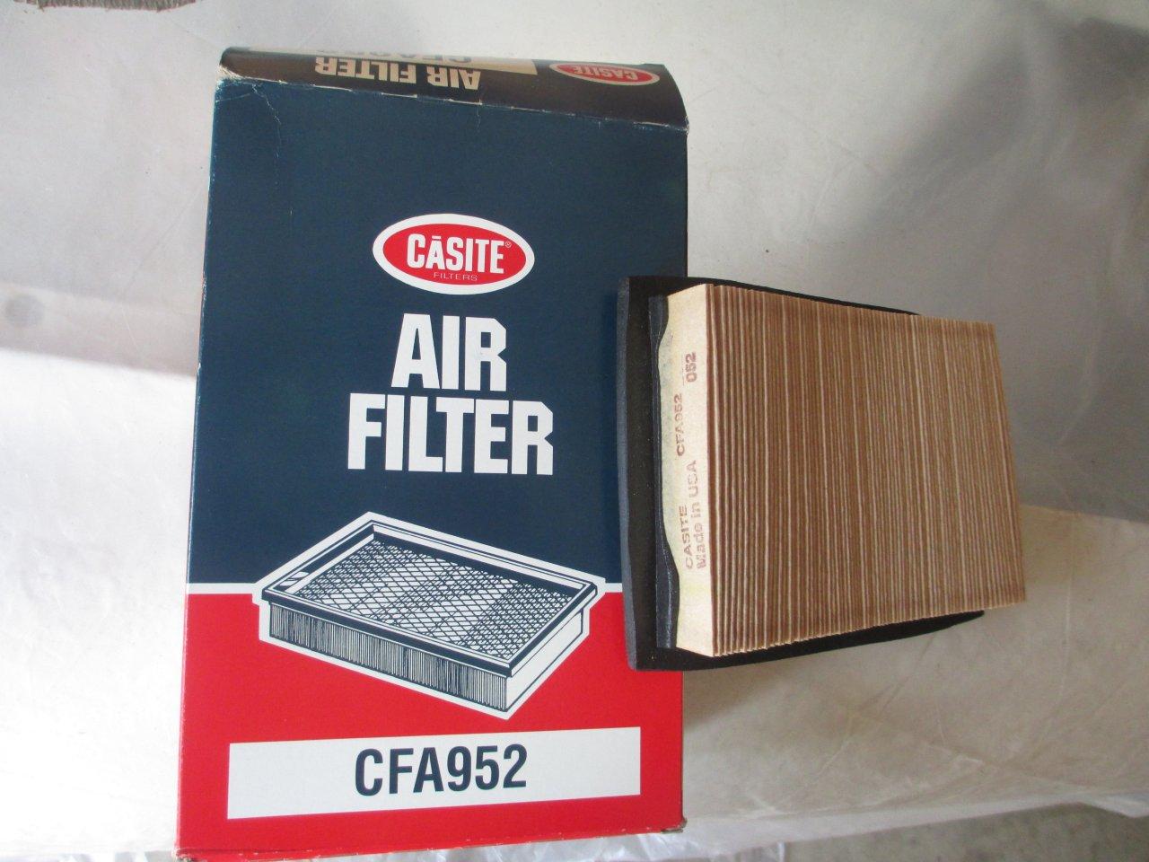

I completed my pre-flight checklist now that I have my RA closeout $1.79 Hastings Casite air filter installed.
You'd think I would avoid the closeouts after the strut debacle, but I figure an air filter is pretty safe.
Wonder how old this thing is? Made in USA so that's cool. I was a stockperson at an auto parts store in the mid '90's, we carried Hastings but they didn't look like this. Private label maybe.

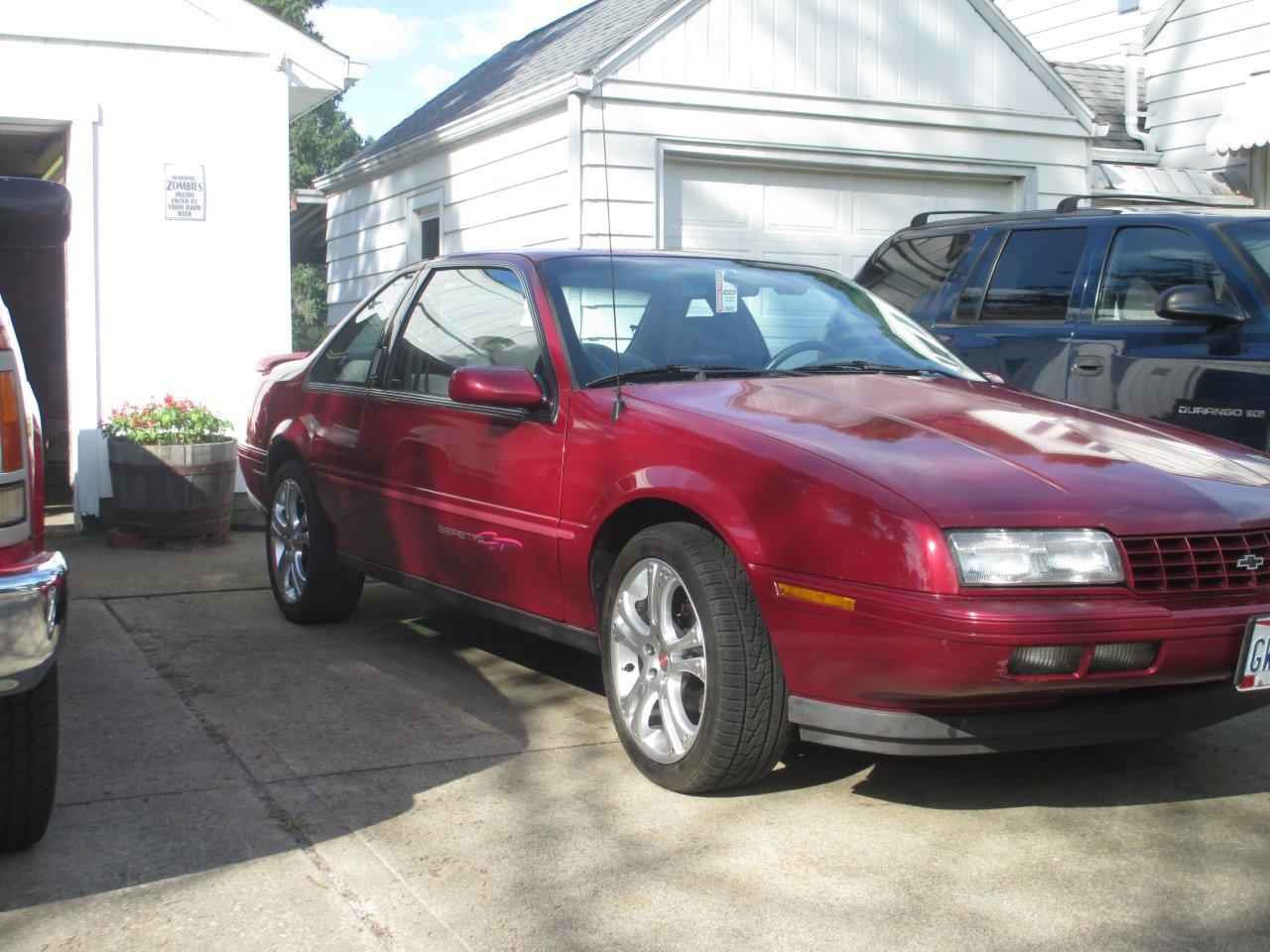

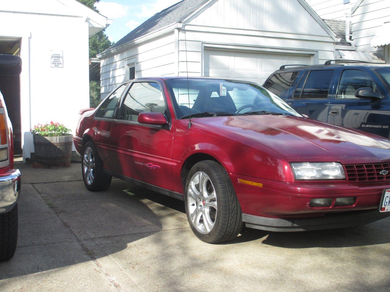

Cleaned up from the road trip
Post by EPfiffner »
Finally got a bath after our 1500 or so mile trip attending a destination wedding and then on to the beach after that.
Once we reached the wedding venue in Asheville, I thought for sure the trans was cooked.
We had just exited the freeway after 450 miles, and then the wedding venue was up this insanely steep mountain driveway.
We were creeping along trying to find the address, and the car just wouldn't move. I wasn't revving it, but it just didn't want to go.
Ended up we had passed the driveway and had to turn around and go back down the hill anyway.
When I was turning around and shifted from drive to reverse, the car didn't have the normal engine braking, and rolled forward in to someones landscaping rocks. You can see the scrapes below the turn signal, bummer.
I was worried that we would have to go home instead of continue on to the beach, but my dad said that the fluid just was boiling from being on the highway in the mountains going 80mph or more, and it would be fine.
Sure enough after it cooled down we smelled the fluid, good, nice and red, and it was fine.
Other than that the car was excellent. I think the cheapass front motor mount I just put in broke already, but not real surprised.
I swear I feel the trans either kicking in and out of lockup, or shifting at highway speeds since we have been home. It could either be the broken motor mount amplifying it, or maybe the trans is getting tired, but either way it was good on the trip and that's what really mattered.
I didn't put tire dressing on for the pic because I knew it was going to rain the next day. She sits outside unfortunately.
