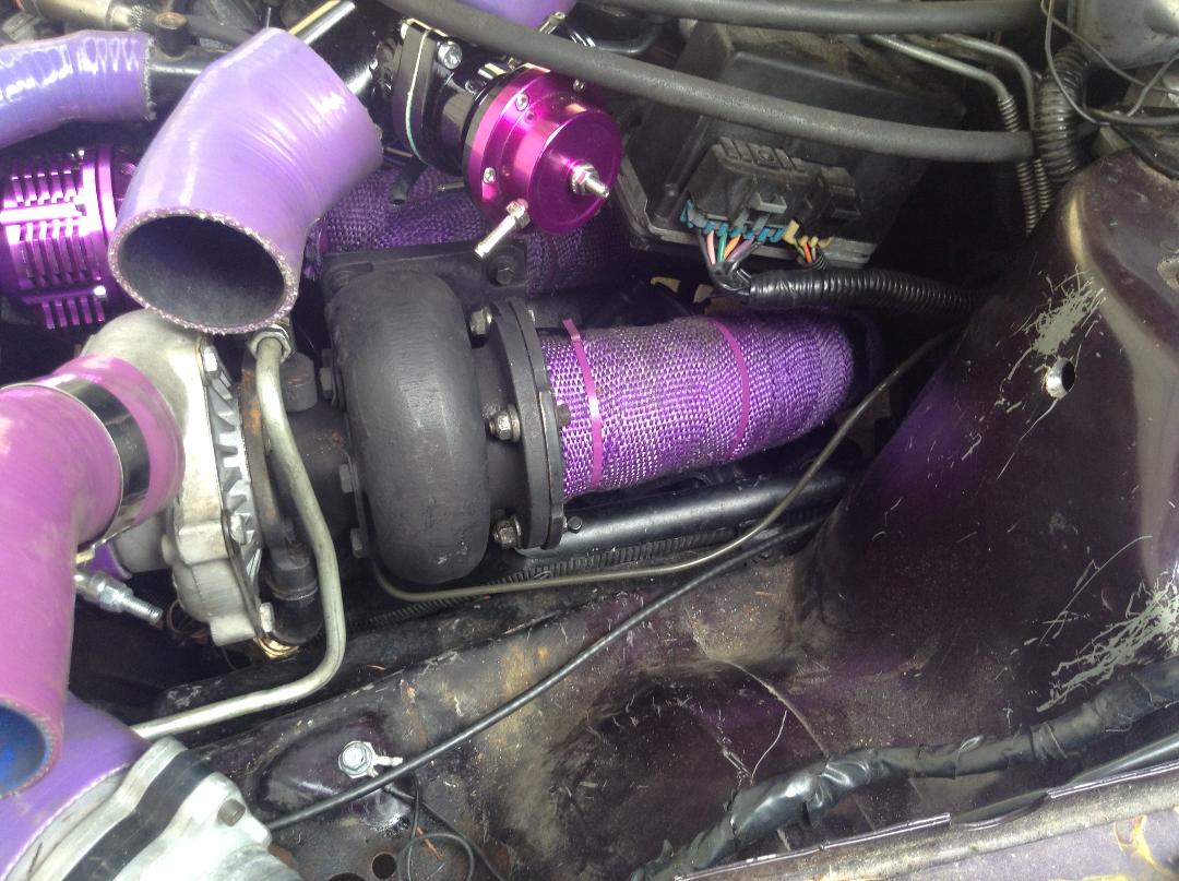

Rettax3 wrote:Down-pipe and dump-pipe assembly is finished. I have some hesitations about this not having a flex-joint of any kind in the dump-pipe, but I'm hoping the 1.5-inch pipe itself has enough flexibility not to bugger things up. I'm also not crazy about the fact that the turbocharger needs to be removed to get the dump-pipe out from under to remove the down-pipe assembly, but this is a compromise for ditching another joint in the assembly that could eventually leak, and still keep everything tucked-in tight, with as little extraneous piping as possible.
I've got it routed well away (relatively) from the ABS and master-cylinder, I think it will be fine with just the header-wrap. Still might need a turbo blanket though... I'll likely also insulate the bottom of the ABS unit, so long as it can still dissipate its' own heat.

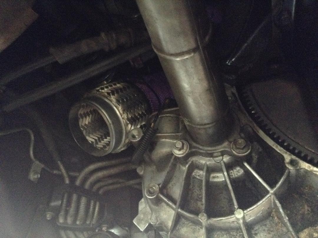

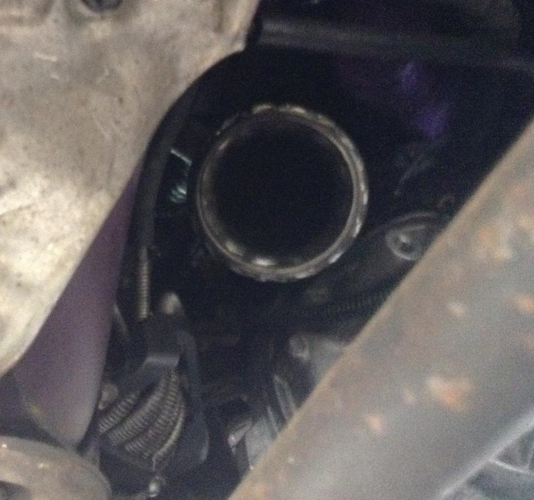

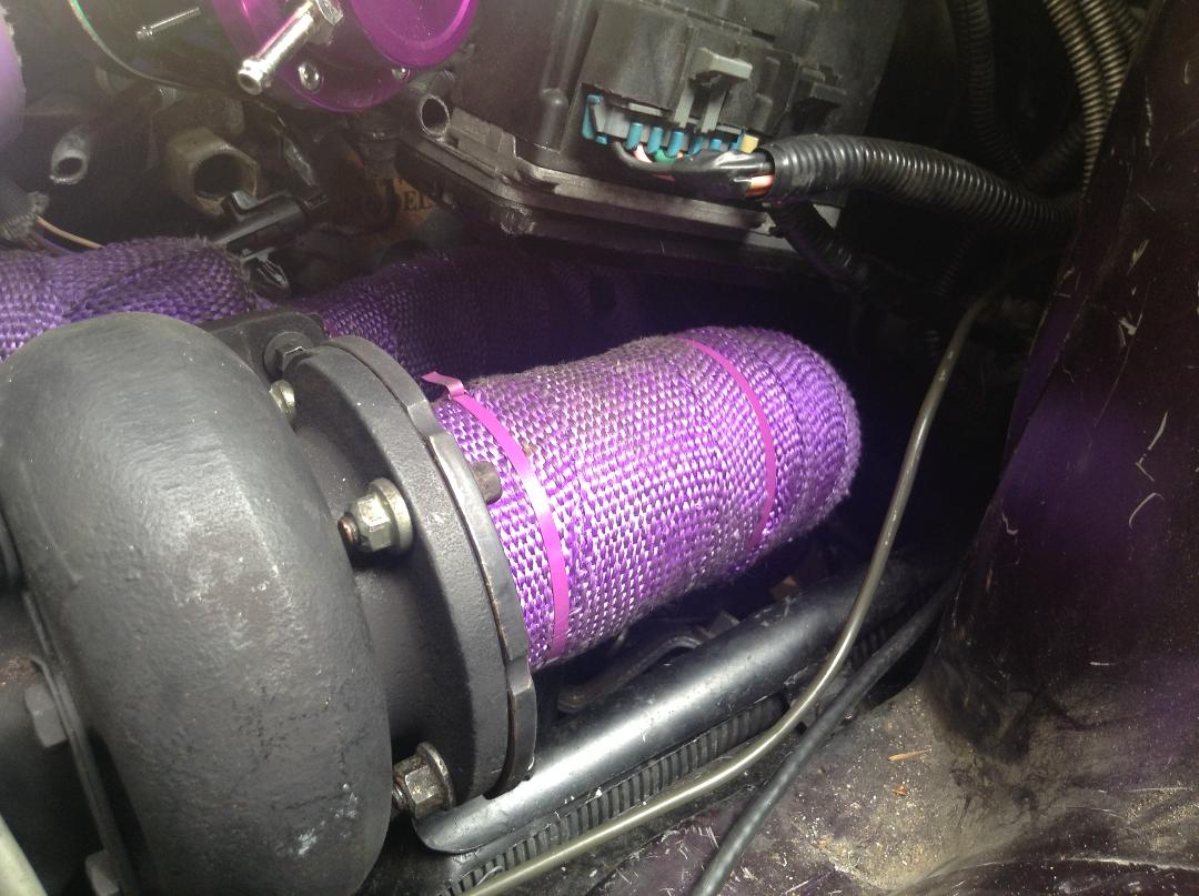

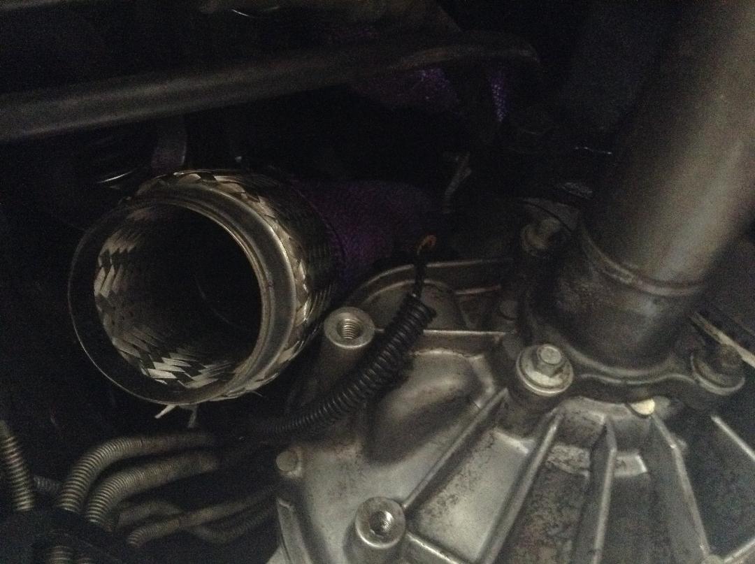

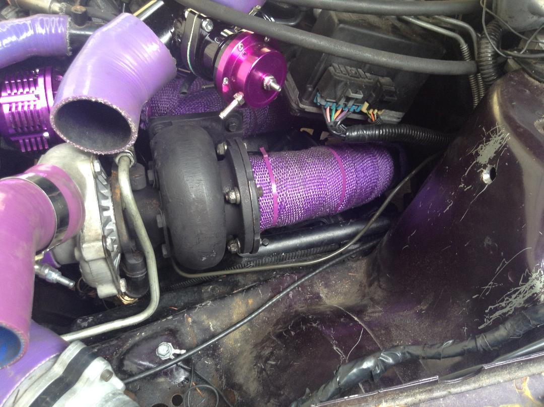

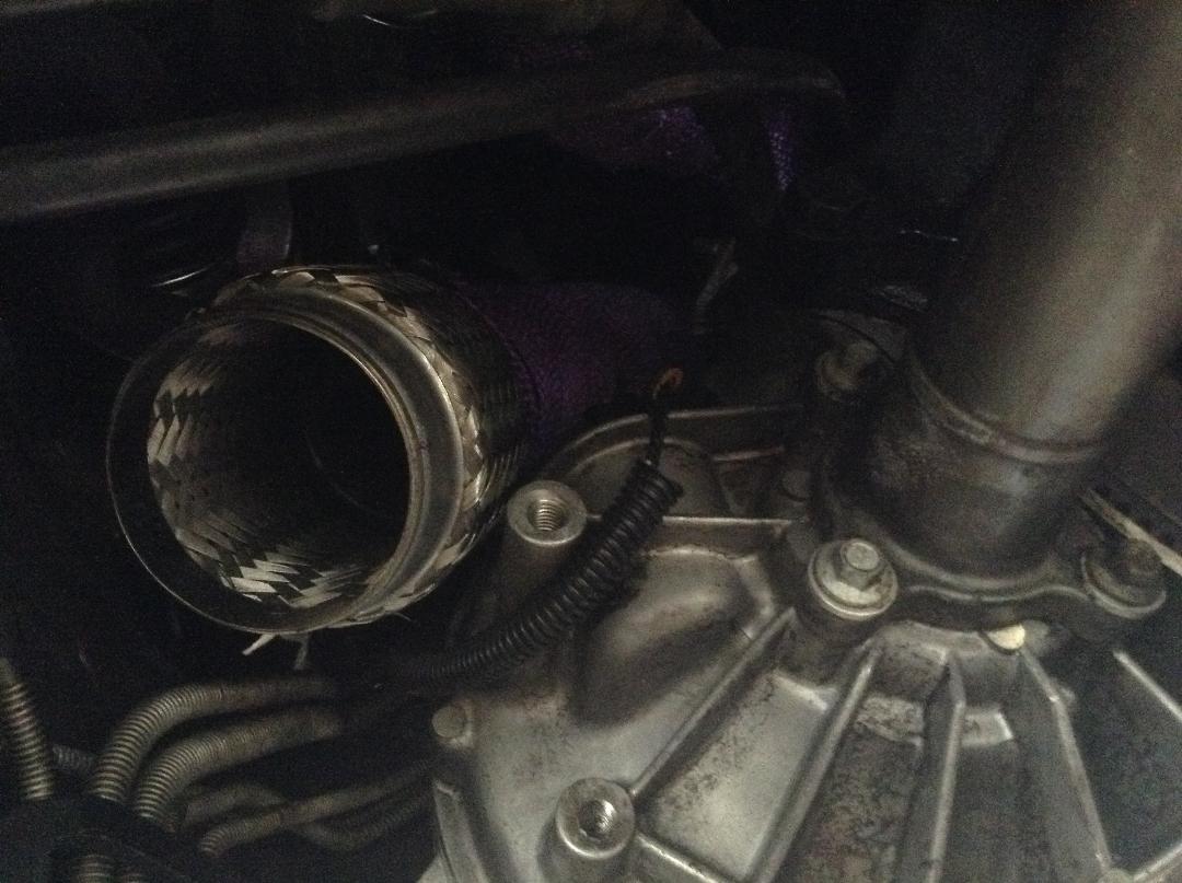

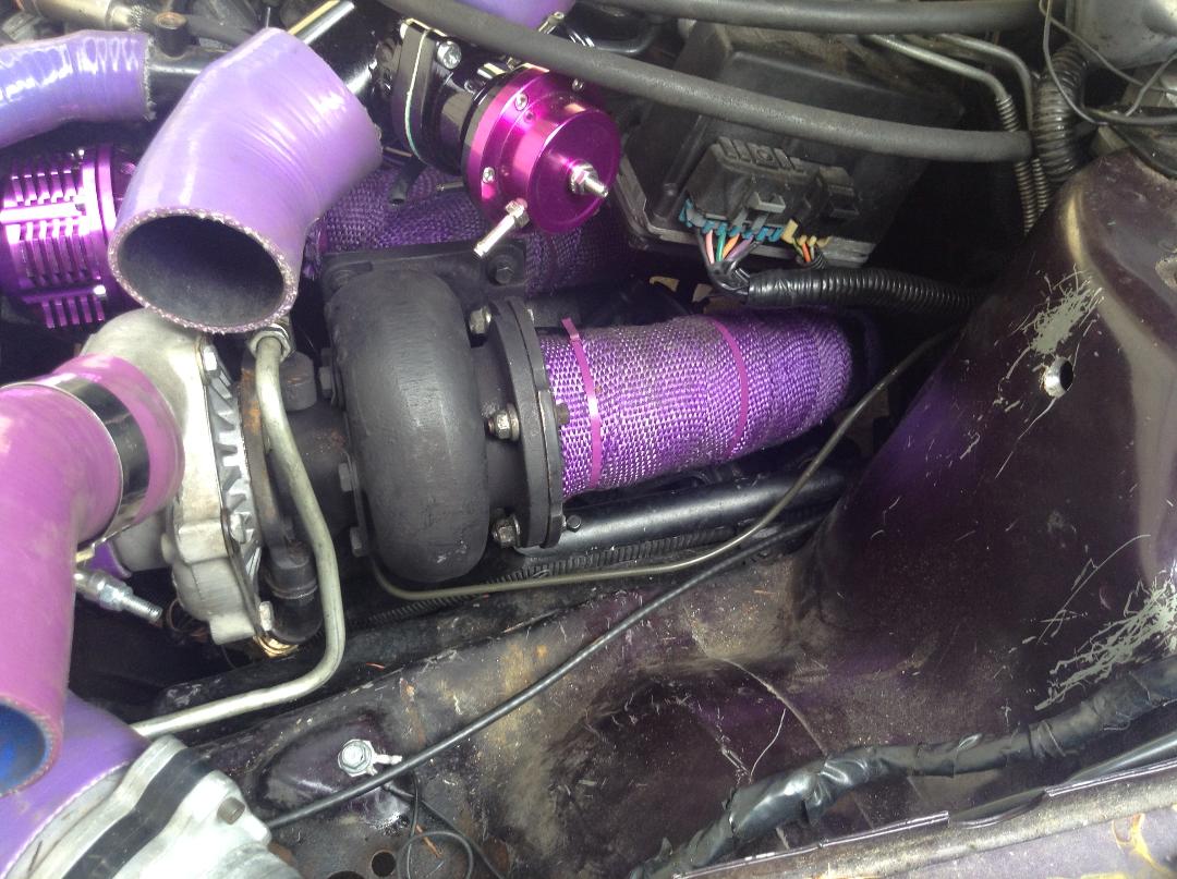

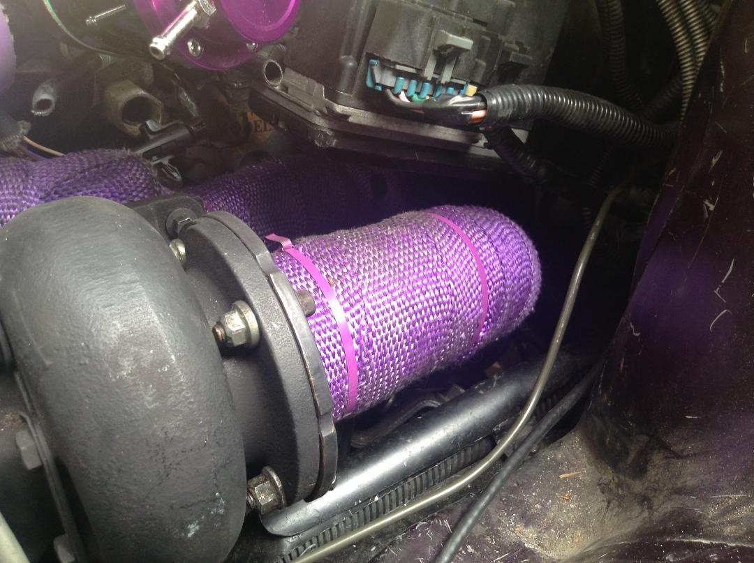

Here are some pics from today. I swear it looked like the DP cleared the ABS components of the Master Cylinder better than this... But it will be okay I'm sure. I will use a thermal insulator on the bottom of the module just to be certain. The heat-shield and electrical harness conduit I fabbed is visible here too.
Ugh, I'm still going to have to deal with the heater-core supply hoses.  I'll probably use that quick connect there, but I would rather ditch it for a straight hose nipple.
The clutch hydraulic hard-line looks closer to the turbo in this shot than it is.  The other side by the cold-section is actually closer.
From these shots, that pipe just doesn't look that big, but it is. I thought it cleared the transaxle better than this too -it must be a subtle angle-change after the dump-pipe was welded on and everything was all bolted together. :fool: This will also be fine...
I'll be pinning the VSS harness away from the DP using the bolt-hole there on the transaxle.
Straight out and down, clears the sway-bar just fine.

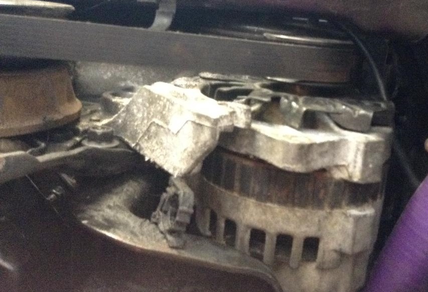

Here is a shot of the alternator in the A/C Compressor bracket. This small spacer seems to put the pulley dead-square to the other pulleys. I'll know for sure if the belt squeaks or not...

Do you think the heat from that down pipe is close enough to the brake and fuel lines under the car to cause them to get hot and the fluids might bubble?
I hope it works, I second a thicker heat insulator between the abs unit and the pipe, I seen a beretta that was turbocharged that had a fire because the abs unit melted onto the downpipe. It was kinda scary and I only saw the aftermath after the car was sitting not being used.
Posts: 1843
Re: Finally...
GT_Indy wrote:Do you think the heat from that down pipe is close enough to the brake and fuel lines under the car to cause them to get hot and the fluids might bubble?
No, from my experience with my '90 Turbo 'Retta, the lines are well enough away from the exhaust and will have no problems from it. Besides, DOT-3 fluid isn't supposed to boil until 400 degrees, and the fuel is constantly being circulated from the tank, except for that short time between shut-down and cool-down, and even then it is supposed to remain under pressure. Thanks for the input though. :good: I never even had thermal-wrap on the '90's DP, even when I upgraded the original T-25 setup to this same T-04 (2.5 inch pipe on that car, 3 inch here) and there were no problems with the DP. Of course, the '90 does not have ABS... The ABS module will not melt from the heat as is, but since it is an electronic component, I am less than 100% certain that it will be happy with the heat, so I would rather take a moment to add a thermal barrier for it (hopefully I won't trap its' own heat in and cause damage). The shift-cables on this car seem to be farther away from the DP than they are on the '90 Turbo, and although I started fabbing a heat-shield tube for them, I may not bother installing it -that is just one more thing to rattle under the hood if I don't need it. I'll see how it all looks when I am done with the exhaust.

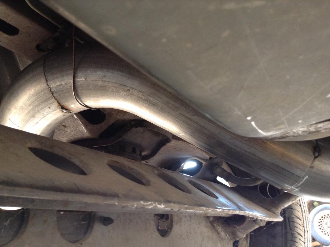

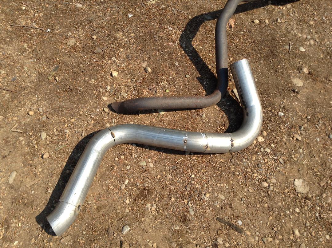

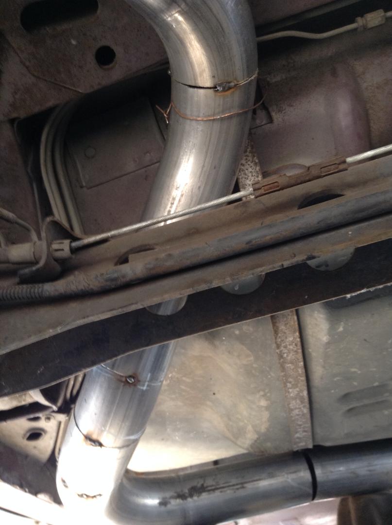

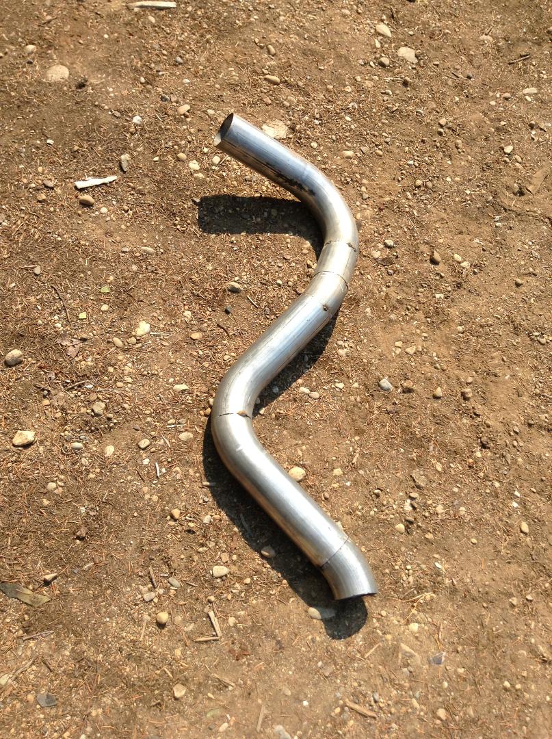

I got the exhaust-pipe done out to the muffler today. The car is very loud with just the turbo and a Flow-Master 3" in, dual 3" out muffler. I do believe the "Twin Dual" (haha!) Z-26 resonator tips will help tame it down a little. I had hoped for something a little quieter than my GTU, but I didn't want a restrictive exhaust, so I guess I can't have it all...
I angled the bend over the rear suspension beam a little further towards the center of the car, the bends were a little less extreme that way, and I have enough concerns about the suspension clearing the 3-inch pipe without cutting corners, as it were. Here are some shots of the pipe tack-welded during fitting...

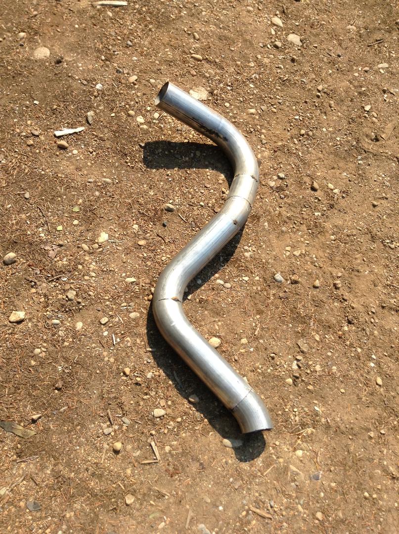

Built bend-by-bend, ready to go.
Tacked-up for fitting.

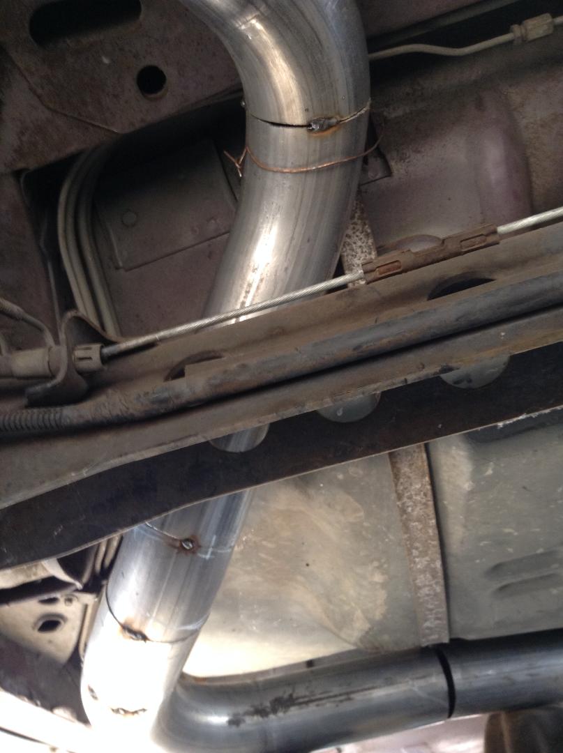

Up-and-over!  This is why MOST of my cars end up with side-outlets...
Out with the old, and in with the new!  Not always a fan of that attitude, but c'mon, how restrictive would the original pipe be?? It can be seen that I redesigned the bend-angles a little, I like how this one clears everything underneath.
