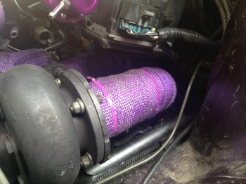

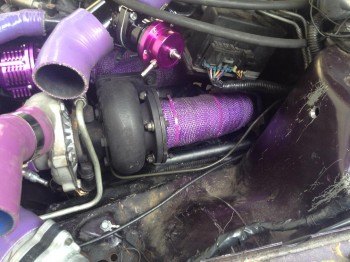

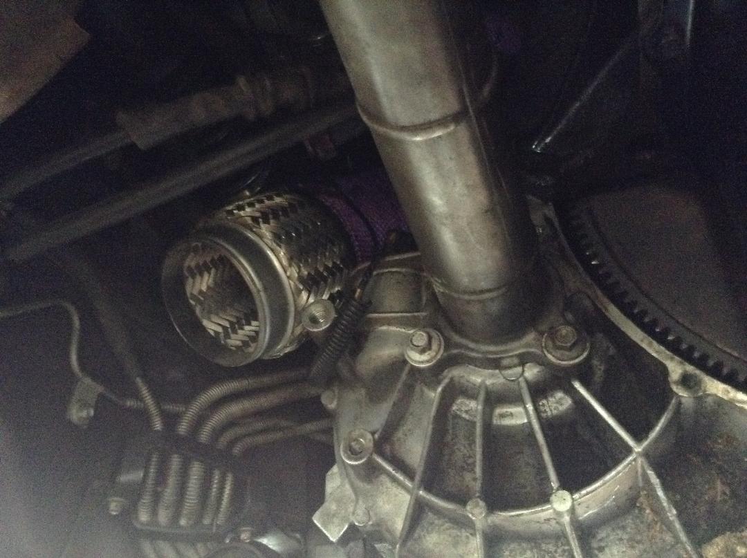

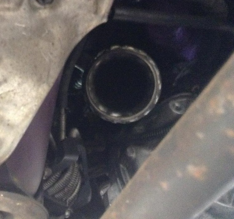

Here are some pics from today. I swear it looked like the DP cleared the ABS components of the Master Cylinder better than this... But it will be okay I'm sure. I will use a thermal insulator on the bottom of the module just to be certain. The heat-shield and electrical harness conduit I fabbed is visible here too.
Ugh, I'm still going to have to deal with the heater-core supply hoses.  I'll probably use that quick connect there, but I would rather ditch it for a straight hose nipple.
The clutch hydraulic hard-line looks closer to the turbo in this shot than it is.  The other side by the cold-section is actually closer.

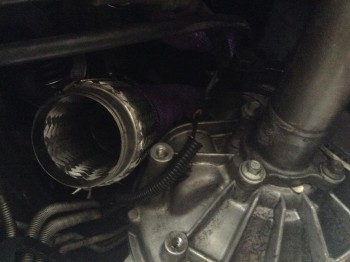

From these shots, that pipe just doesn't look that big, but it is. I thought it cleared the transaxle better than this too -it must be a subtle angle-change after the dump-pipe was welded on and everything was all bolted together. :fool: This will also be fine...
I'll be pinning the VSS harness away from the DP using the bolt-hole there on the transaxle.

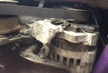

Here is a shot of the alternator in the A/C Compressor bracket. This small spacer seems to put the pulley dead-square to the other pulleys. I'll know for sure if the belt squeaks or not...

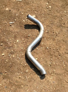

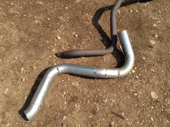

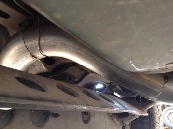

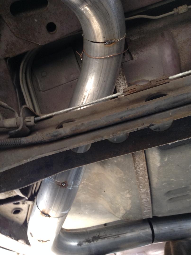

I got the exhaust-pipe done out to the muffler today. The car is very loud with just the turbo and a Flow-Master 3" in, dual 3" out muffler. I do believe the "Twin Dual" (haha!) Z-26 resonator tips will help tame it down a little. I had hoped for something a little quieter than my GTU, but I didn't want a restrictive exhaust, so I guess I can't have it all...
I angled the bend over the rear suspension beam a little further towards the center of the car, the bends were a little less extreme that way, and I have enough concerns about the suspension clearing the 3-inch pipe without cutting corners, as it were. Here are some shots of the pipe tack-welded during fitting...
Built bend-by-bend, ready to go.
Tacked-up for fitting.
Up-and-over!  This is why MOST of my cars end up with side-outlets...
Out with the old, and in with the new!  Not always a fan of that attitude, but c'mon, how restrictive would the original pipe be?? It can be seen that I redesigned the bend-angles a little, I like how this one clears everything underneath.
