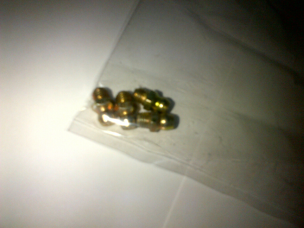

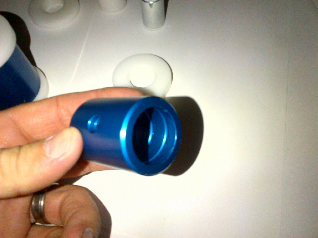

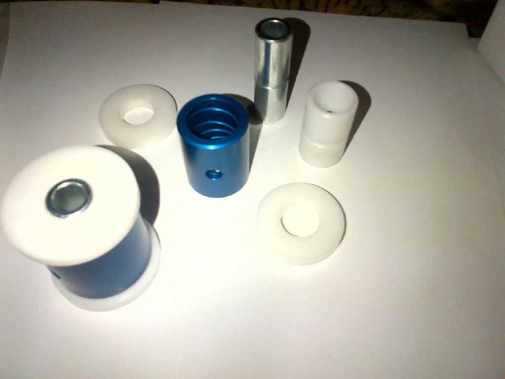

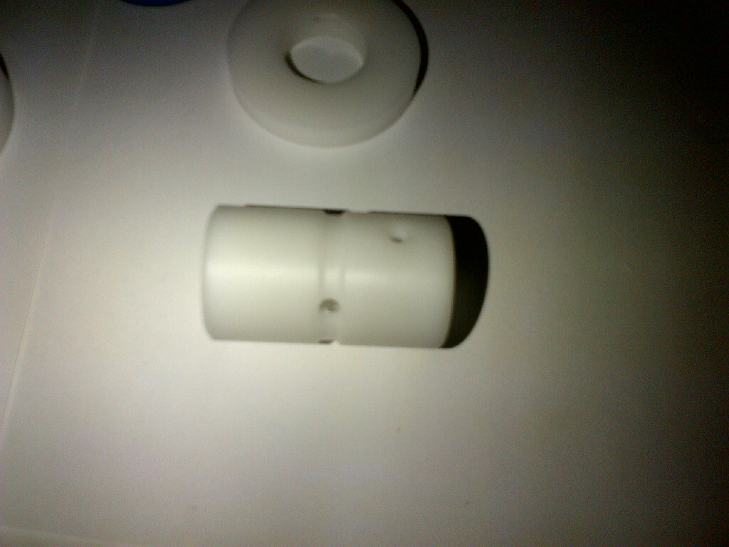

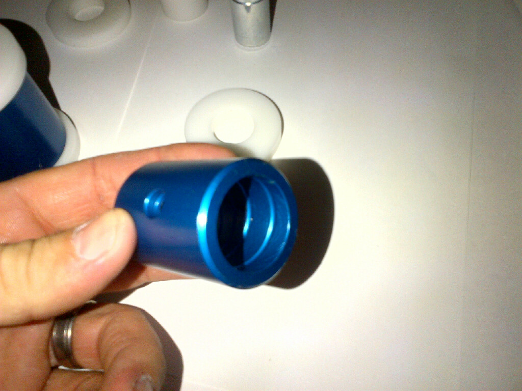

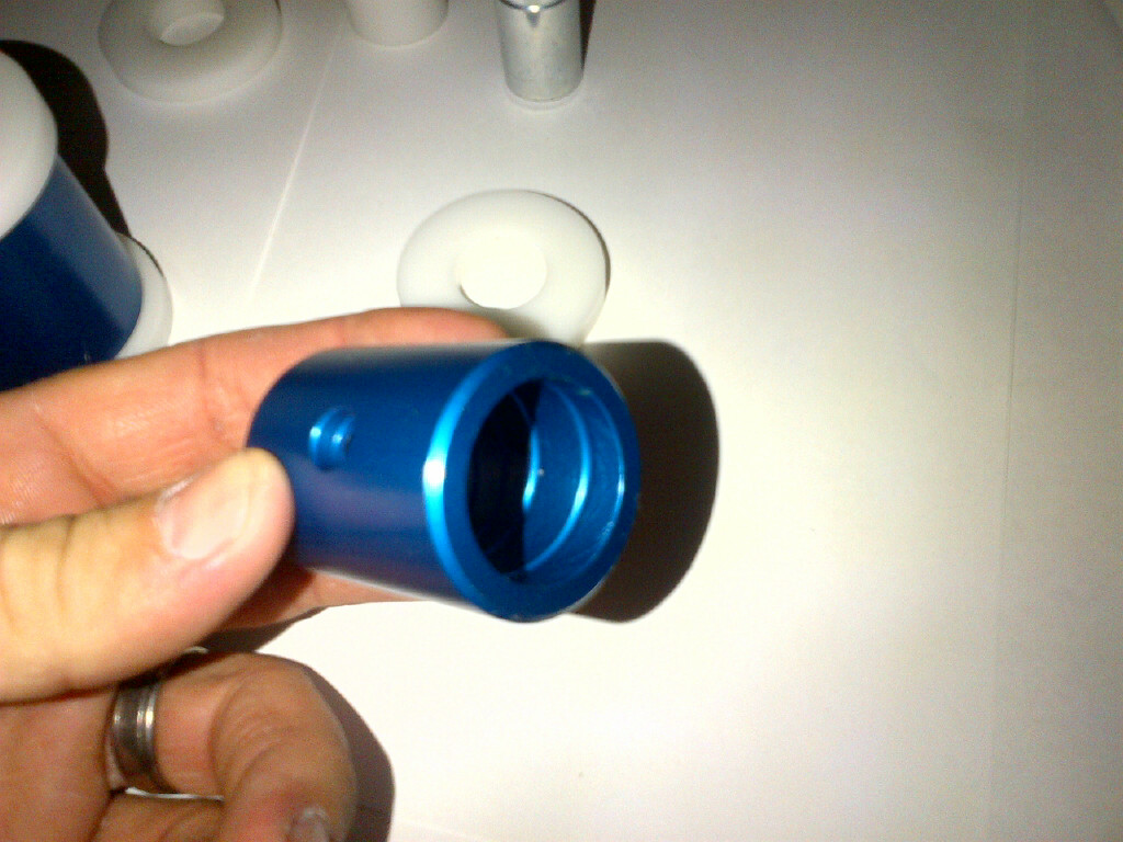

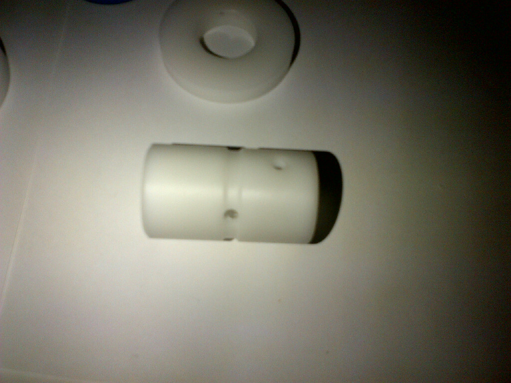

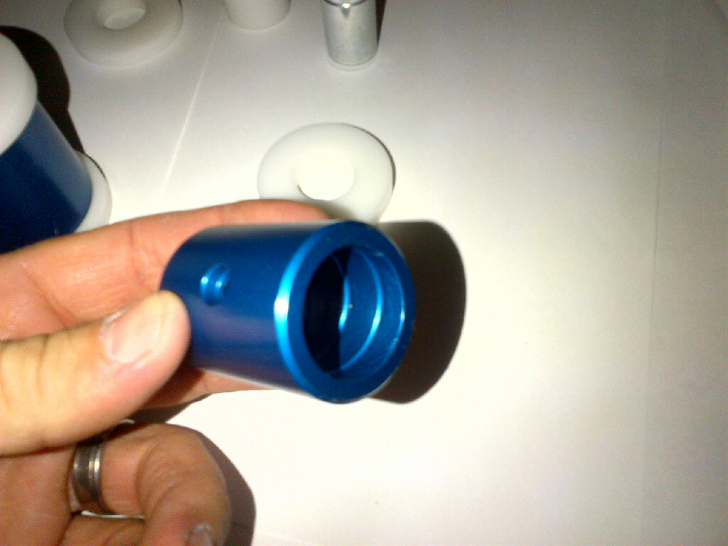

FINALLY!!!!!!!!!!!!!
They showed up today and they look fantastic! These are very well made, and yes Jon, they came with directions! They cost me $141 per set plus shipping. Here's the pics:

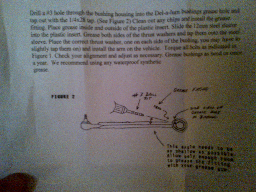

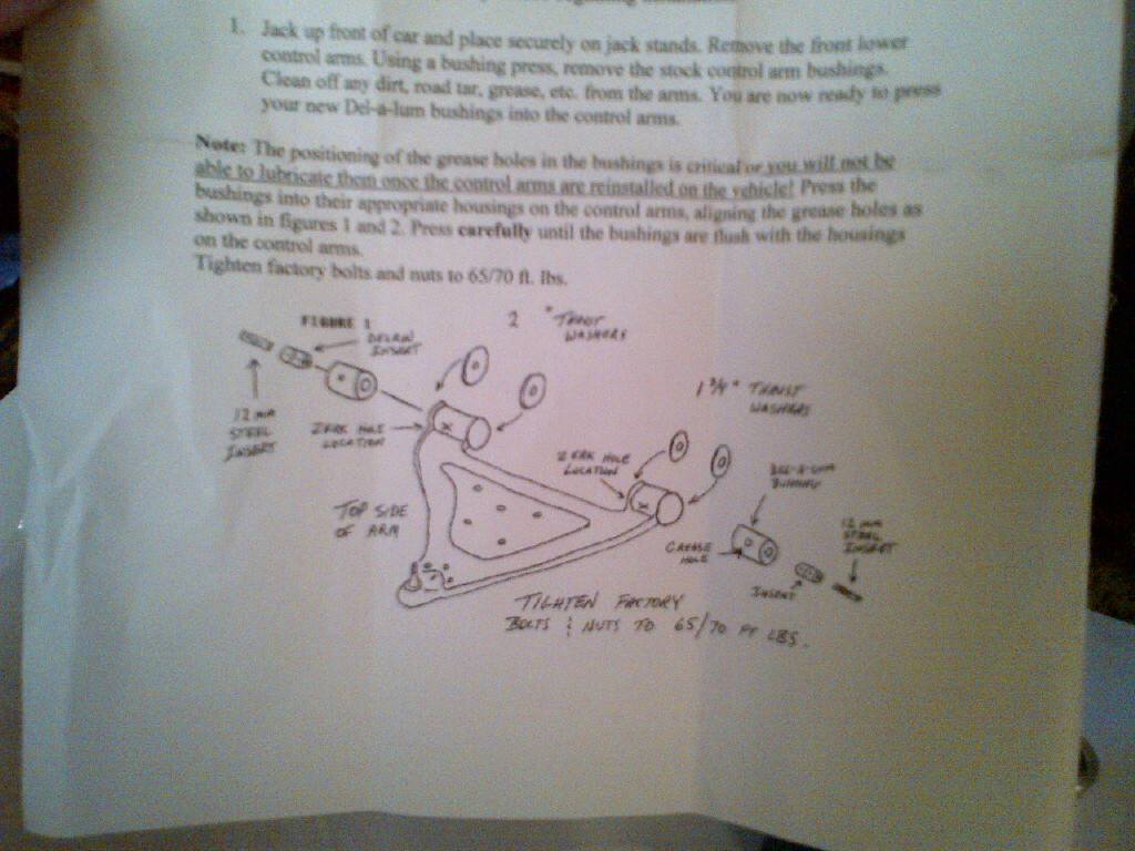

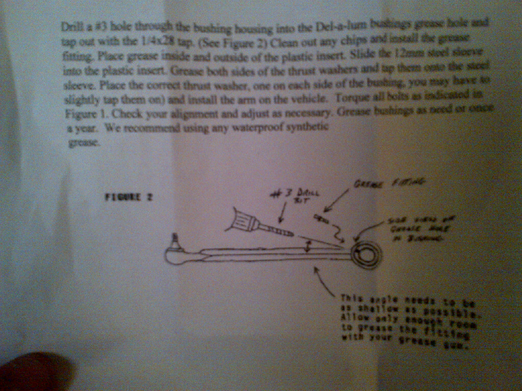

Here's the directions:

i haven't paid attention to what kind of room the subframe has in that area with the control arm in... at the lowest ride height possible (full control arm articulation), could that zirk fitting get taken out? i'm sure the subframe could be notched real easily if that's the case

Well someone could have just asked and they could have said, YES the aluminum part is pressed into the control arm and my question would have been answered.

Getting parts made for a car that's been out of production for as long as these have is difficult regardless of what the part is. Get it thru your thick skull. I didn't answer your questions because I DIDN'T HAVE AN ANSWER! When I talked to Doug the last time I asked if they were press fit and he said he couldn't remember but the instructions would be included with the finished product. As for the lapse in time between posts it's pretty obvious. I hadn't gotten any responses to any of my emails so I gave up on the project. I didn't have any money invested in it other than a set of poly bushings and a spare control arm I sent them so I figured it wasn't worth the headache. You can lock me out or do whatever the hell else you want since you're a mod but you annoy the hell outta a lot of people with your superiority complex. I remember meeting you at DaGrove raceway in Union Grove WI for one of the fests and you were Mr Knowitall then too. Just because your the tire changer on a race team doesn't make you an automotive genius.
