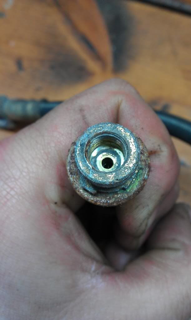

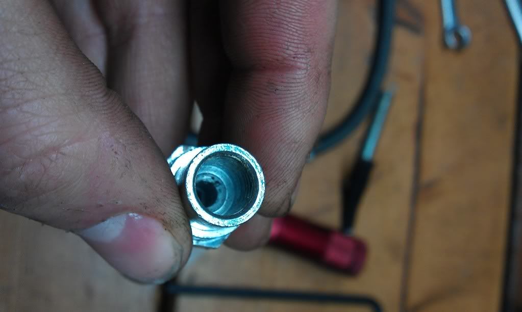

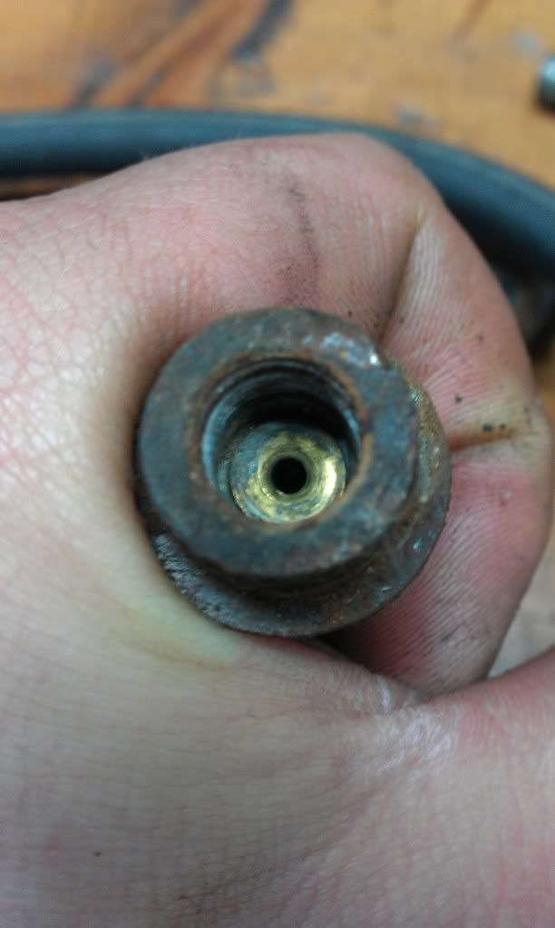

Did you test the 3/8 24 thread? Is that the same as a 10mm X 1.0? If its not I know these cars are Metric so that may not fit. Unless your lines have been replaced at one point in its life.
I got my invoice... I'll add it to the brake thread.
63010220ERL X2 3an to 10mm(3/8) Banjo 20" Hose
63011626ERL X2 3an to 7/16" Banjo 26" Hose
977522ERL x2 7/16 x24 Single Banjo Bolt
989534ERL x4 Brake Adapter 3an to 10mm x 1.0 Female NOT Inverted Flare.
I also just found all of my factory lines and FWIW the 96 is aparently ALL 10mm x 1.0 Bubble flare brake lines.
Rear Line
Front line
And my adapter
I guess the best thing to do is just check all your lines and find out what your starting with, then order those adapters, since they have them for almost any size.
Woody either they changed sometime during production, or someone has replaced your rear lines at one point in time. I know all factory rear cylinders for 95 and 96 are bubble flare and I had to make special lines for that when I did replace them.

My hoses definitely are inverted flare, so I'm assuming they're std not metric, cause all the metric stuff I've seen is bubble. I put new hoses on the axle when I built the car and what Advance gave me was IF and fit the factory lines.

RockAuto lists the same hose for 87-96 Beretta.... Thats a bit confusing going by what photos I just took.
