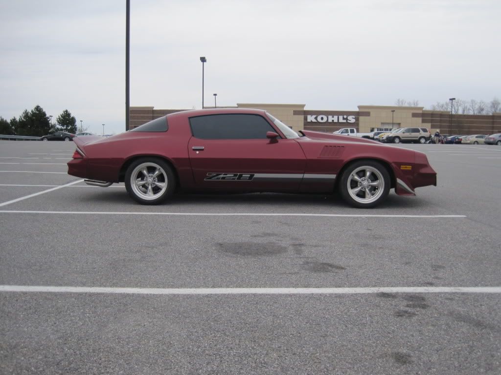

Kurt, I'm in love with those wheels already. Can't fit a 295 tire on a Beretta! haha

Looks like it barely fits that fender well... Do you have to roll or does the suspension not travel far enough to tuck?

Fronts and rear will both tuck. Both wheel wells will be slightly modified to make it happen. Rear is easy, I just need to roll that quarter lip. Front will take a little inner fender reworking...but it's gonna look bitchin. I'm dropping the ass end about 1" when I change the leaf shackle bolt from the lower to the upper hole (already has 220lb lowering springs) and the front should drop 1-1.5" when I cut & reweld my front core support to align the fenders correctly with the wedged subframe. Lots of guys cut the Hotchkis coils to get the right ride height since removing weight from the front is common. That's one of the beautiful things about a-arms...you can cut the springs any length you want and it works fine, because the flat end goes in the upper spring pocket of the subframe, and the control arm is shaped for the odd end of the spring.

I went with taller tires than most guys go with (27f, 28.3r) when lowering (most go 26). But from the factory these things had 27.4" tires, so it needs some height to fill out the wheel well...just makes them a little tougher to fit when you drop them. Mine had 26s on it when I bought it and they looked tiny. Better when lowered like WickedZ's car here, but still tiny.
See the 26s just look too small to me.
