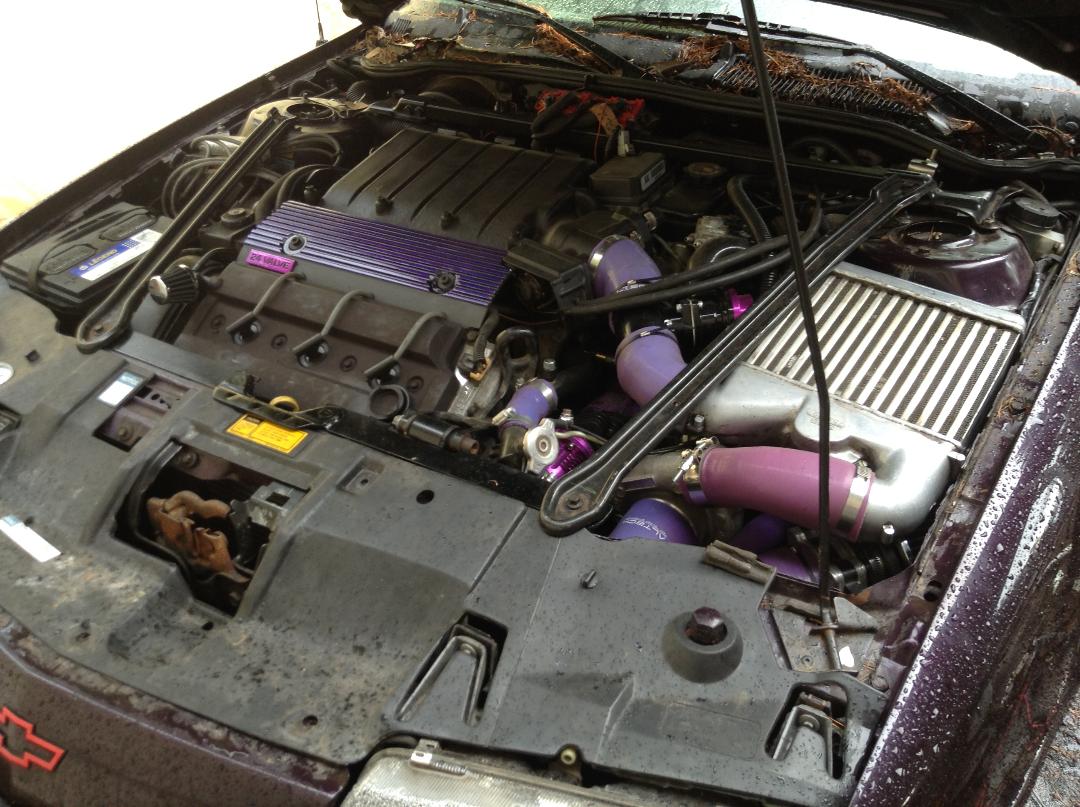

Still plugging away at this thing, a little here and a little there. I'm trying not to rush this build, so I keep trading-off functional work with cosmetic, to keep it all going at a pace. I have managed to find a use for an old 2.4L Twin Cam IDI cover other than as an extension-cord and air-hose walk-over plate for the garage floor too...
I am very tempted to use one of my H.O. Quad 4 IDI covers, but need to alter it to read "24V" instead of "16V" first. I kind of hate to cut one of those up, too. Here is where the car is at now:
Almost nothing left to 'tidy' in here. I do still need to run the line for my boost gauge, but the Tee is already installed and ready to go. I need a new oil filler cap too...
I also need to modify the front plastic 'header-panel cover' for the coolant reservoir access and for the washer-bottle access, which is why it isn't fully installed yet. It is hard to see here, but peeking into the frame on the passenger-side of the panel is the coolant-pressure gauge, which is tapped onto the radiator's old bleeder-port. I had initially routed a bleeder line over to that port, but overall it seemed unnecessary, so I ditched it.

Wow that engine bay is cramped.
Looks good though!
