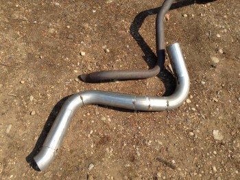

The pipe I used on my '95 Z vs stock.  "Mandrel-bent" is a machine/process that does not crush the pipe in the bend, so the radius stays constant throughout, thereby preventing restriction.  3" just equals big for exhaust, though nothing to brag about anywhere else in life.
Here is a short vid of my '95 Z-26's exhaust, with the 'Twin Dual' Z-26 tips (this is a play-on-words, as the LQ1 engine I shoe-horned into this car was labeled as the "3.4 Twin Dual Cam" engine by GM. Stupid name -TDC means Top Dead Center not Twin Dual Cam, thanks.

Rettax3 wrote:Yeah, the vid sounds a little strange -likely from 1. four outlets at different distances from the mic, and 2. a few spots in the piping that still need to get welded-up across the top.
