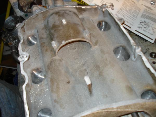

3500 isn't wide open, it's a tunnel from the inlet till about half way into the middle of the box, there are questions about poor flow to cylinders 5/6 because of the 180 degree direction change the air has to make.

Did the guy cutting apart that UIM - weld it back together?
Any better flow?
Re: 1996 Mr.Pink
No he was making a SC mounting plate on the top of it.
