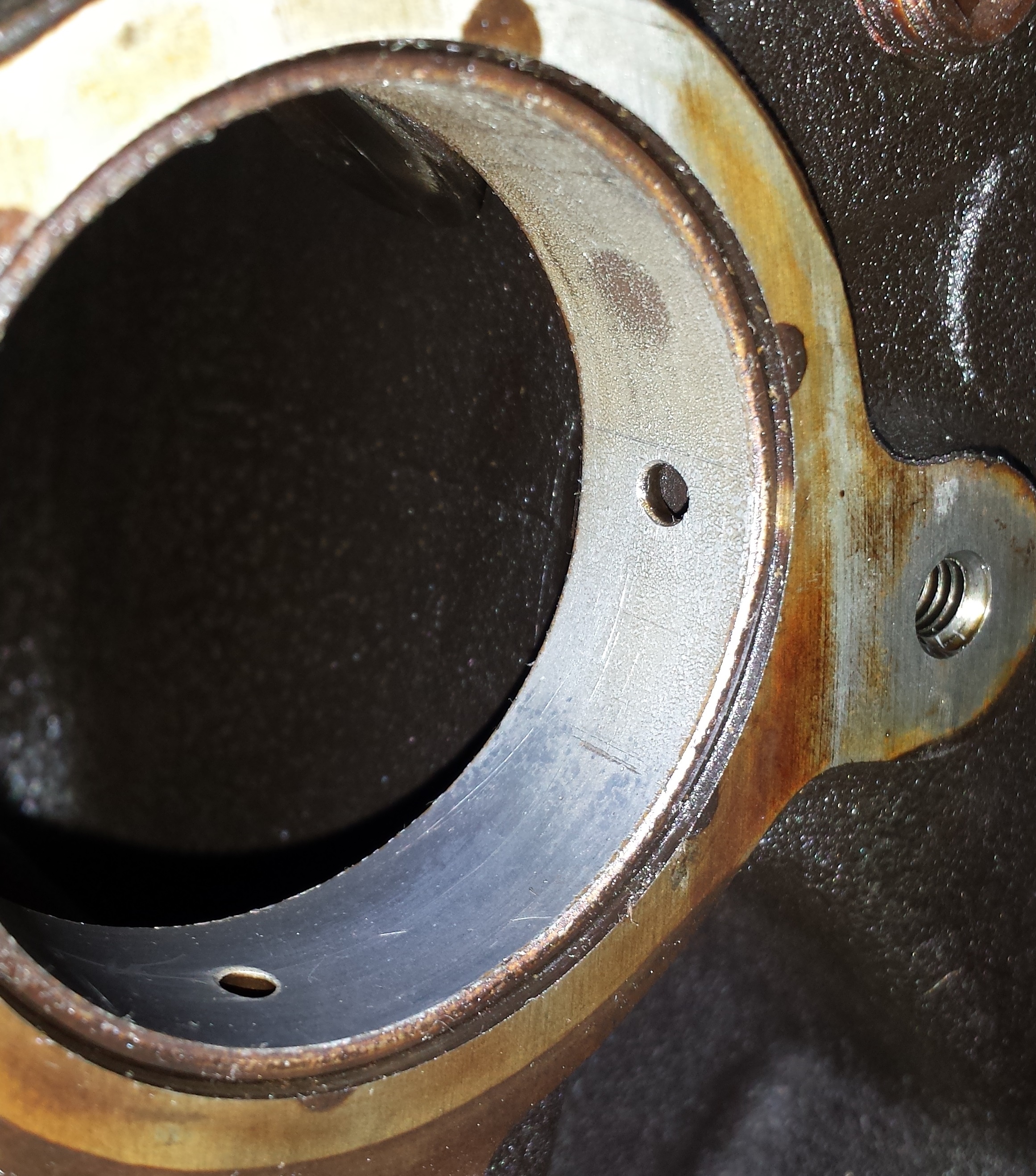

After going back and forth with Marc last year about DR timing chain and oiling issues we came up with a few solutions to try and ensure that the chain gets sufficient oil.

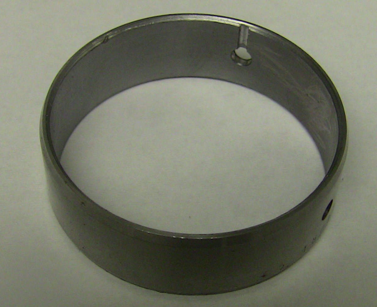

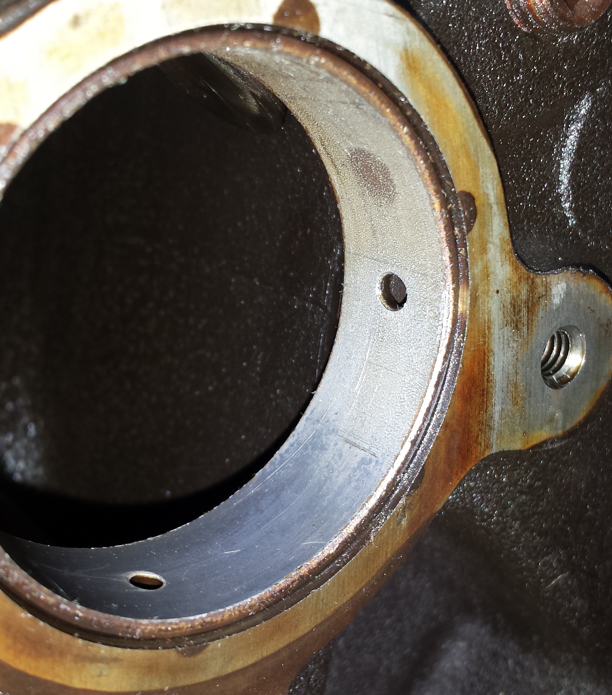

One is modifying the cam bearing to have two holes in it since the aftermarket SBC bearings you get you don't use the #1 in the pack because its too large, you only use bearings 2-5 all of which only have ONE oiling hole in it. One replacement 3400 bearing that Marc found had the two holes on the front #1 bearing like the factory ones do, AS well as a groove cut in the 3 O'clock position hole to allow for oil to make it out to the thrust plate and timing chain assembly. I will be drilling the second hole in my cam bearing as well as making a slight groove to direct more oil out that way.
Then next thing is recessing the bearing into the block as it's done by the factory to allow clearance between the bearing and the thrust plate seeing how the holes on that don't always line up very well with the cam/bearing gap.

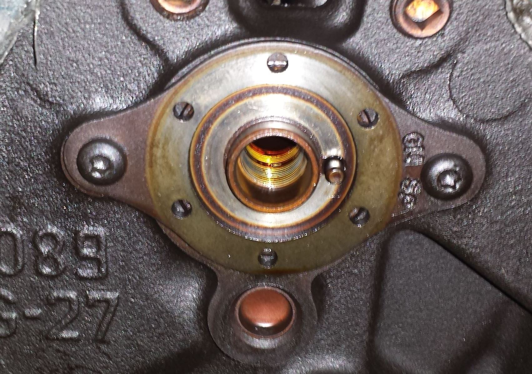

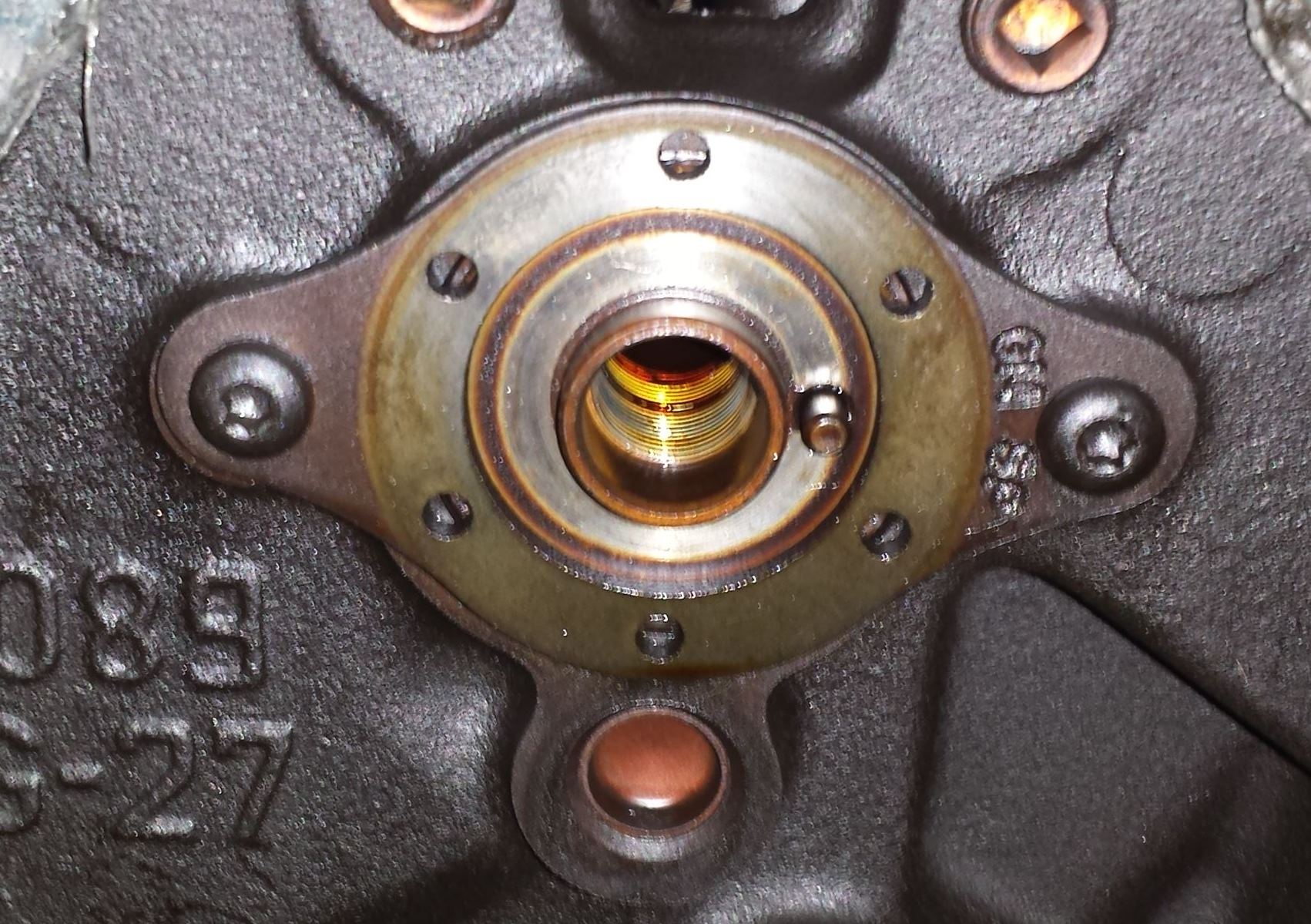

You can see the recessed bearing compared to the block face here.
It's hard to see in this photo, but the gap between the cam and bearing is not centered in the holes for the thrust plate... They drilled those holes I believe on the same diameter as the block cam journal, and not the actual journal size on the cam itself.
You can see how the oil stains are pretty well cut in half in relation to the block cam bore ID and not the bearing ID.

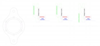

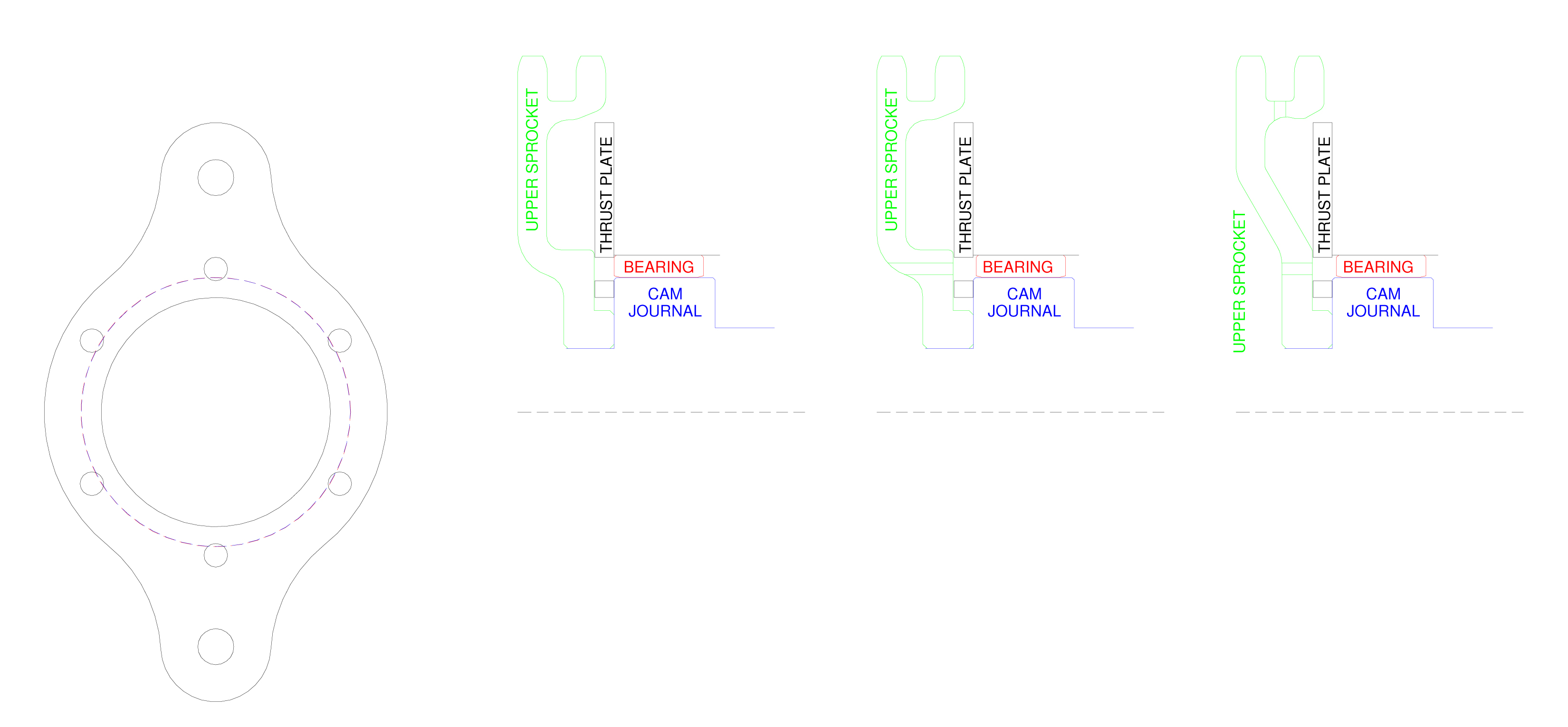

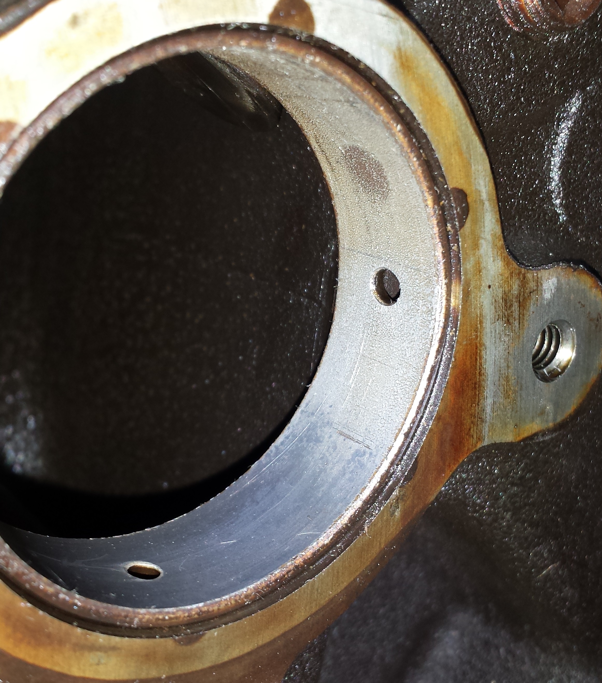

You can see in this diagram Marc drew the diameter of the bearing ID in relation to the plate, then a cross section of the sprocket, plate bearing and cam with the bearing flush mount, then recessed and then finally recessed with oiling holes drilled into the cam sprocket.
I will be doing the last cross section because I also drilled 4 holes in the DR upper sprocket.. I mean it can't hurt to direct the oil to the center of the chain rather than the backside only.
Hopefully all of this will result in a long lasting chain...
