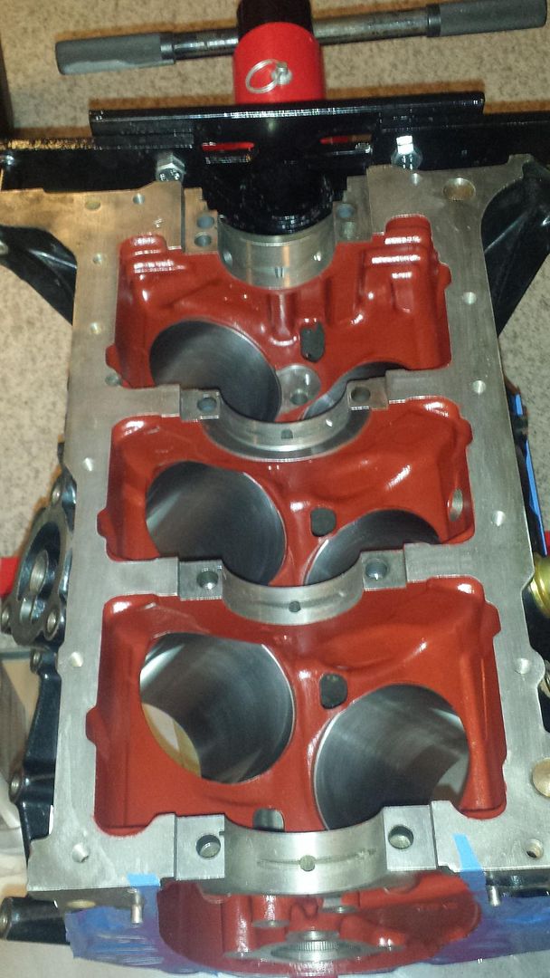

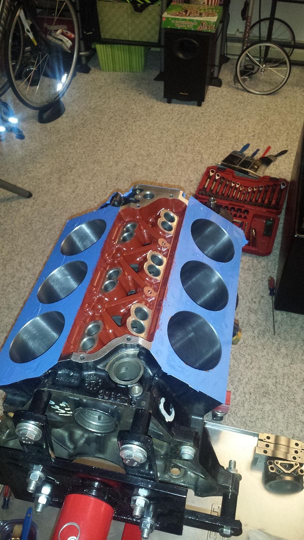

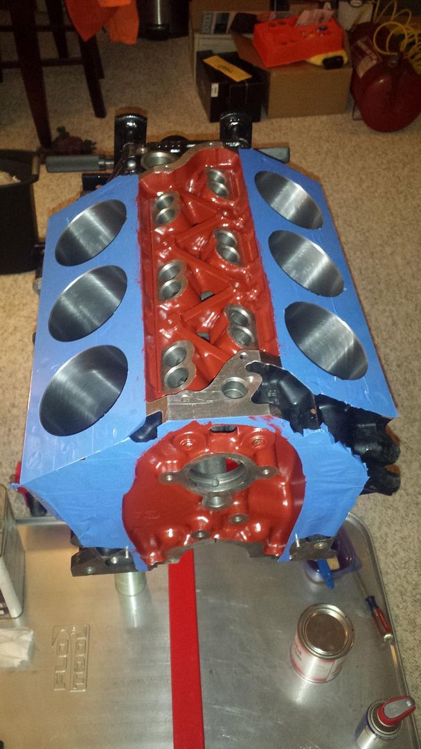

Finished up the second coat of Glyptal tonight and did some measuring of the crank.

3X00-Modified wrote:Finished up the second coat of Glyptal tonight and did some measuring of the crank.
I never seen this product before pretty sweet.. Too bad it doesn't come in pink..
What did the can run ya?
How many coats does it require?
Re: 1996 Mr.Pink
It's $49 for the can and you only need enough to coat the steel good so two coats is fine... Barely used any of the can too which is a bit of a bummer.
The only other bummer is you can't paint around the cam because it's not accessible like the old school small block engines. You can only get the valley and underside.

Starting to look like how an LSX crate block comes - nice!
Re: 1996 Mr.Pink
It's got an LSX block heater in it... LOL
And your backwards, those are powercoated orange on the outside and don't have an internal oil shedding coating, they are plain cast.... At least that's what I can find online for images of LSX blocks.

Did a bunch of measuring last night on the crank, and mains as well as piston bores and pistons. Came up with .0025 clearance with my measuring tools and the plastigauge says .003 so I'm fine with that.

Got some more time to work on it last night... During rough assembly I noticed the main studs did not all sit at the same height so I had to get a M11x1.5 tap and clean up the threads on all of the main holes. Once I got that done and all cleaned up I was able to move on to more major assembly.
Got a rotating assembly now with the mains torqued down. Just need to torque all the rods and then get the windage tray and oil pump on... Then onto cam install and hopefully I'll have my heads by then so I can measure the pushrod length. Slow and steady... LOL
