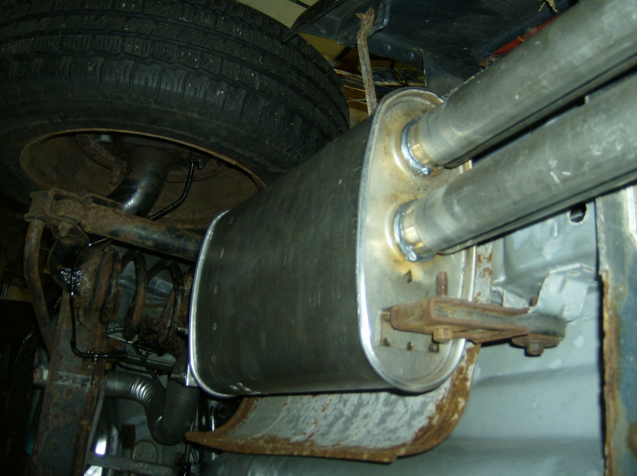

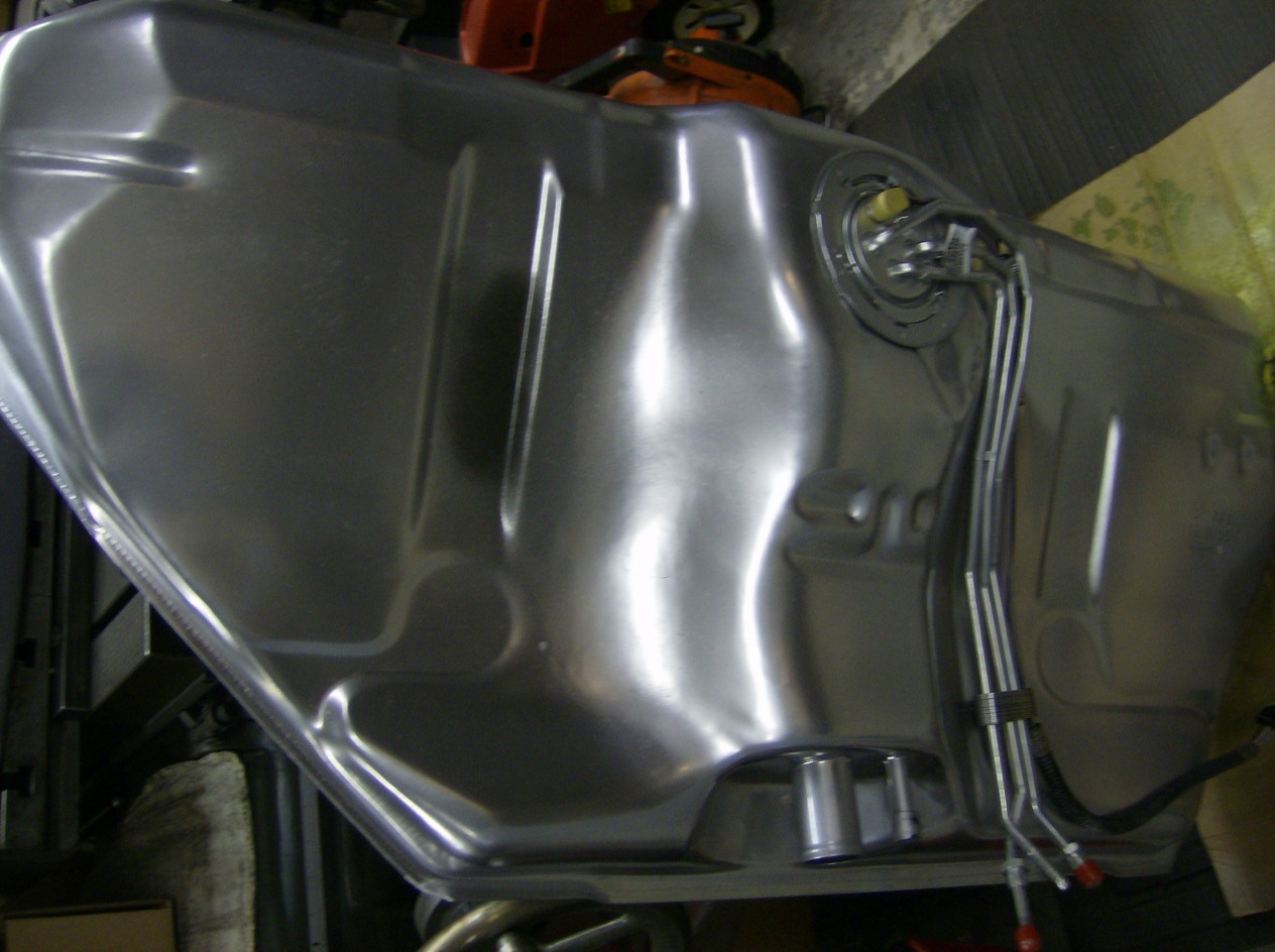

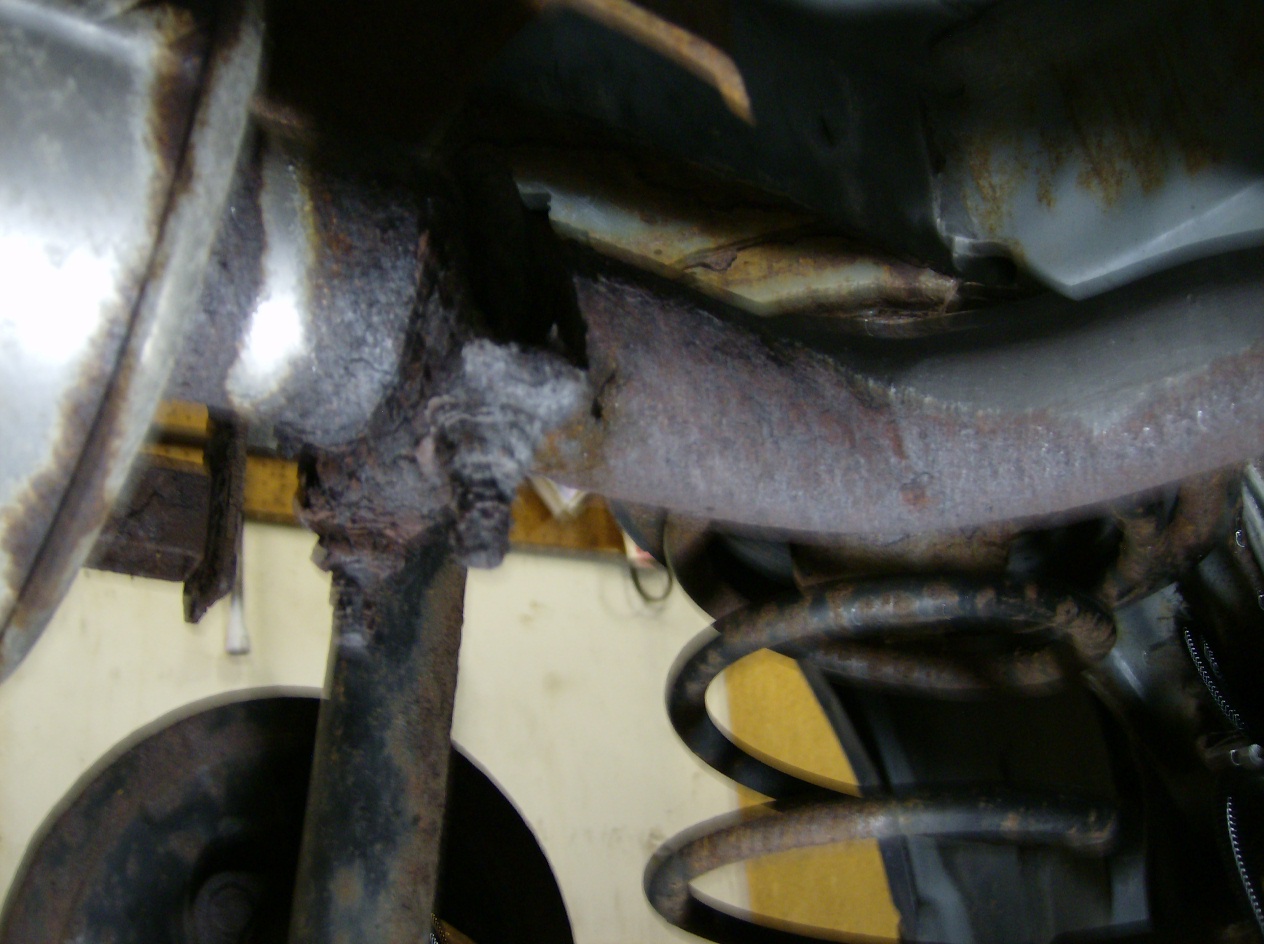

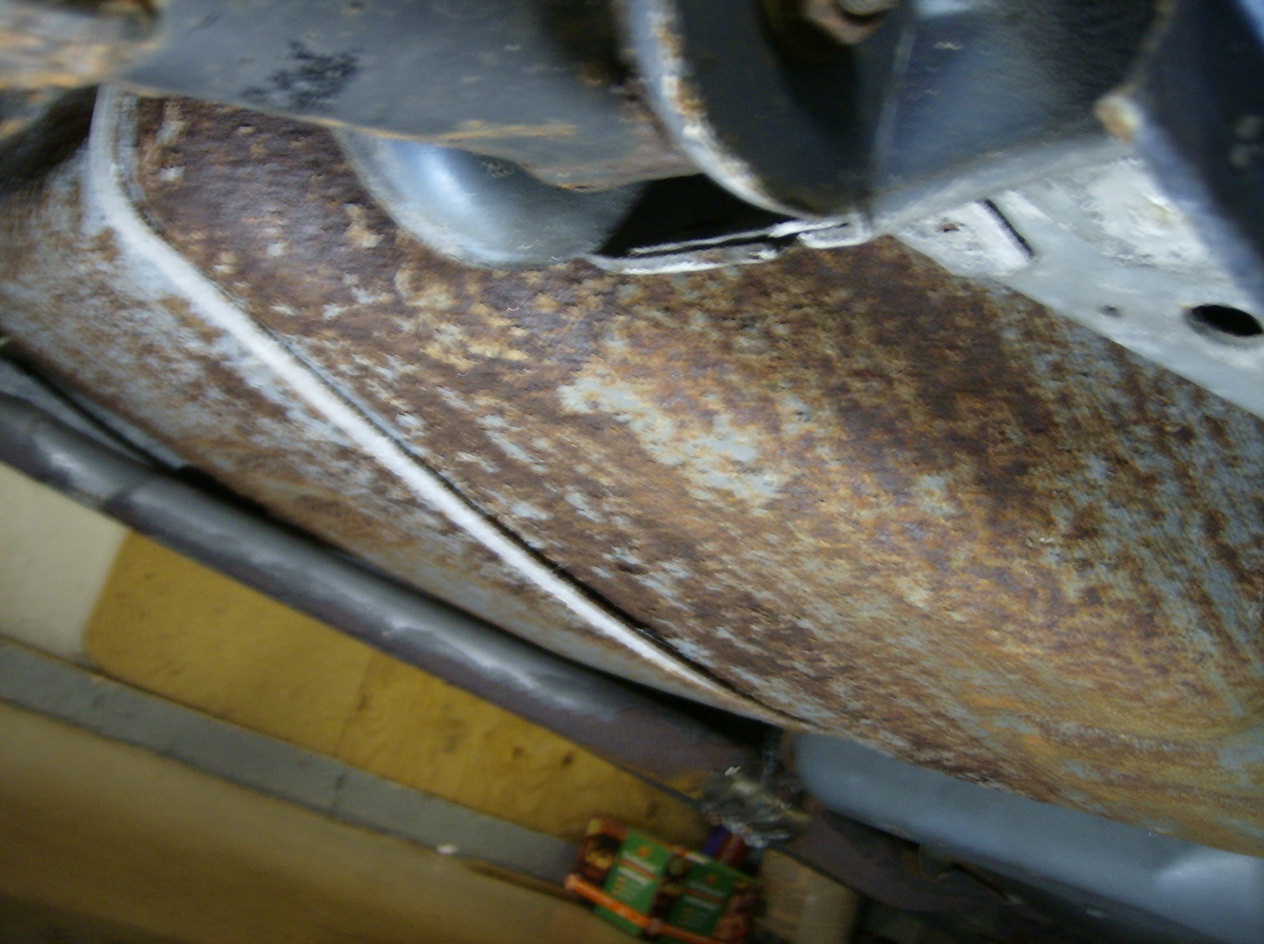

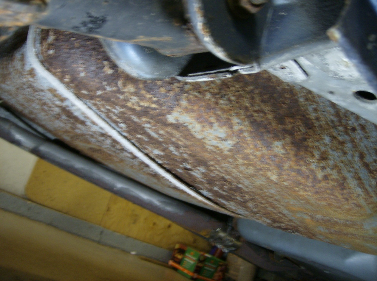

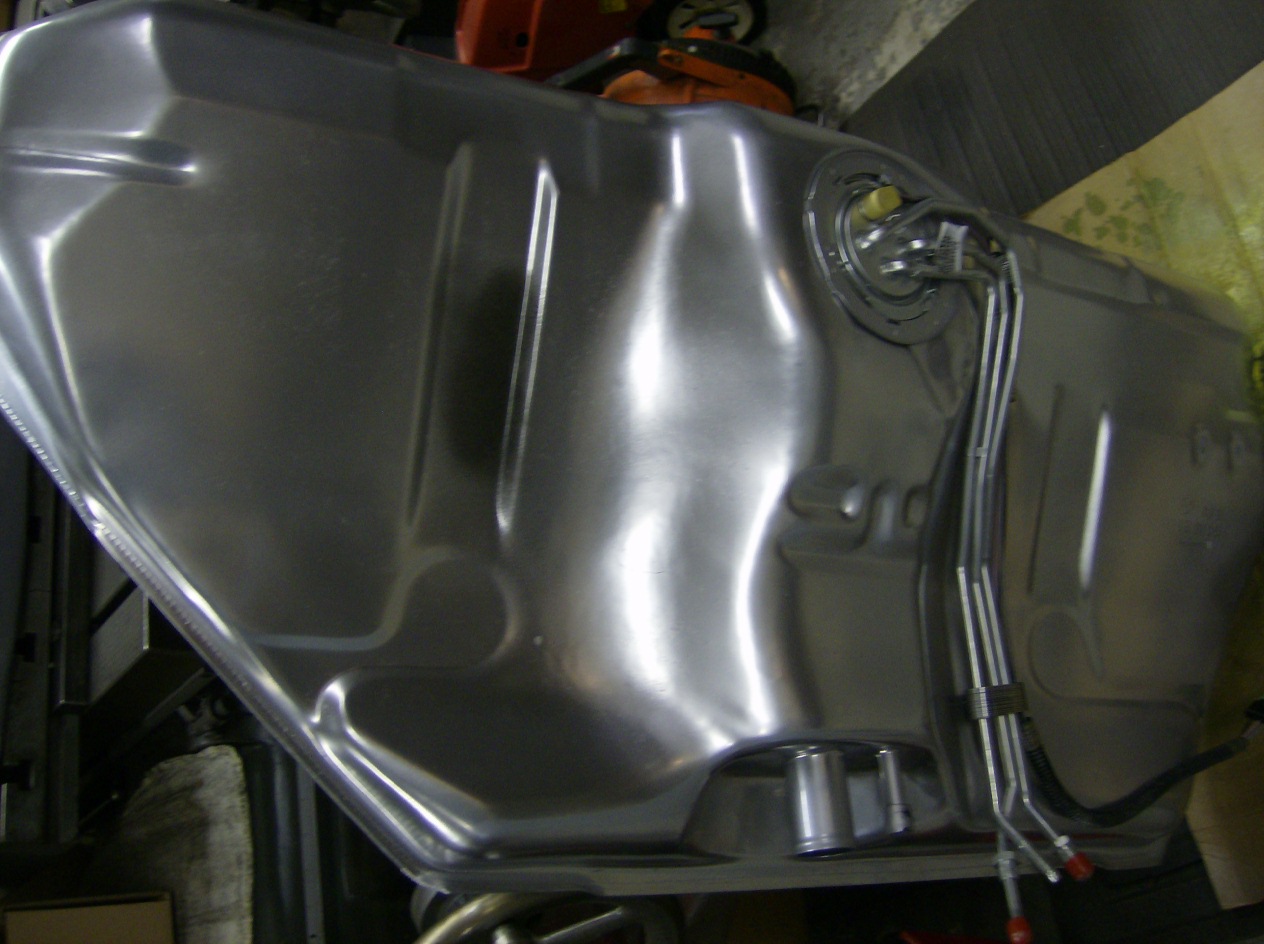

Fuel tank, lines and exhaust system were sooooo rusty.
Rear brake lines were shot too.
All are new now.
All are new now.
Woohoo! Looking good, for some reason I am always impressed when people fix the basic necessities of the cars, like suspension bushings, door hinges, brake and fuel lines, gas tanks... I guess it shows dedication to actually keeping the vehicle functional, not just looking or sounding good... Nice work.ifixalot wrote:Fuel tank, lines and exhaust system were sooooo rusty.

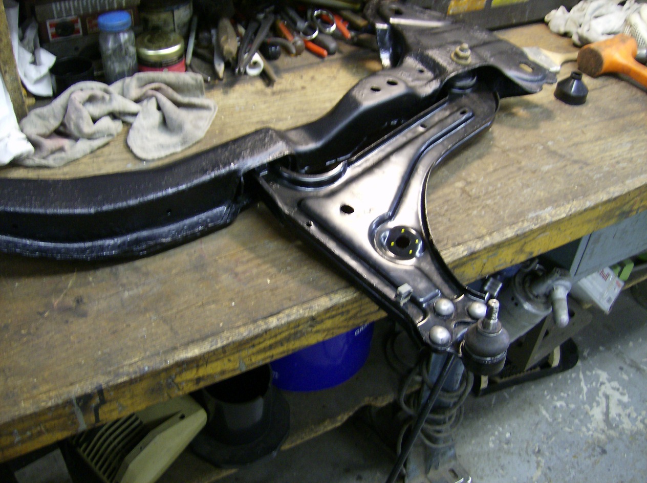

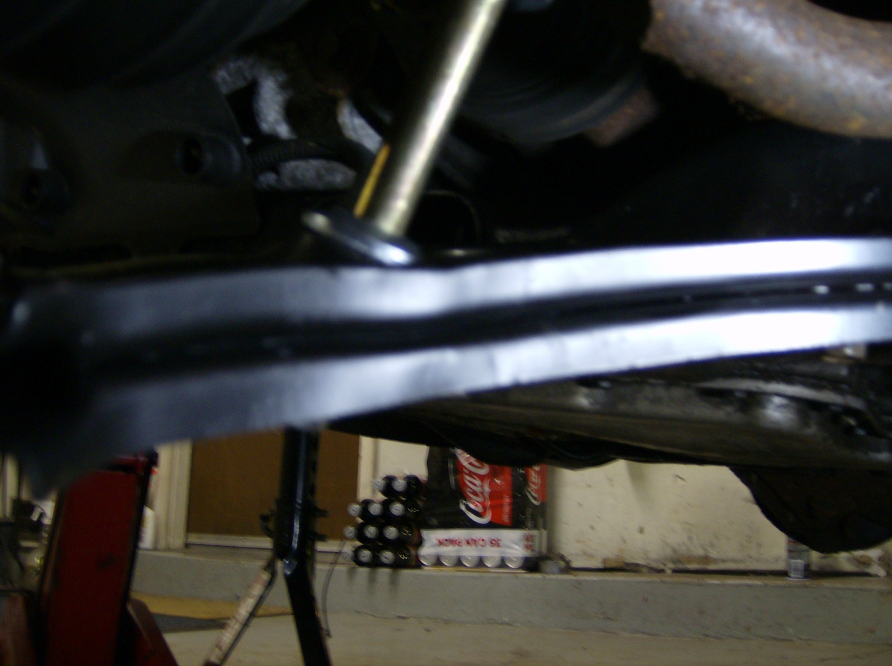

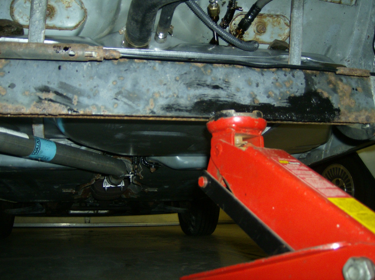

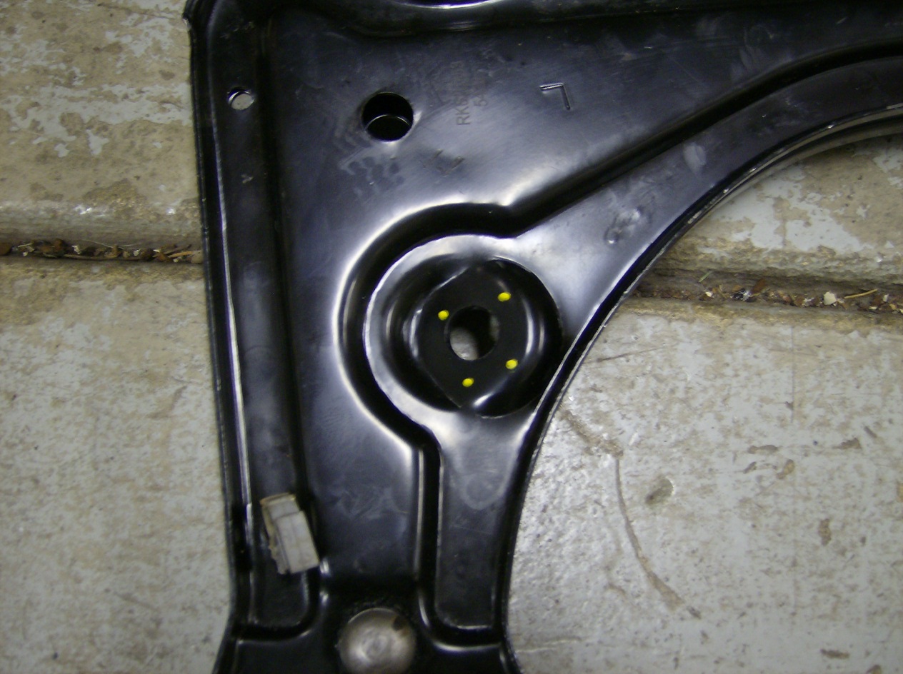

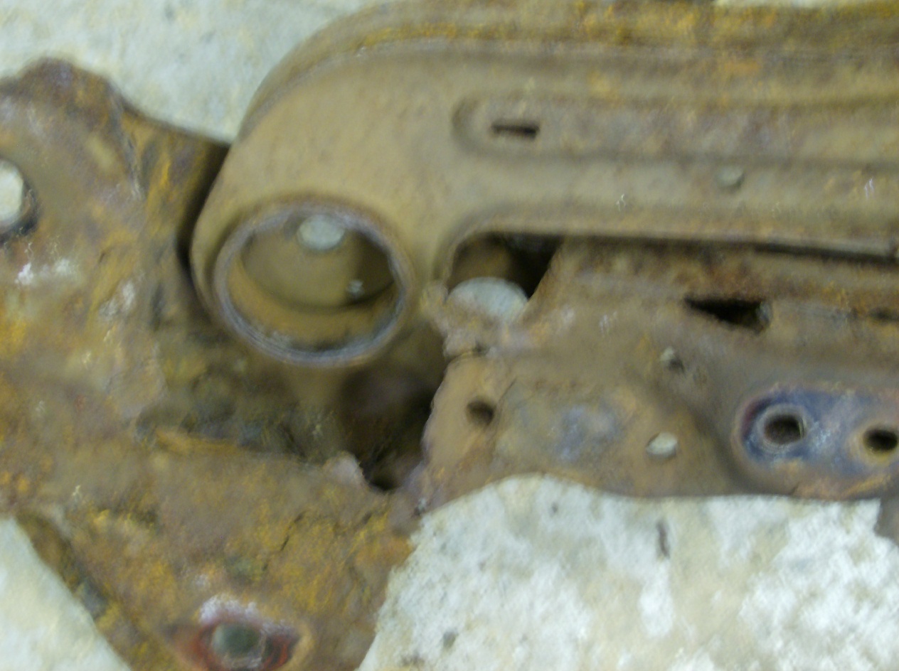

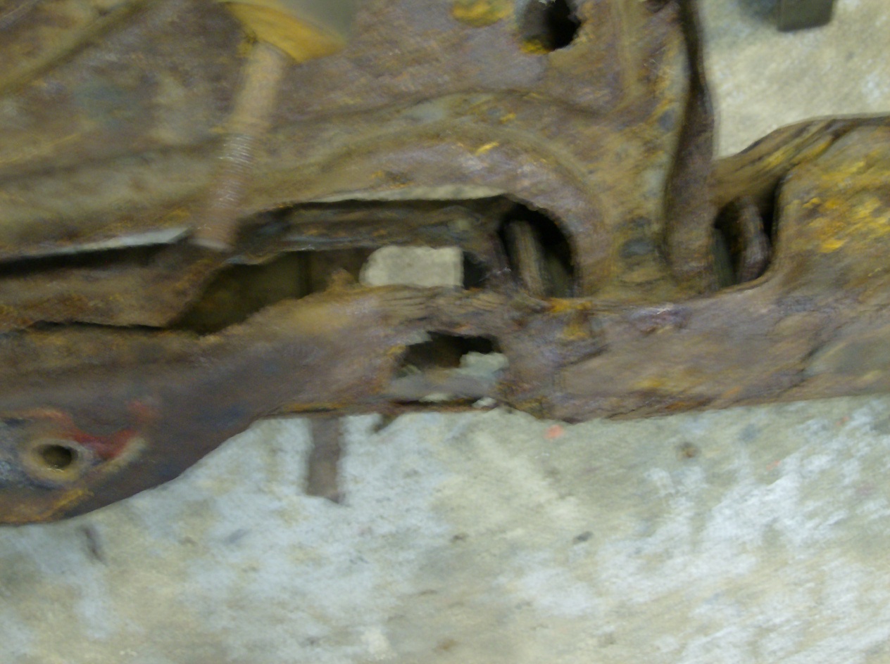

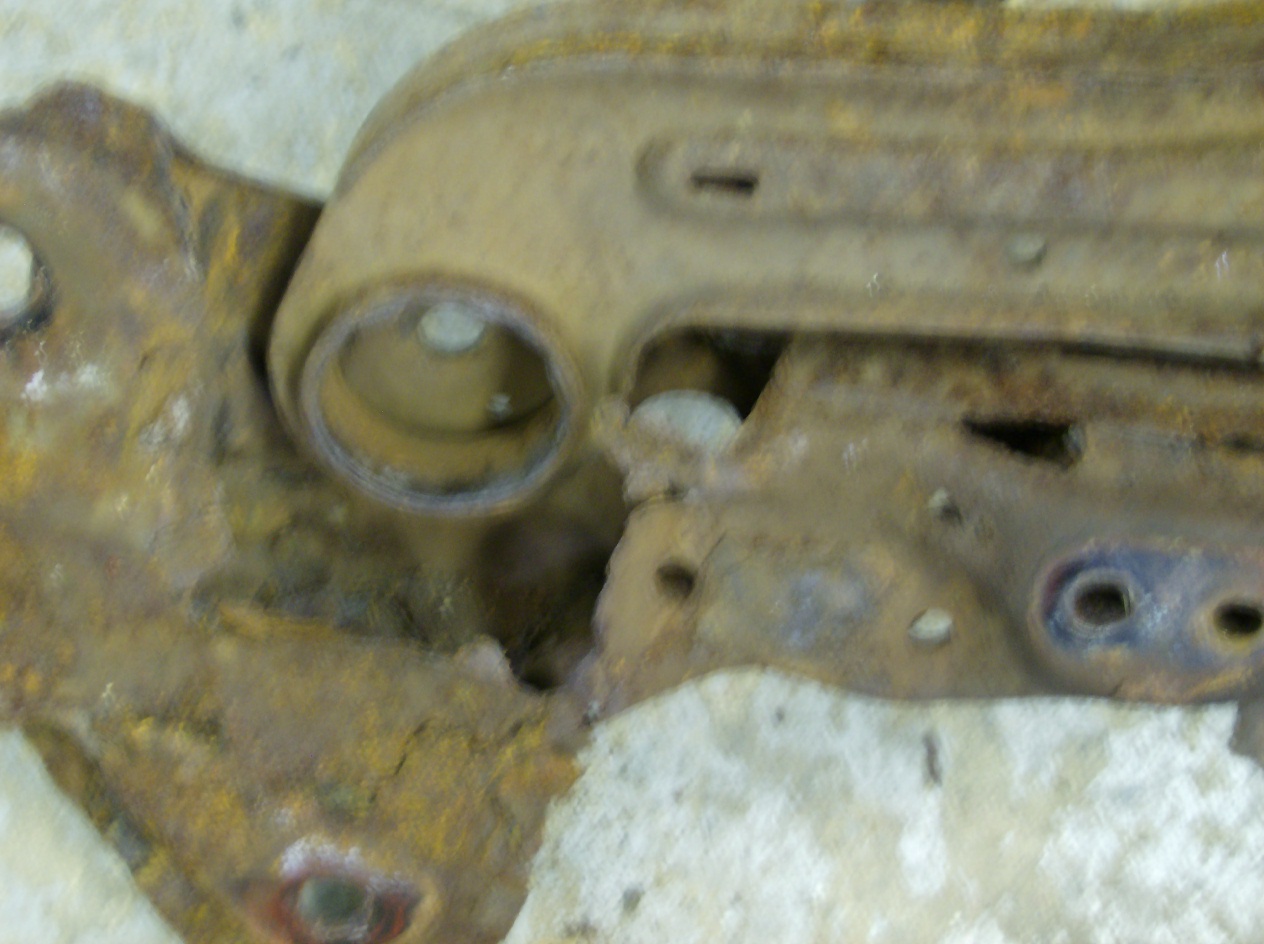

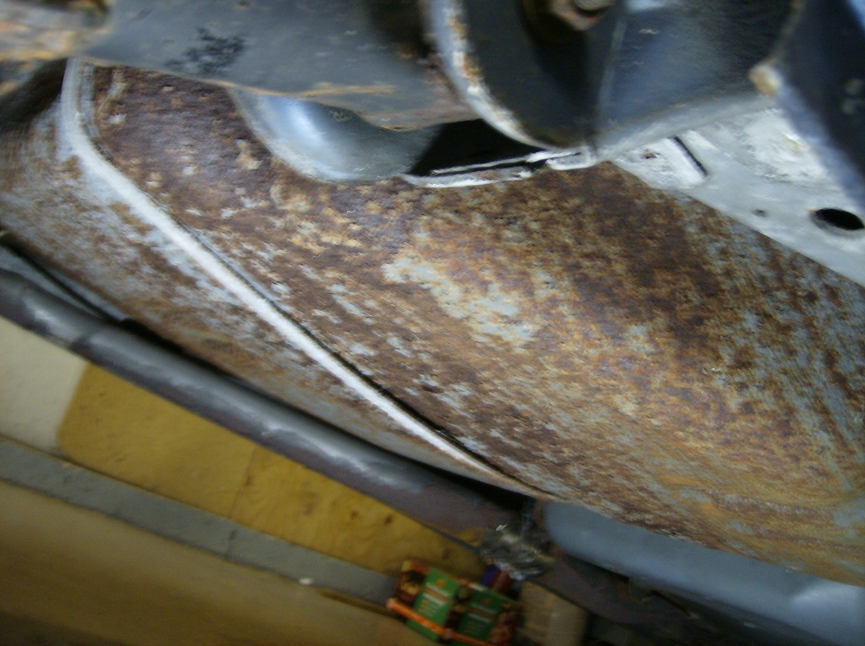

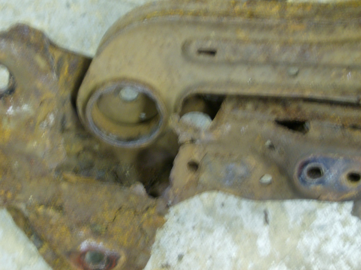

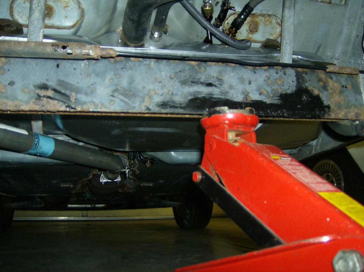

Couple weeks ago I saw the driver's side frame section was terrible. So I sought a good used one and ordered other parts for the swap.
I put those in yesterday and the car dives fine so I guess the alignment isn't off by too much. I did have a big problem with new control
arm that I got from RA. The stabilizer bar anchor point was backward and somebody else had seen that and put 4 yellow paint
dots on it and sent it back. Vendor just sent it back out to me. So I'm midway into this project and no local auto parts stores stock this part.

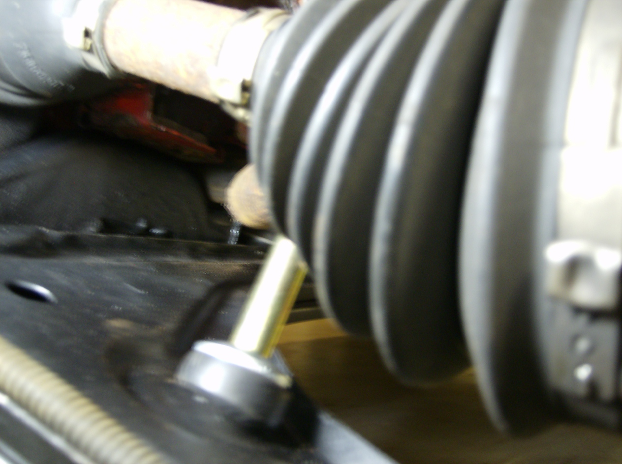

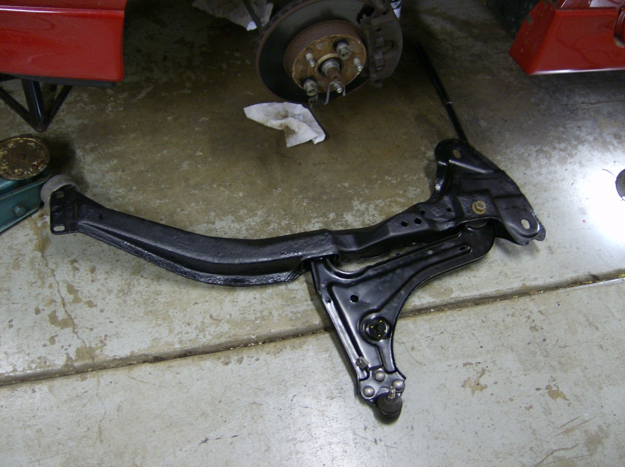

So I wound up heating that area and smacking it with a hammer over some pipe and other anvil type stuff. After a lot of banging I was able to get
it pointed in the right direction. (I've had a bunch of crap parts sent to me from more than one vendor lately.)
After my modifications, I primed and painted it. I was also able to install new upper stab bar bushings that went bad a couple years back.
Once the old frame section was off the car, I was shocked at how bad it really was. Good thing I didn't drive that car much.
!!!!!!!!!!!!!!!!!!!!!!!!!!!!!!!!ALWAYS CHECK EVERY FRIGGEN PART YOU GET THOROUGHLY!!!!!

Such a shame, but you've done everything you can to keep it on the road. I also can't believe how rusty that frame member was, wow!!! Hate to see these cars go, but those of us in the rust belt: it's gonna catch us sooner or later.ifixalot wrote:I posted the running driving 96 For sale on Craigslist for $700 after fixing the frame support and control arm.
