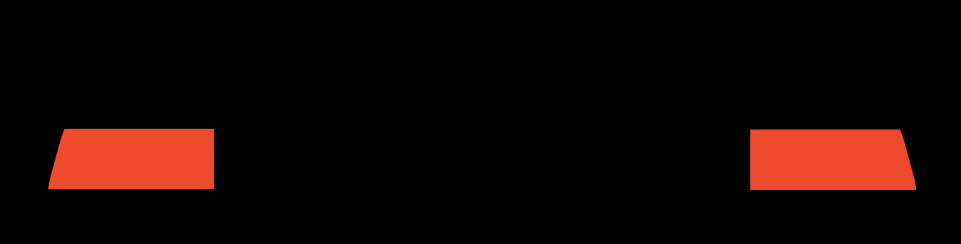

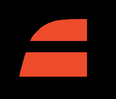

Re: wiring us-taillights: schematic plan
Posted: Tue Oct 09, 2012 7:00 pm
by berry
...this is what I already have:
and this is what I'd like to get: :D
3X00-Modified wrote:Sounds like he's trying to ditch the amber lens all together...

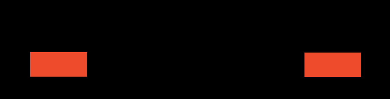

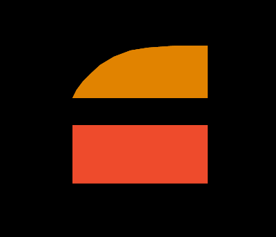

Posted: Thu Oct 11, 2012 5:31 pm
by berry
yeah, you are right. but there is a little difference between "original" euro:
and the "remake" of euro taillights:
I like the "remake" much better than the "original" euro tails
I'm sorry, I can't sell them, because every two years we have these controls in switzerland :crazy: I should better keep them.
SummitBalt08 wrote:Usually its the other way around.. everybody wants the euro tails. Want to sell your euro taillights?
Posted: Fri Oct 12, 2012 7:50 am
by 3X00-Modified
Good call Rod... I just installed one of these on my wifes Impreza because her car has tails and blinkers so to get the single trailer light to work you needed this.
http://www.hiddenhitch.com/content/prod ... %20&part=0
You can install it and then it will run the car lights after you wire to it... and then you could in theory quickly uninstall it if you have to pass a special inspection with those euro lights.
And your diagram is actually wrong, the tiny corners you added to the tail part do not get brighter when the brakes are applied, they are only 194 running lights in that area so they are constant brightness.

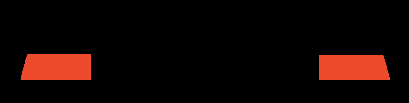

Posted: Mon Oct 15, 2012 8:05 am
by berry
thanks! i'll buy the converters asap and give you an update.
is the new diagram now right?
3X00-Modified wrote:Good call Rod... I just installed one of these on my wifes Impreza because her car has tails and blinkers so to get the single trailer light to work you needed this.
Posted: Mon Oct 15, 2012 9:50 am
by 3X00-Modified
Yeah that's what a "euro" addition to US lights would do...
