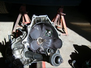

1) The photo of the v6 Manual trans, I'm wondering if this is how it looks on the 1988 Beretta.

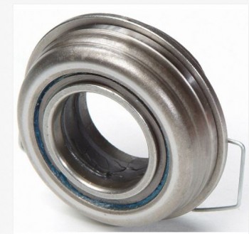

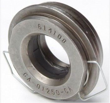

2) The photo's of the 2 bearings, I'm not sure which one is right, Both keep popping up. (The existing bearing in the 88 is getting cut into/grooves in the back of it from the clutch fork). However, I do not know what kind of bearing is already in the vehicle.

This is Manual 6 SPD transmission For the Beretta 2.8, 3.1, 3100 v6 engines. What year or series, I do not know.
V6 Manual Transmission
I found 2 types of bearings. I do not know which one is correct yet.
Bearing 1:
Bearing 1 Front
Bearing 1 Front
Bearing Front.JPG (19.22 KiB) Viewed 5785 times
Bearing 1 Rear
Bearing 1 Rear
Bearing Rear.JPG (16.71 KiB) Viewed 5785 times
Bearing 2:
Bearing 2 Front
Bearing 2 Front
Bearing 2 Rear
Bearing 2 Rear

There is no fork installed in the transmission picture. Looks like that may be the 92+ version with the hydraulic throwout bearing. Bearing 1 matches up to the fork you posted, which is the 90-91 style. Bearing 2 I do not recognize...it may be the 87-89 style. I do know that the fork you pictured is incorrect for an 88. I have an 87-89 parts trans I can snap a pic and show you that design.

I know for sure the 1988 Beretta That has the problem, it has a fluid piston for the peddle, and another one for the clutch fork to move.
In that photo (Its not my photo, I found the photo online off a Beretta, was not labeled what kind of trans or year). The green circle is one side where the fork inserts, the other side is visible.
