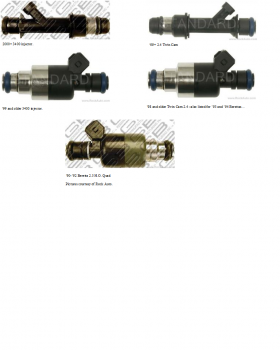

I did an engine-swap for a friend with an '03 3400 Impala several years ago, the replacement engine came from a similar-year Alero. The salvage-yard that sold him the new engine told him emphatically that his new engine used low-impedance injectors that would fry his ECU if the engine was going in an older car, so I was basing my knowledge in part on that statement (I've also read on the ultra trust-worthy internet that the newer 3400s used low-impedance injectors) -but maybe there is a reason why that particular person was working in a salvage-yard instead of a mechanic's shop. :wink:
Here are some pics of various injectors applicable to this discussion:
Pictures courtesy of Rock Auto
Of course, none of this is proof of high vs low impedance -a multi-meter will prove that to me one way or another.*
It also does nothing to inform regarding flow-rates, sorry.
*Edit: The general concensus does seem to be that the Quads are low-impedance (high amperage/high current) injectors -and there are a lot of people here who know a lot more about that than I do, so sorry if my oar is rowing backwards here, I was just trying to clear something up that seemed wrong to me. Thanks for the input guys.
