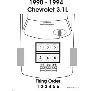

I also suggest checking spark wires are correct.
And vacuum lines, sometimes they can fracture and cause bad running because they opened.
Pairs are in the image below:
