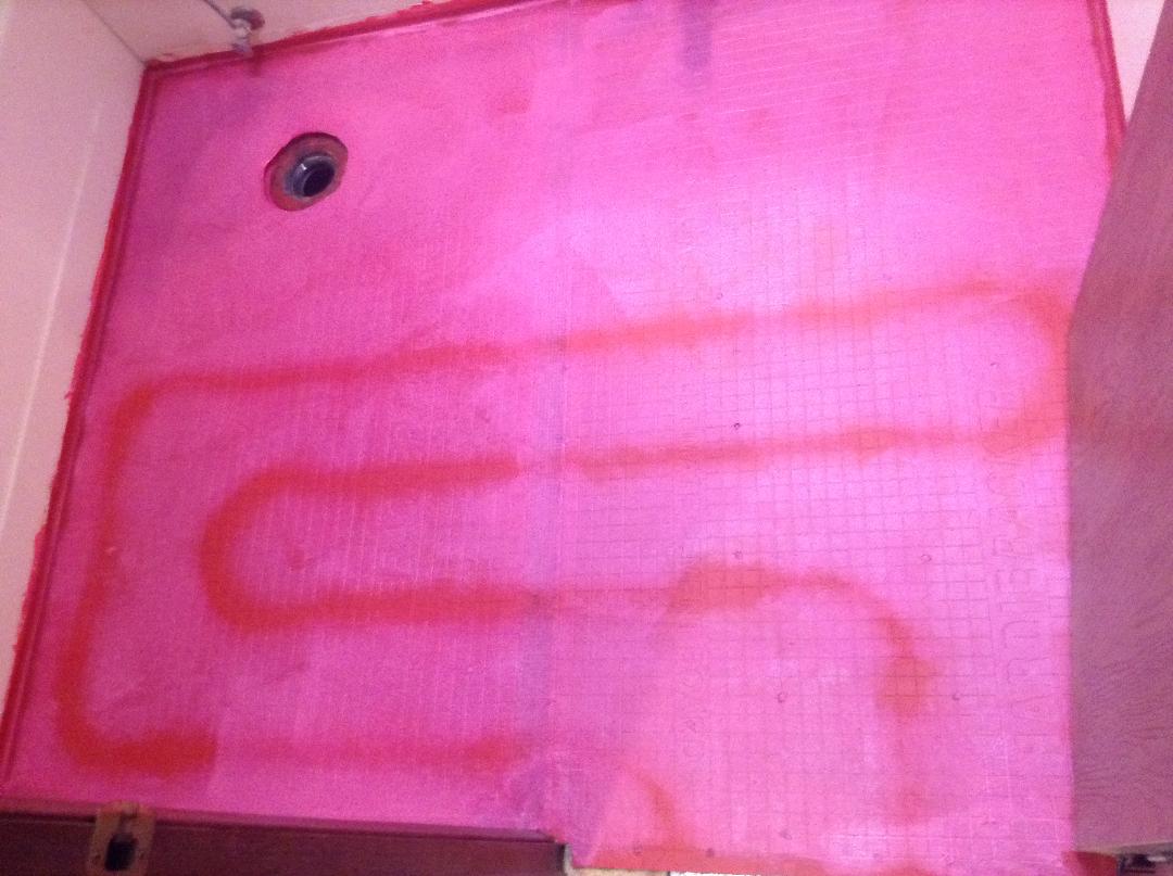

Just a quick update to this for anyone who may be curious. After comparing our electric bills for the past few months to those from last year, our heated floor is costing us about $200 per month to operate in the colder months, but is SAVING us nearly $100 per month in propane heating costs. Our house is overall a little warmer feeling (it is actually quite cool, but doesn't feel that way at all due to the more efficient heat transfer), and when we visit other houses without heated floors, we find we are spoiled rotten -everything else just feels uncomfortable and cold, no matter how warm their house is.
Here are a few shots from when I did the first bathroom floor back in November...
- I used Red Gard -this is a water PROOF membrane. 100% protection from water damage, and fantastic adhesion for thinset mortar. You can see where the heating pipes are, helping to dry the Red Gard.
- We decided to have some fun with the vanity, and did a crackle-finish on it. We will be doing a conventional two-tone stain in the other bathroom. We also intend on epoxy-coating the counter-tops to change the coloration and freshen them up. SOMWHERE I have a few slabs of green marble and blue granite that might work well here, but I think the epoxy color-coating will be better. I still have to trim-in the baseboard tiles here.
I can't say I am crazy about the operational cost, but the effect is worth it.
