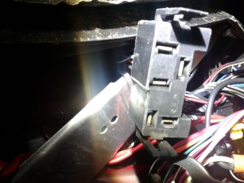

![20200221_180601.jpg (1.65 MiB) Viewed 20463 times Relay under steering](./download/file.php?id=7230&t=1&sid=fb3393ba38b62e183ff67fc969105eb1)
- Relay under steering

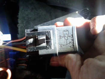

![20200221_180620.jpg (1.23 MiB) Viewed 20463 times I think was main relay](./download/file.php?id=7231&t=1&sid=fb3393ba38b62e183ff67fc969105eb1)
- I think was main relay
