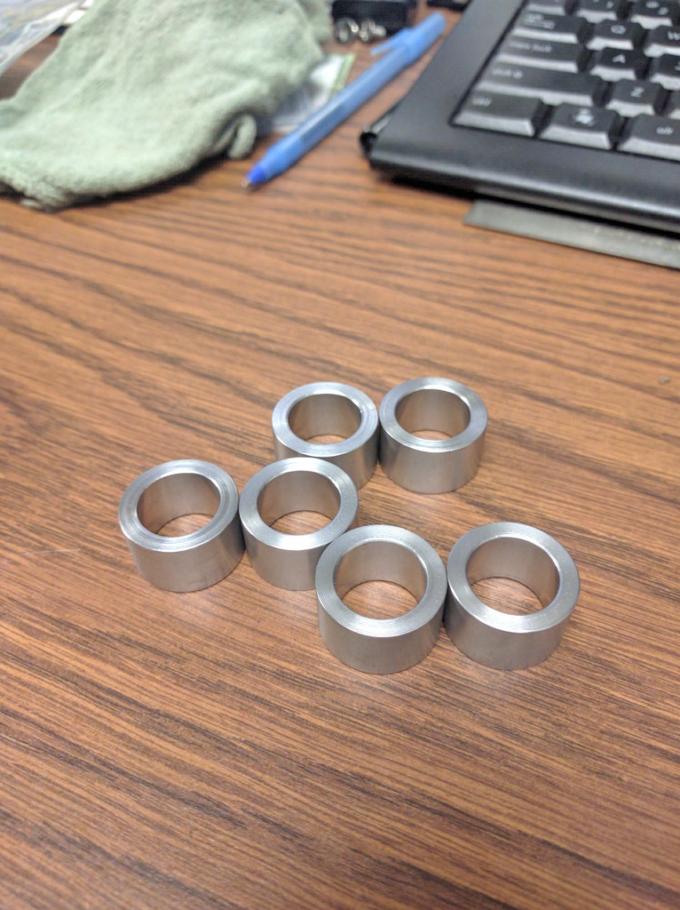

If you can find them J-body Inserts that you can use in a regular front strut housing for a Beretta with bushing I designed or something else to space it properly.

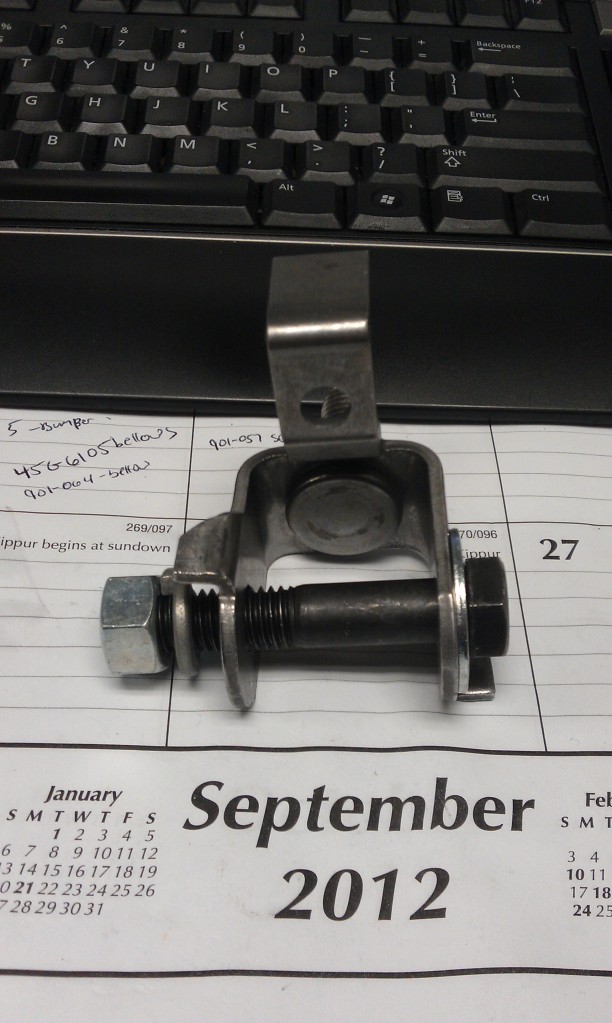

To use the Thunderbird shocks above you will need to purchase some cheap aftermarket shocks they come with a lower bracket to mount them. Just narrow the collar on the shock by a tiny amount to fit this width and your good to go. Only difference between the Saab's and these Thunderbird ones is the valving is a bit more aggressive and the lower mount is a 14mm bolt vs a 10mm bolt.
Lower bushing is also 41mm wide vs 36mm. Hence the need to narrow it to fit the bracket.

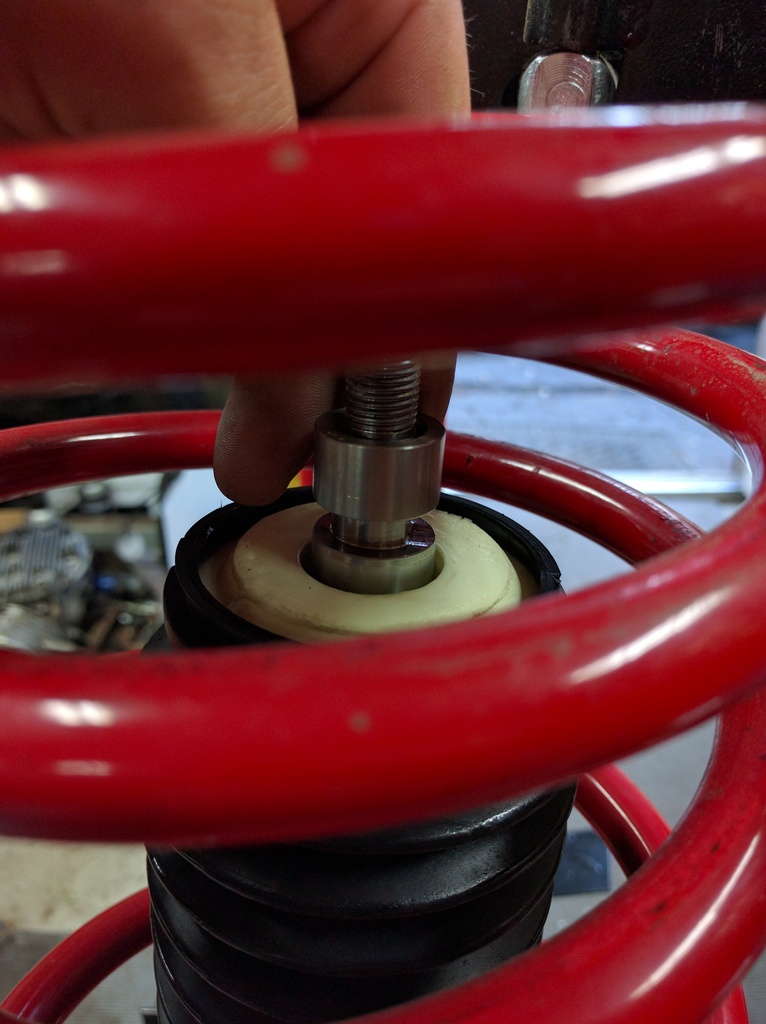

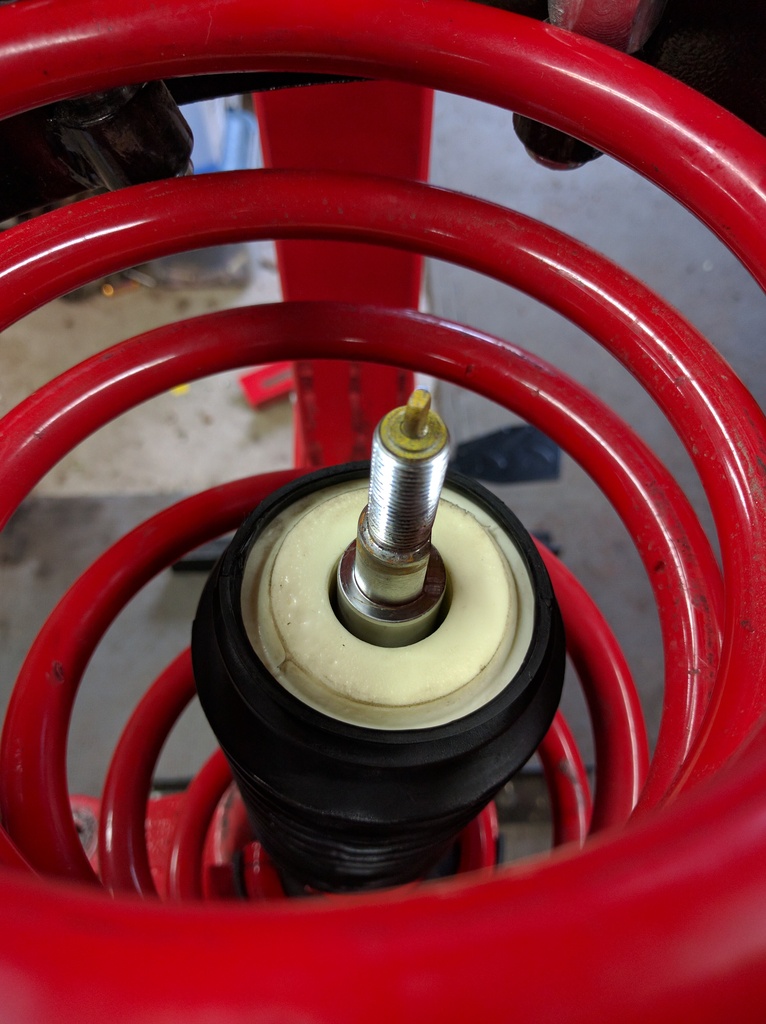

Procedure for front strut build is below, I have more photos towards the end of the thread with my custom bushings I made.
