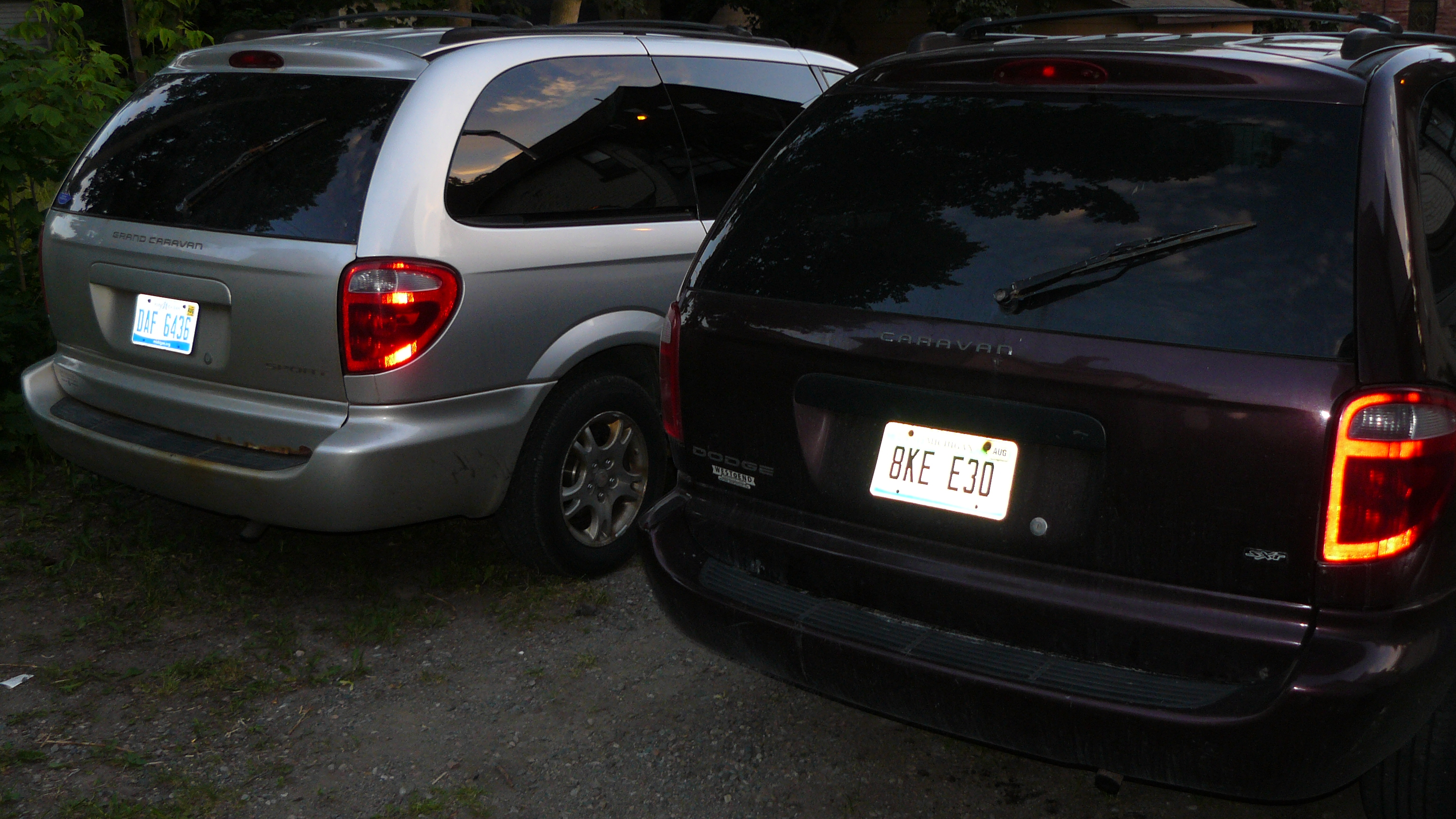

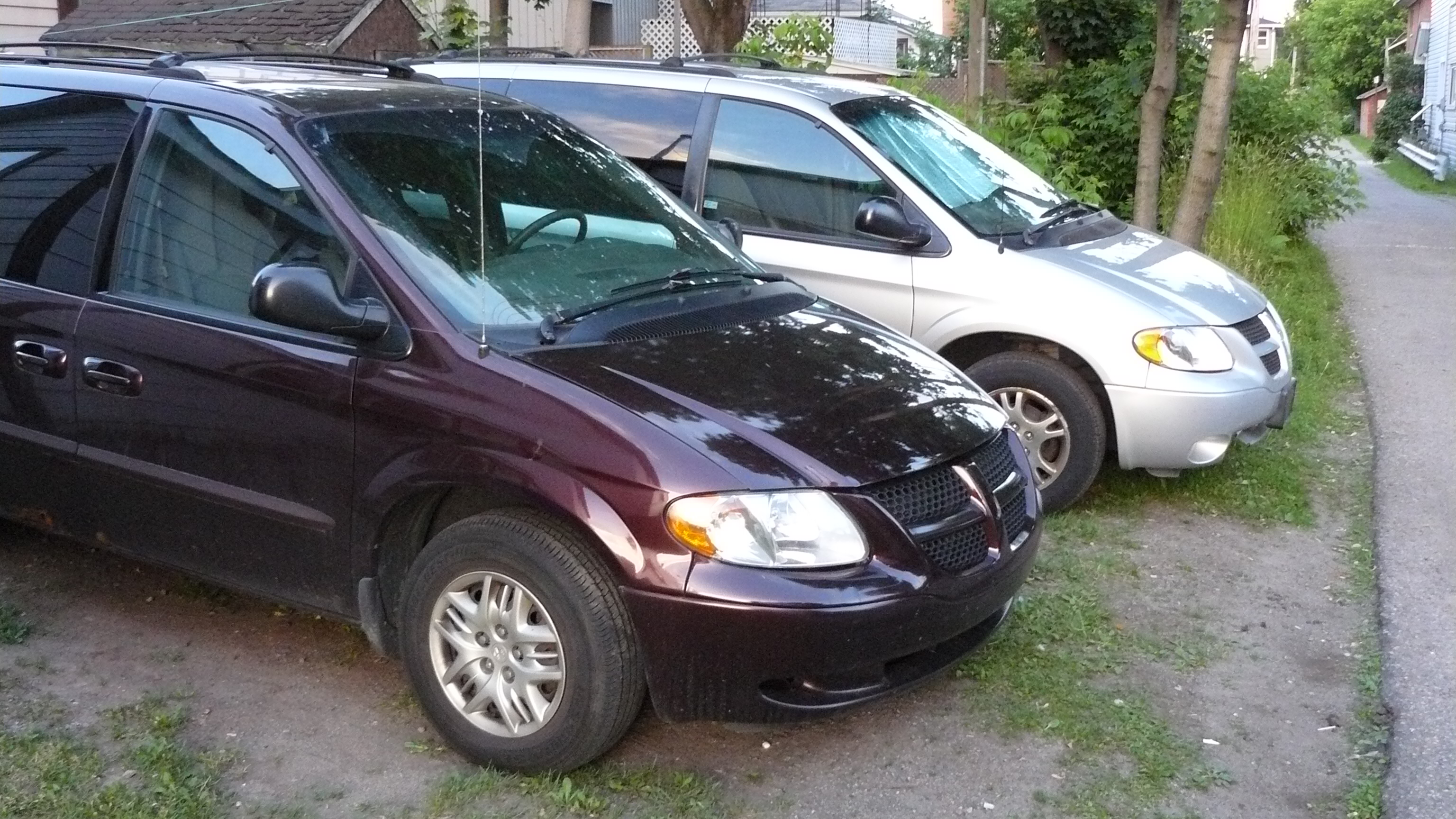

Pics for you all. Sorry, they are links. Took shots of both the 01 and the 03 (red molten pearl)
