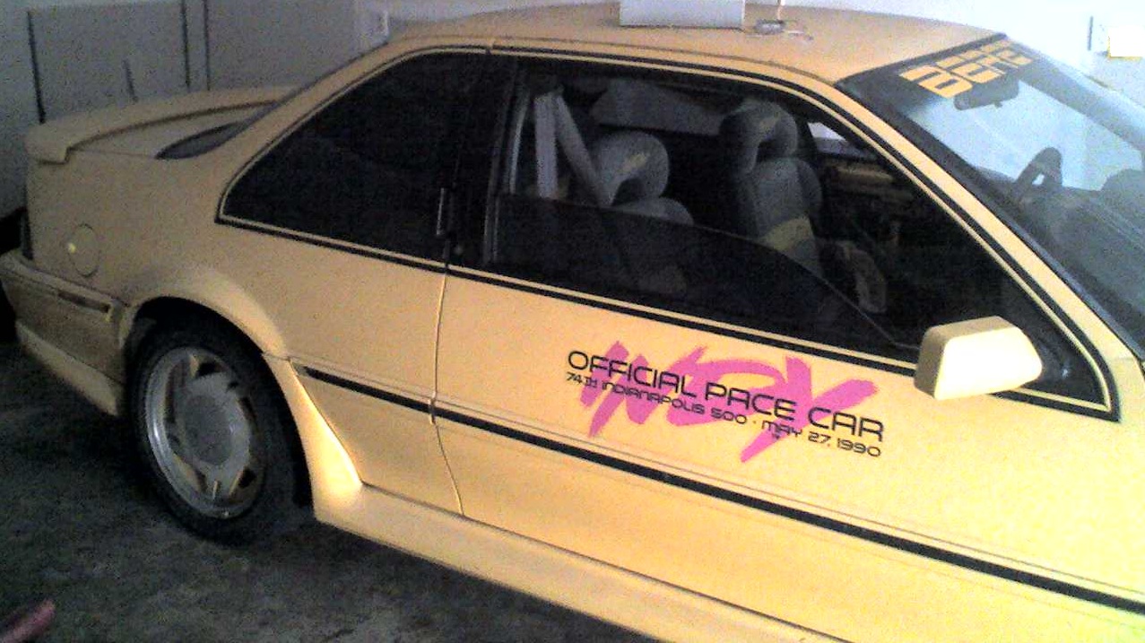

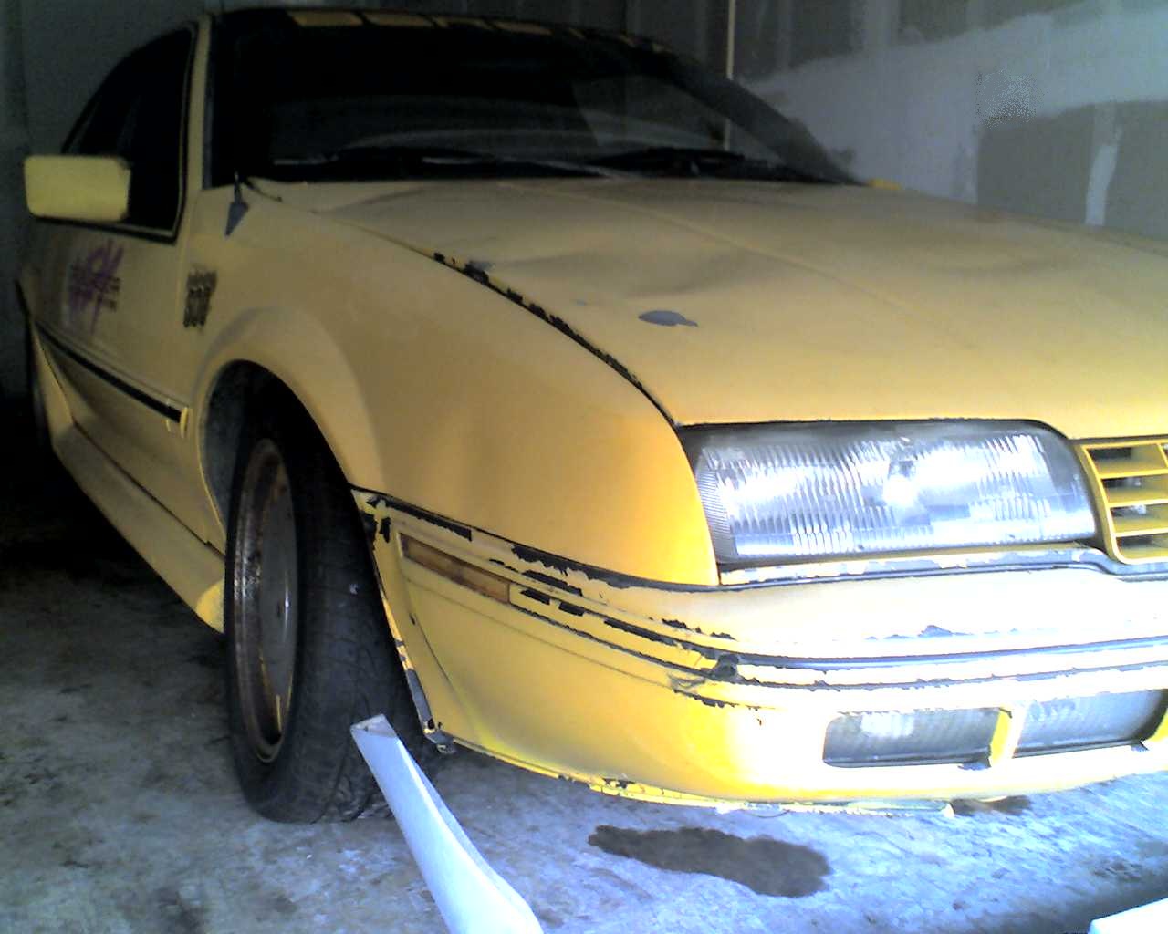

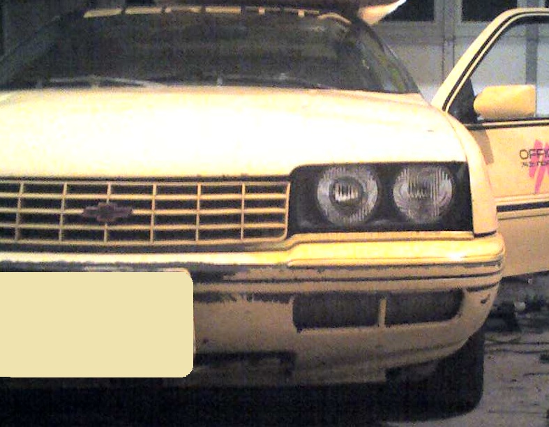

Okay, so I've wanted a yellow Indy for quite a while now, and I've never really had a good opportunity to buy one close to me or for the kind of money I would spend on one. Along came this car, for a fair (if not great) price, needing repair to the driver's seat, reinstallation of the driver's side door panel, a new hood, possibly a new front bumper-cover or at least some body-work to the current one, and a new paint-job (about half of my cars need that). Mostly, it needed a new wheel-bearing up front, the head-liner reglued, and a serious interior cleaning. You can see the small twist in the left-side upper radiator core-support, but I think I can push-out the faint dent in the passenger-side fender. The dash has the usual front-end peel, some slight distortions, but is uncracked. It still has the chin spoiler, which looks like a replacement from a GTU, but it will need serious help before going back onto this car. The car came with oodles of spare Fel-Pro gaskets, spare headlight and tail-light, spare digital instruments, a few spare drive axles (a pair look new), and a spare NOS "BERETTA" windshield banner. It even came with the original owner's manual and a clean Chilton's book, perfect timing as I was ready to buy one to supplement/replace my old Haynes manual that is finally falling apart. The engine was replaced some time ago, and now has ~50k miles on it, while the car has 150k total. It starts and seems to run great, and has very healthy oil-pressure. Unfortunately, it has an automatic (for now) that is overdue for servicing, and does not have the sun-roof I wanted in my next Beretta. It also has power windows and locks, like my other Indy and my GTU (and my old Z-26, for that matter), and I honestly prefer the manual windows in my '90 turbo 'T-Type' 'Retta.

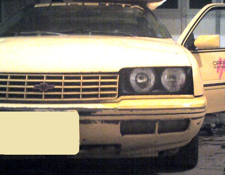

The front needs some cosmetic help.  The angle of the wheel also shows how bad the bearing was.

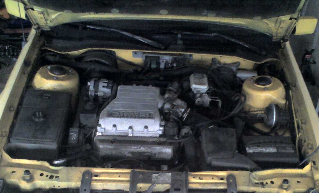

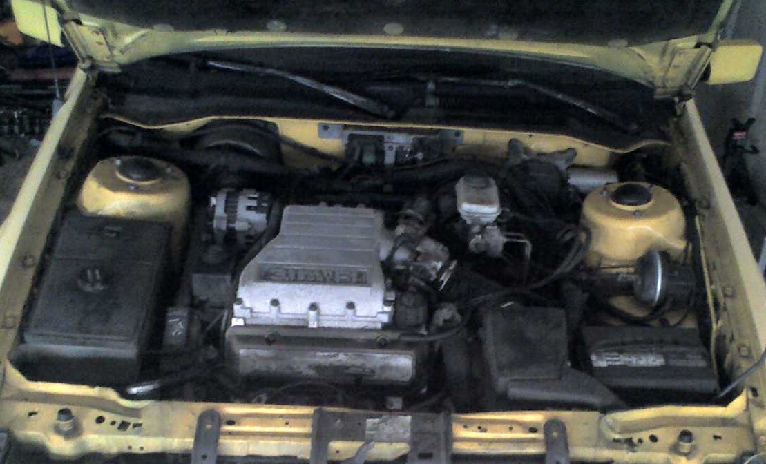

Nothing too special in the bay, but everything is where it is supposed to be.

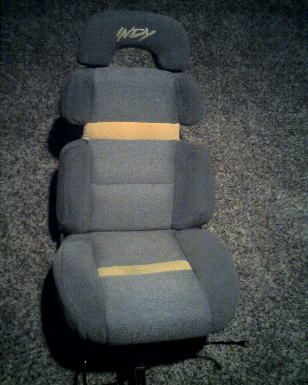

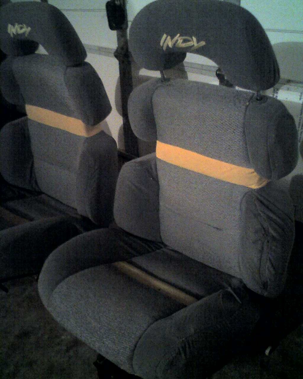

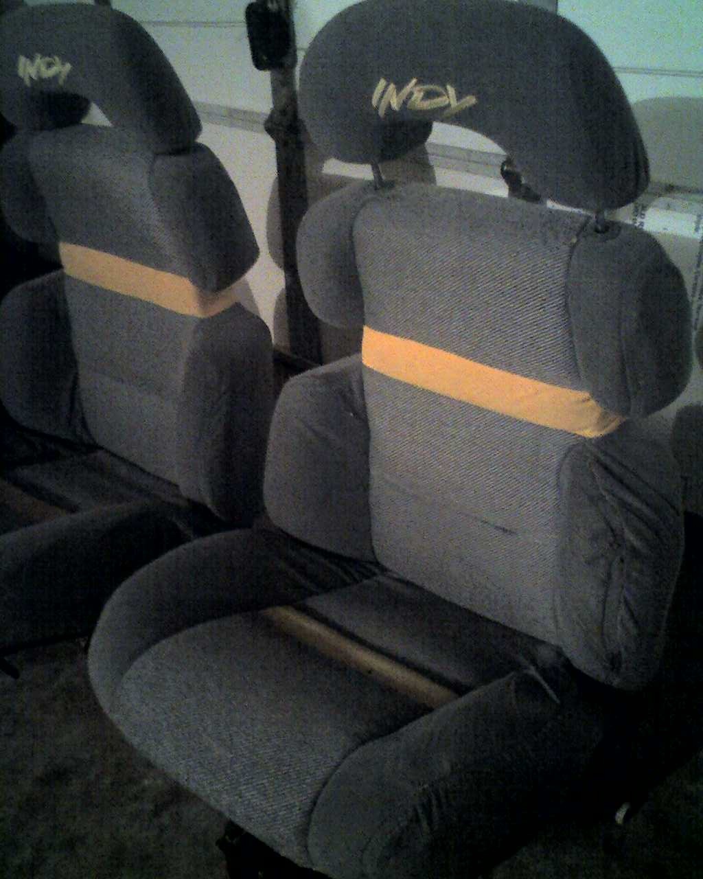

So I haven't had as much time to work on the car this week as I was hoping, but the passenger seat and rear seat-pan (bottom half) are finished (although the yellow stripes on the back seat could still use some help).
Front passenger-side seat cleaned and reassembled.

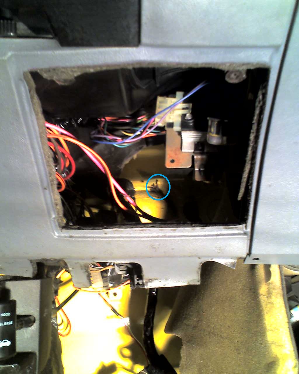

The failed interior lights seem to be caused by what my old Haynes manual refers to as the 'Remote Dimmer' (my Chilton's manual doesn't even have a diagram for the interior lights... :fool:), which is the component with the huge aluminum heat-sink attached to the so-called 'convenience center' under the dash by the steering column. I do have a spare one of these, still attached to the '90 GT black dash I have waiting for the teal V-8 Indy, but I won't be able to go get it for a couple more weeks, at least. I might take a trip out to a junk-yard instead, but I'm not too concerned about this for the short-term -I can always hot-wire the instrument lights like the previous owner did.

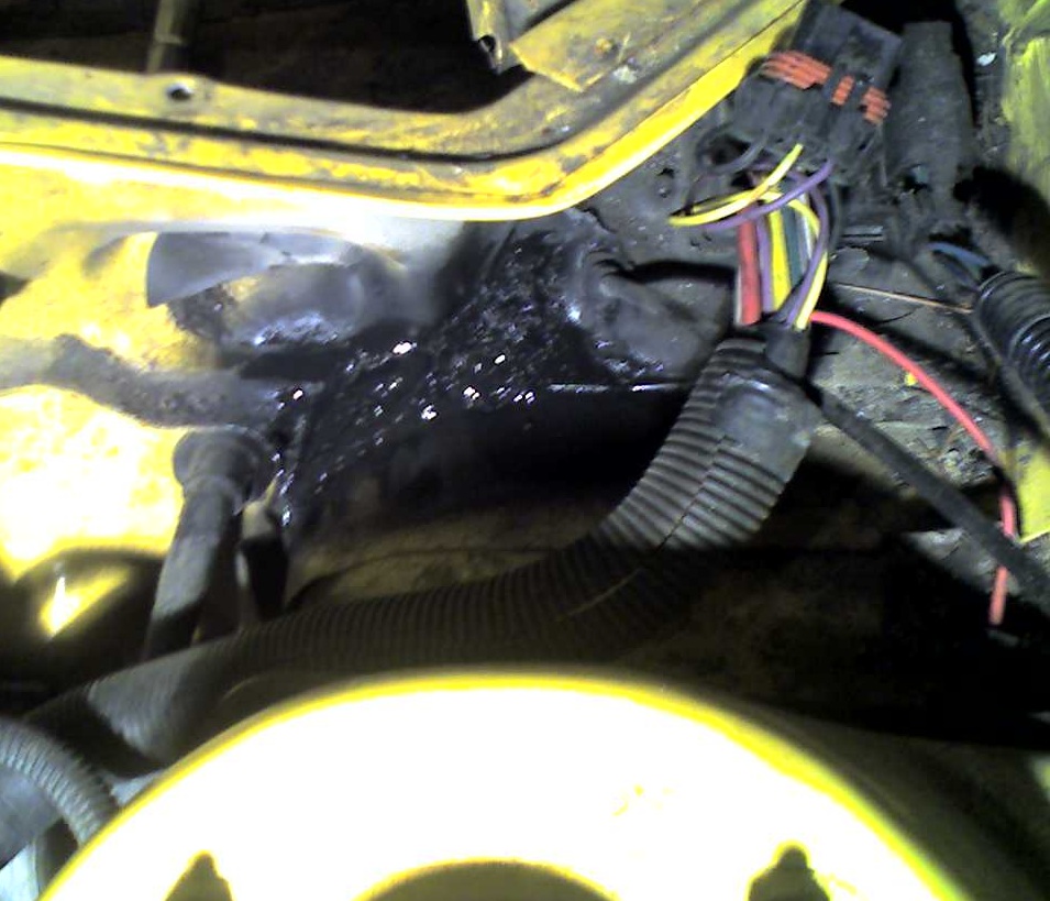

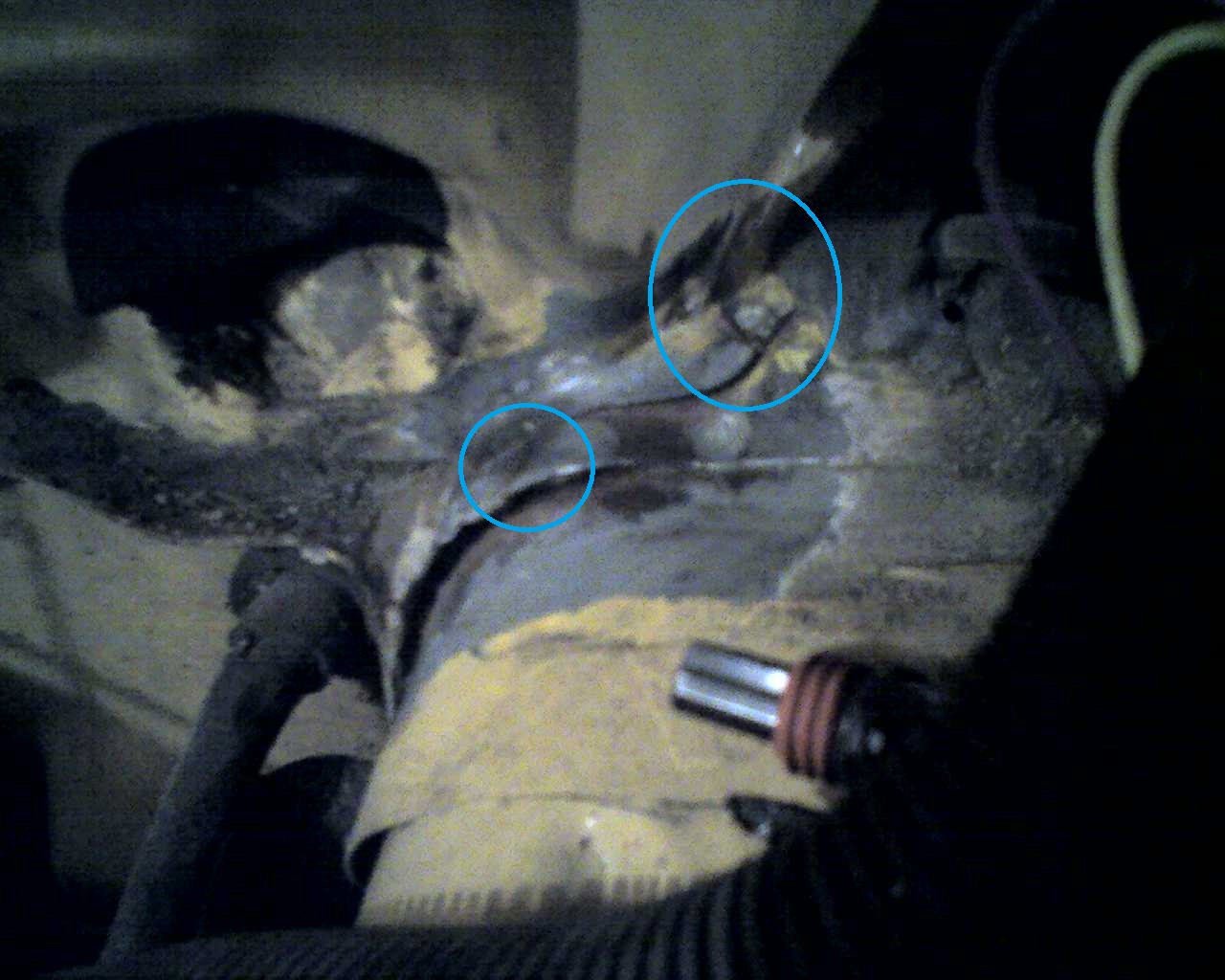

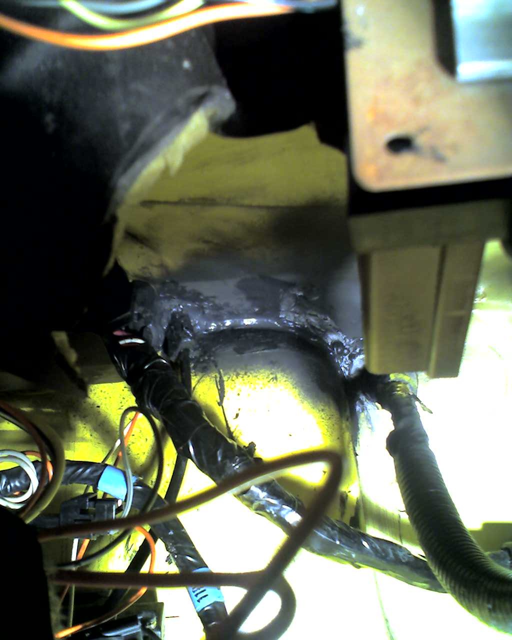

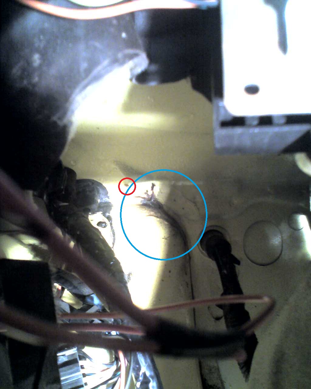

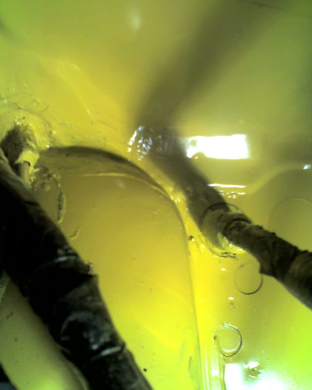

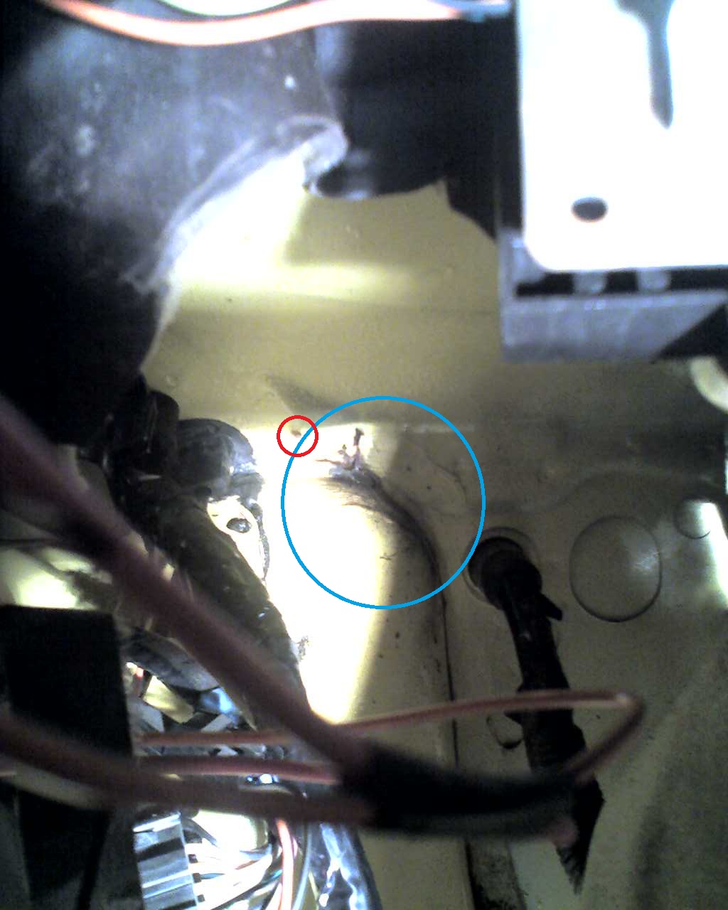

The firewall leak was caused by two small stress-cracks behind the left strut-tower, under the wiper-motor, and failed body-seam sealer in the same spot.
Leak is in the aqua ring -a spider that failed to hold the crack secure with his/her web is in the red ring.  He/she was evicted for the web's failure... ;)
This zoomed-out shot gives a better idea where this crack is, and the size of the spider (actually pretty small).  The failed instrument light 'Remote Dimmer' is visible here too.
The stress-cracks are barely visible in the rings.

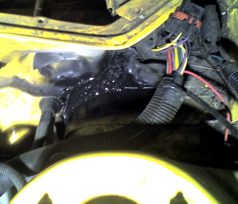

So it is coming back together. I'll probably end up going with the yellow carpet with grey floor-mats, and a custom yellow-banded grey headliner. There is a guy on ebay selling a set of Indy 500 Pace Car floor-mats, black with orange (or black) edging that would be PERFECT in this car with yellow carpet, but at $240, they are waaaay too expensive... Too bad.
After welding and priming (still wet), all it needs now is epoxy sealant on the inside, and silicon sealant on the outside, and the repair will be done.  I'll also have to re-seal the hood-release cable due to the heat from the weld.
Posts: 1828
Re: Yellow Indy Joins Family!

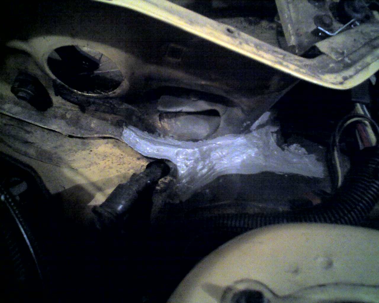

Haven't updated for a while due to the Holidays, and due to slow progress on the car, but the firewall leak repair is done, and all the seats are washed and reassembled, and I've driven the car around a bit more now. It still has a slight hiccup when touching the accelerator pedal, and it has stalled a couple of times -the IAC may be sticking a bit, or the idle may just need a relearn. Here are some pics of the firewall repair.
After welding the seam and its' two small stress-cracks and priming the area, I applied a high-grade automotive silicon to the outside of the area to keep it sealed.  If I have any trouble with this spot again, I will remove the silicon and go back to my original plan of using butyl-tape to seal it.
From inside, under the dash, I finally decided just to use a construction-grade flexible, paintable sealer on the inside.  I've used it before, but I haven't seen long-term tests on it yet, so we will see.
I let the sealant cure over the weekend, and topped it off with Rustoleum's "7747 Sunburst Yellow",which is darn near a perfect color-match for the car.

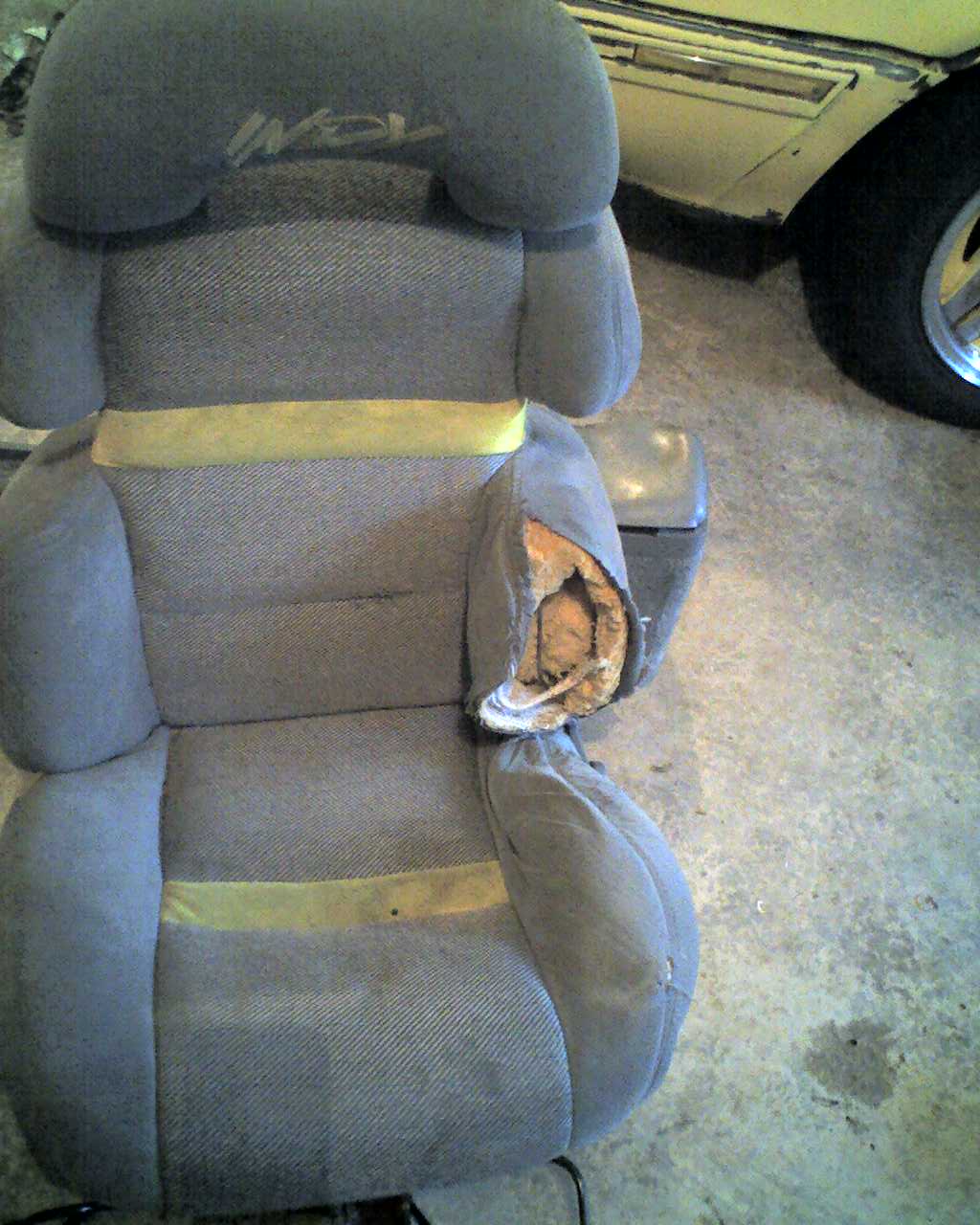

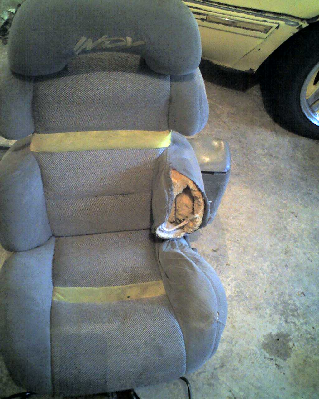

As for the seats, They are as good as they will ever be again.

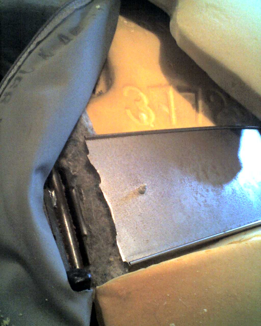

The driver's seat was almost toast...

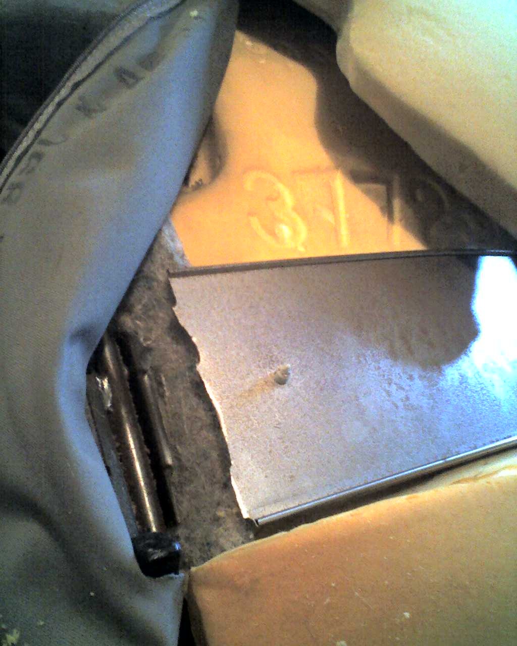

Even the lumbar air-bladder brace was broken -welding this was like welding tin-foil, but it eventually came out okay.  Unfortunately, the bladder is leaking at the hose inlet, and is too brittle to repair.

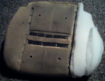

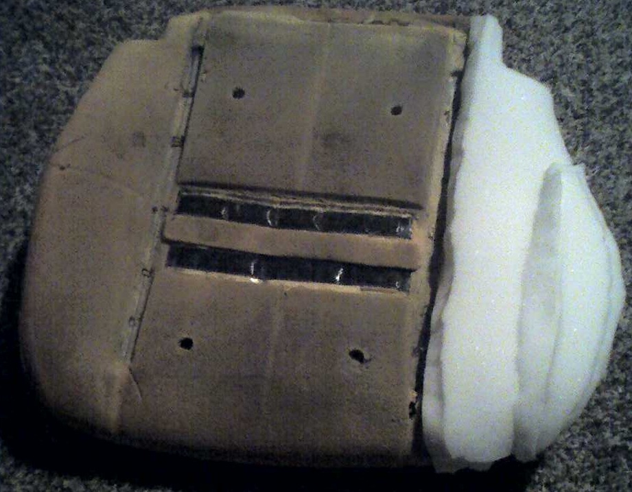

I used foam to repair the crushed edge of the seat-pan and the hole in the side of the seat-back.  Because it isn't as dense as the original foam, I cut it over-sized and relied on the seat-cover to compress it into shape...
Overall, the covers cleaned-up pretty well, and although far less than perfect, even the stitching repair turned out acceptably.

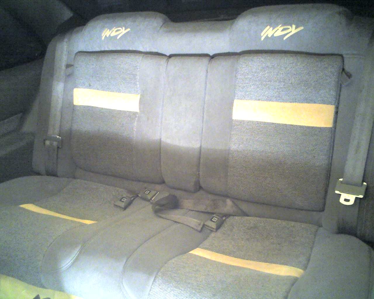

I haven't stripped the rear seat-back for washing because it wasn't that bad.  A steam-cleaner with an upholstery attachment will suffice.  The rear seat pan cleaned up well, except for the yellow stripping which has some discoloration.
