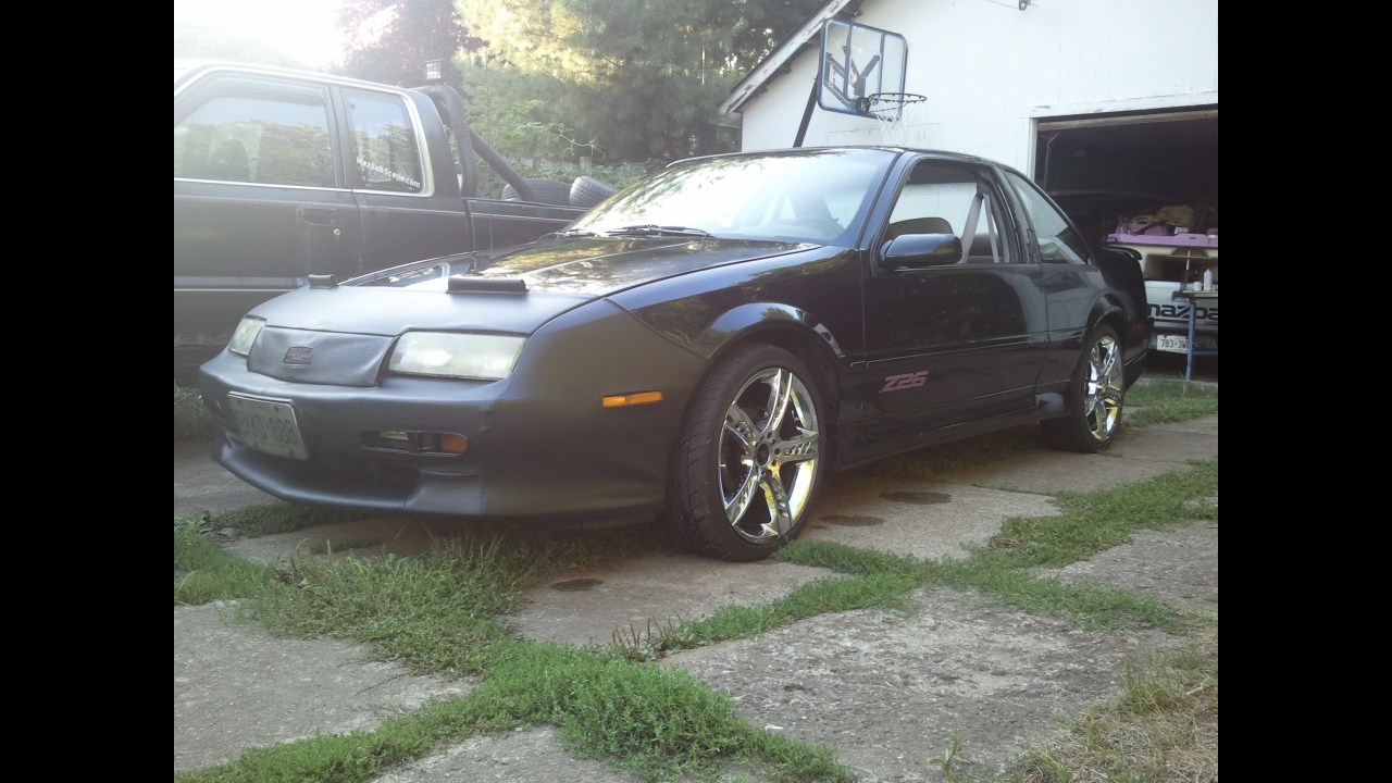

18"s fit pretty well. 225/40r18
![Image](http://img.photobucket.com/albums/v609/berettaboi/carandtrucksigsize-1.jpg)
