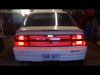

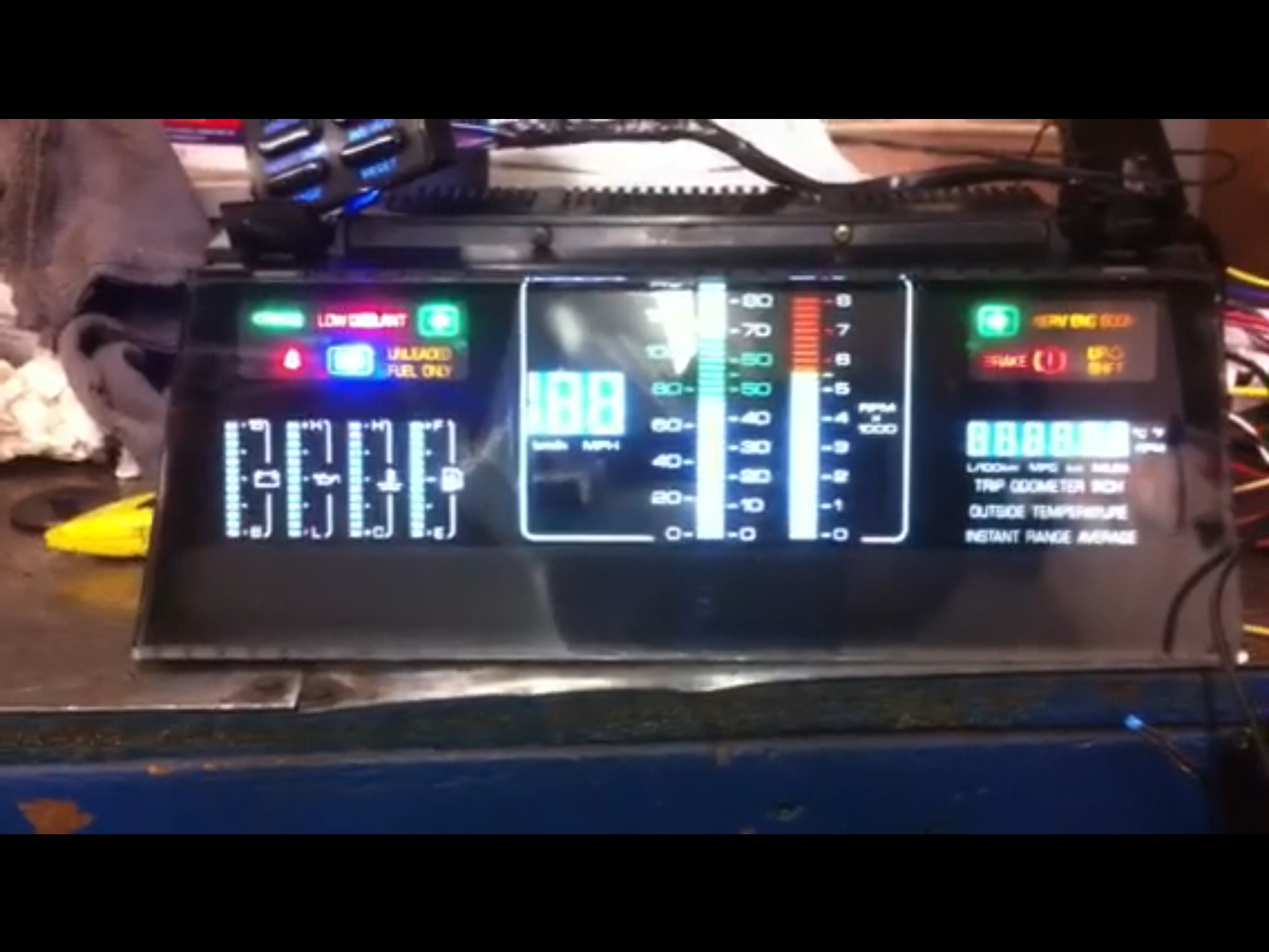

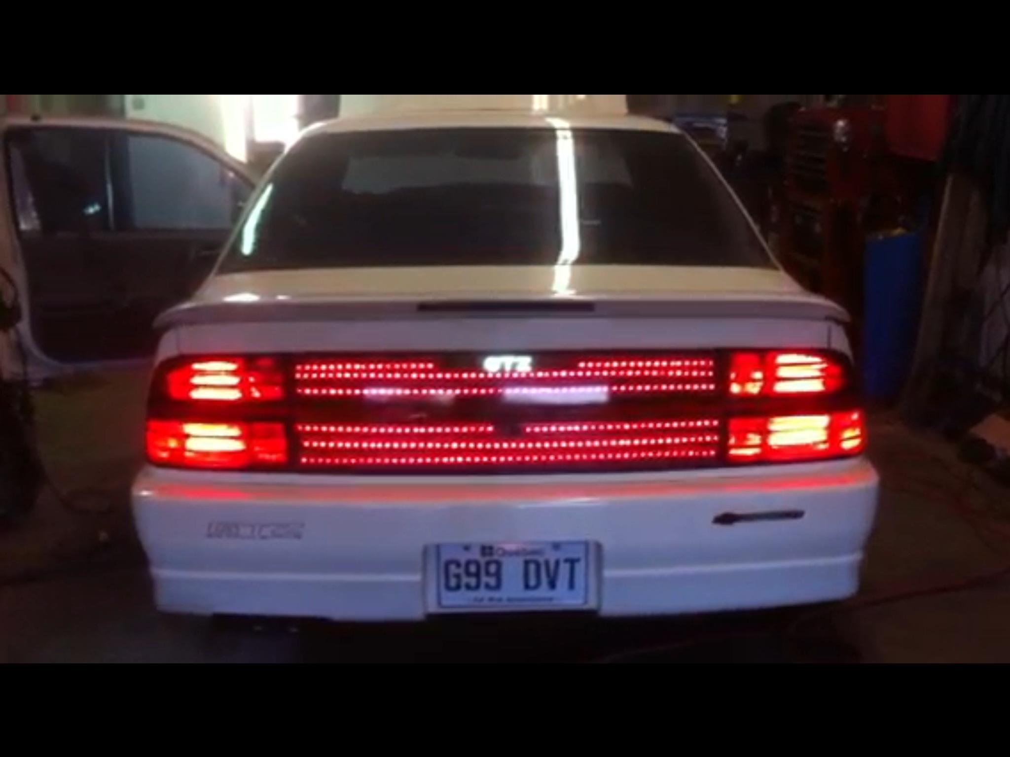

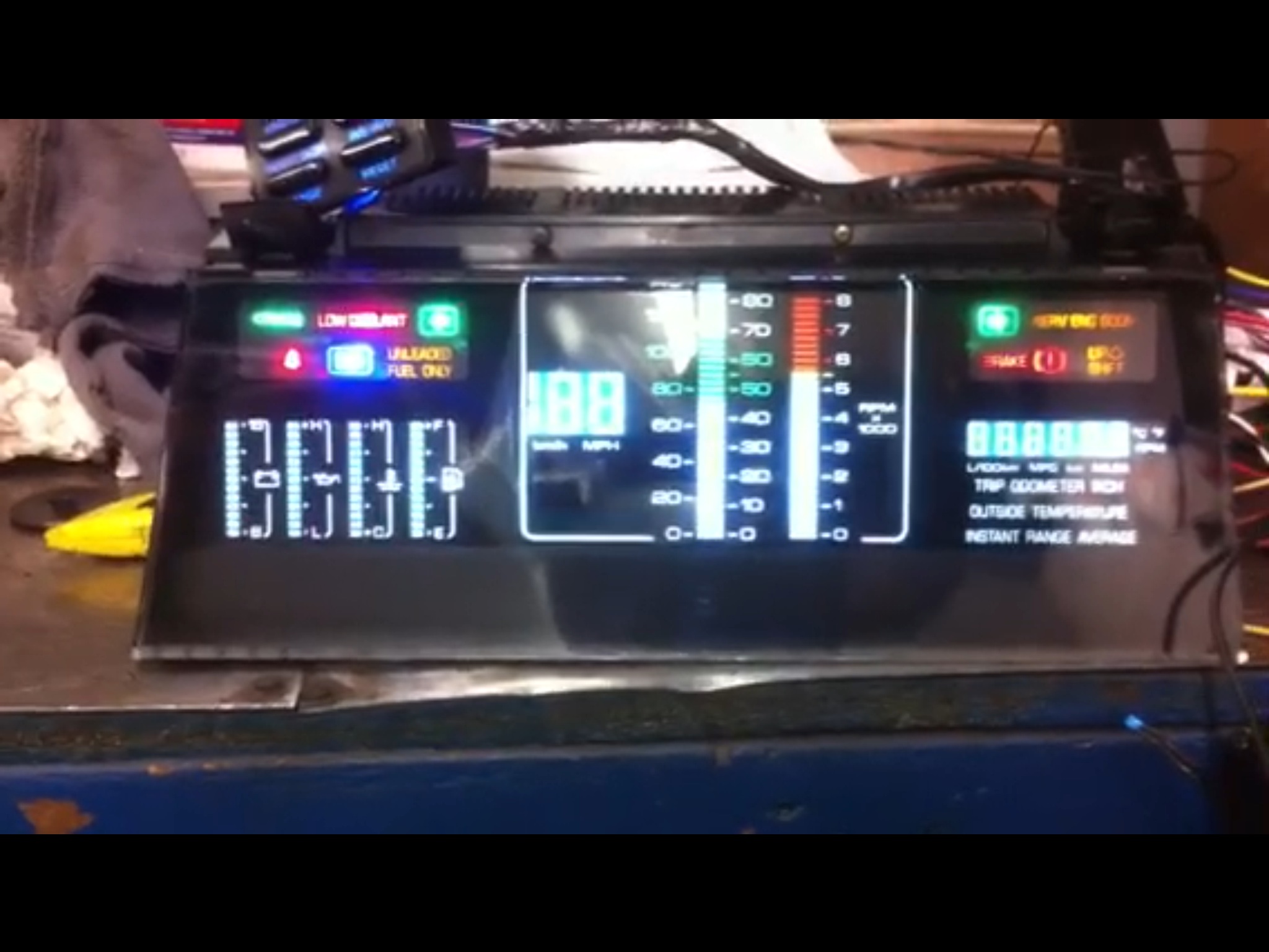

I can fix those cluster and changes colors too, put LEDs in... Same with all the lights in and around the car.
Been doing that since my first beretta gt in 88.
I found a good old 1990 Gtz , having fun with it...

The oil, volt and rpm comes from the ECM, what I found so far is if the car was not with a digital cluster, even if you do find the right wire harness, the prom has to be reprogrammed in the ECM.
Unless someone finds another solution.
I connected the data line from the obd1 connector to the serial data input of the cluster... Nothing, of course I have a quad4, the digital cluster where found mostly in the 2.8 and 3.1

thespock67 wrote:The oil, volt and rpm comes from the ECM, what I found so far is if the car was not with a digital cluster, even if you do find the right wire harness, the prom has to be reprogrammed in the ECM.
You should make a post about how you modified the cluster, and are using it with a 2.3. People would be interested in that, as it will just end up getting buried here in wanted.
