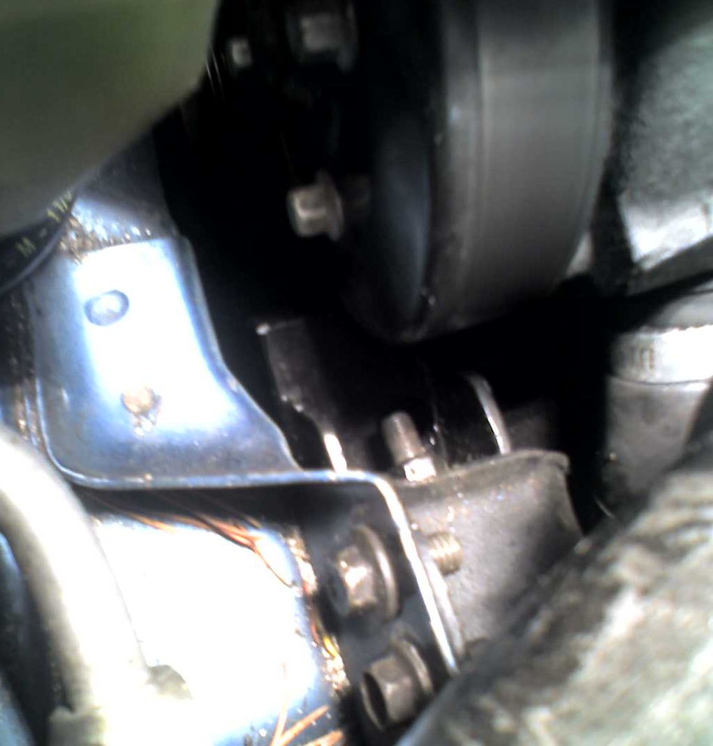

Tylerlp wrote:What do i need for my 91 3.1 5 speed to swap to a 3400? couldnt find a definite answer for how to actually make the custom front mount so how is it done? what are the measurements? i also have a bar that goes from one k frame to the other so is that going to be in the way? And last but not least can i use a 96 obd2 harness and just not plug in the abs stuff and the trans stuff?
Dang, I wish I had just made two or three front engine-mounts when I built the one for my '90 LG5 turbo 'Retta upon upgrading the block to a 3400... The one from the link is really nice, if you can actually build it (correctly), but what a beast! How many pieces go together on that jigsaw puzzle? Mine has two...
Plus the two nuts I welded in place for ease of installation.
Front Engine Mount in my '90 'Retta, using a 3400 block.
