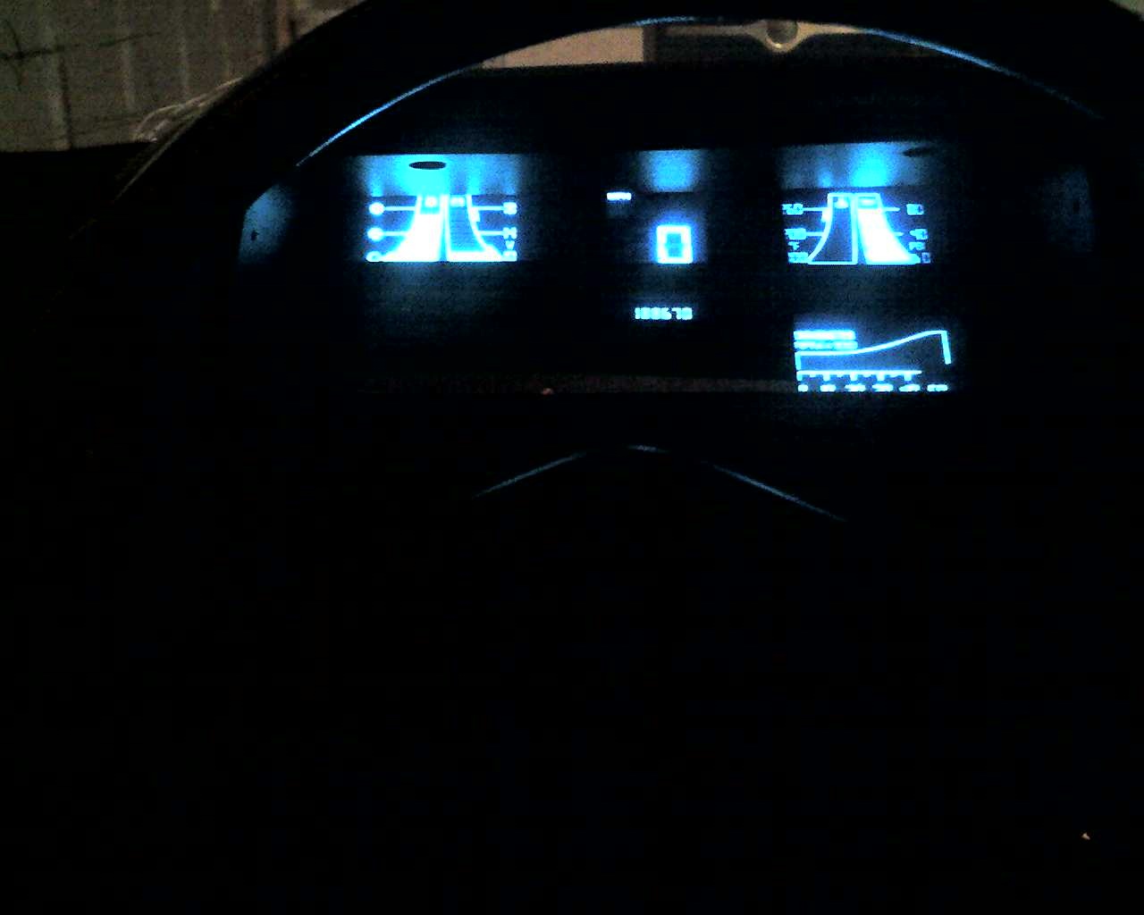

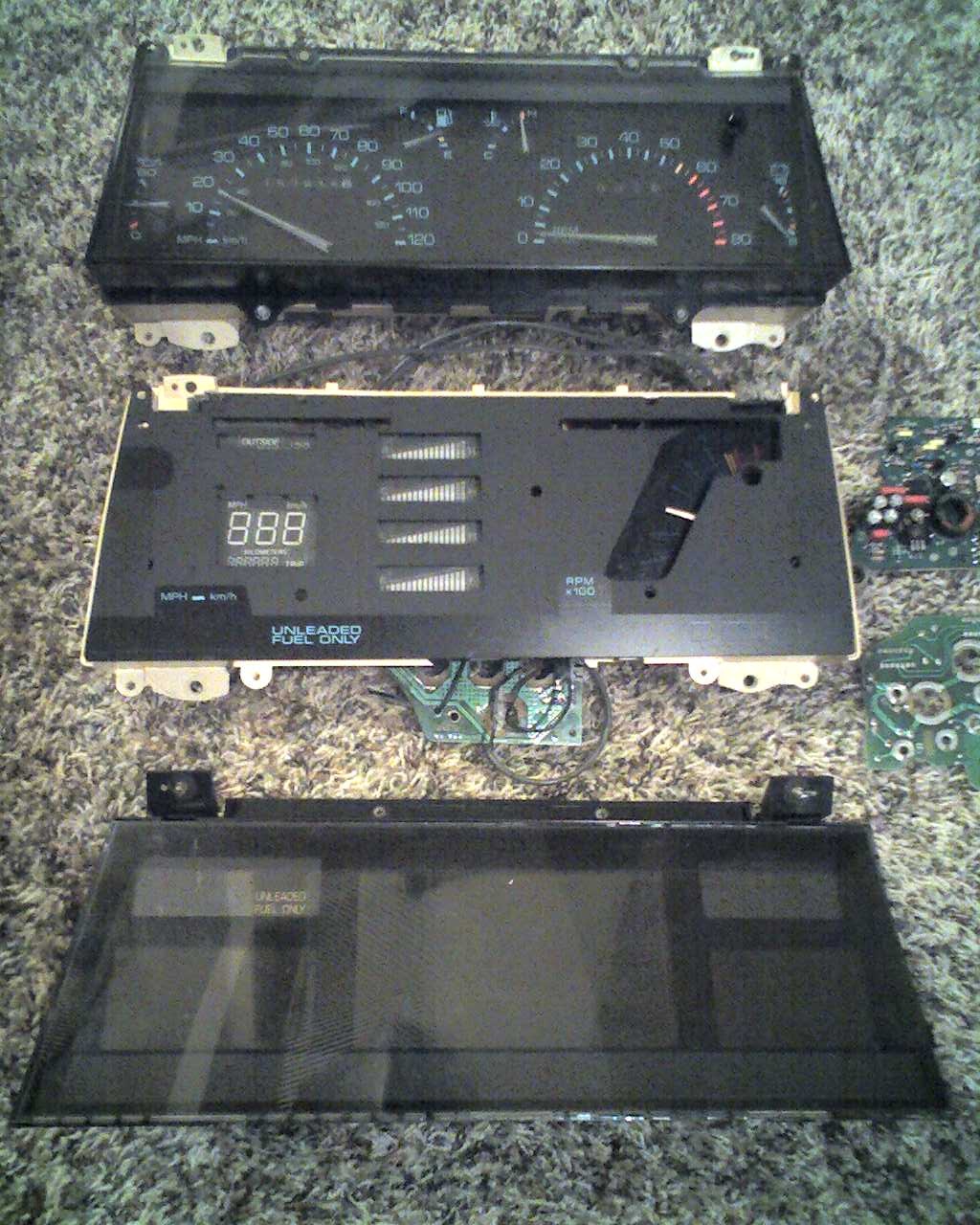

I was pushing to the point of wanting a sledge-hammer for the '90 Turbo 'Retta a couple of weeks ago -I just couldn't get her to stop bleeding oil. Until I finally switched-out the aluminum tubing for the turbo's oil-supply with copper -I think I mentioned that here already, just not the extent of my frustration with it. I've also ordered a Dakota Digital SGI-5 to correct the speedometer issues, that way I can use the Cavalier Z-24 Getrag 282 with the 'wrong' VSS and use the original instruments from the car. I have given up finding another good Z-24 digital instruments cluster for a reasonable price. Too bad, it looked really good in the car...woody90gtz wrote:Set mine on fire. No not really. But I thought about it.
I made a translucent blue cover-lens for the cluster too.
Or, I can use the SGI-5 on the S-15 Blazer digital instruments I have in the car now, but I still wouldn't have a functional tach since the Blazer uses a distributor, and I would have to tinker with a pickup-coil to make a signal generator for the instruments.

"The chip"? It sounds like you are familiar with the issue I'm facing here, but just to clarify, I mistakenly put in a Muncie/Getrag 282 from a late '80s Cavalier Z-24 2.8 V-6 car, that had the digital speedometer, into my '90 'Retta. The VSS (Vehicle Speed Sensor) is NOT compatible with the Beretta's speedometer. One of them uses an AC sin-wave output signal, while the other utilizes a DC square-wave 'PPM' (pulse-per-mile) setup. Or, to put it another way, the Cavy VSS is basically a miniature alternator, while the Beretta uses a Hall Effect sensor with a reluctor-ring. This isn't a simple case of trying to correct a speedometer that is reading off a little, I had no speedometer function at all. It is like trying to start your car by jump-starting its' battery with an extension-cord from your house. Additionally, the Cavalier VSS sends its' signal straight to the speedometer, NOT to the ECM like the Beretta does, so I can't just drop-in the Cavy's PROM chip to fix it, the Cavy's speedometer corrects the Sin-wave signal into DC PPM and sends that signal out to the car's ECM for speed data, essentially acting as a built-in buffer. I do have a buffer from a four-wheel-drive truck for the S-15's instruments that can be 'programmed' for different gear-ratios and tire-sizes (GM factory setup, no less), but it lacks the versatility to accept a signal from a 40-tooth reluctor-ring on the final-drive (what our Berettas use) as compared to the 40-tooth ring on the drive-shaft prior to the axle's final-drive ratio (2.76-5.~:1), so my speedometer would read extremely low. Additionally, it still requires a Hall-Effect DC signal, NOT the AC Sin-wave that the Cavalier's VSS is producing, so it still doesn't work. I've thought about putting in a wheel-spindle from an ABS car, because the ABS sensor's reluctor-ring has so many more teeth on it that it would help correct the calibration issue and provide the DC Square-wave that either the Beretta cluster or the S-15 digital cluster needs. The Cavalier's digital speedometer is calibrated and compatible with the VSS in the car now, and I made a drop-in housing for it, and it looked good too, but they are very hard to find for a good price in functional condition. The last option I have is to use a speed-buffer from a late '80s Firebird (which had an analog speedometer with an electronic AC Sin-wave VSS, like the Cavy's), or an early '80s Camaro Berlinetta (which used digital instruments and the same sensor). I have one in the garage already. But the calibration would be off in the same way that the four-wheel drive buffer would be, so I would still need something to correct the calibration, but at least the signal type is compatible... Overall, the SGI-5 seems like a simpler alternative, and I'm getting tired of messing around, I have other projects I would like to get to.Cliff8928 wrote:I corrected that problem with the chip. It's all in the programming.Rettax3 wrote:I've also ordered a Dakota Digital SGI-5 to correct the speedometer issues, that way I can use the Cavalier Z-24 Getrag 282 with the 'wrong' VSS and use the original instruments from the car.
So, if there is a cheap 'chip' that fixes this, I'm all ears, so to speak. I'm getting my SGI-5 new for $76, and it isn't difficult to install, plus I can fine-tune it for a correct speedometer (an almost unknown concept in a Beretta
