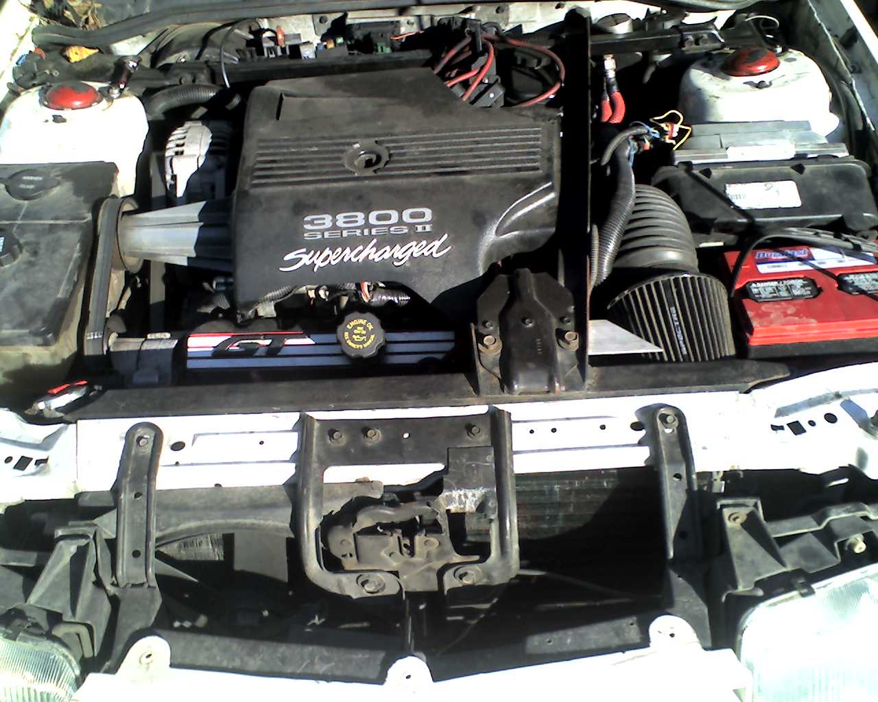

The 'u' on the valve-cover GTU fell off,  I still have to put it back on.  And wash the engine-bay down.  Twice.

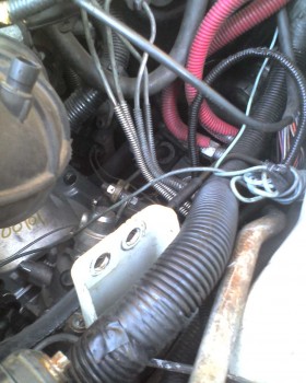

I modified one shifter-cable by popping out the plastic retainer on the end, and put in a bolt with cotter-pin.  Ooo, that was tough.

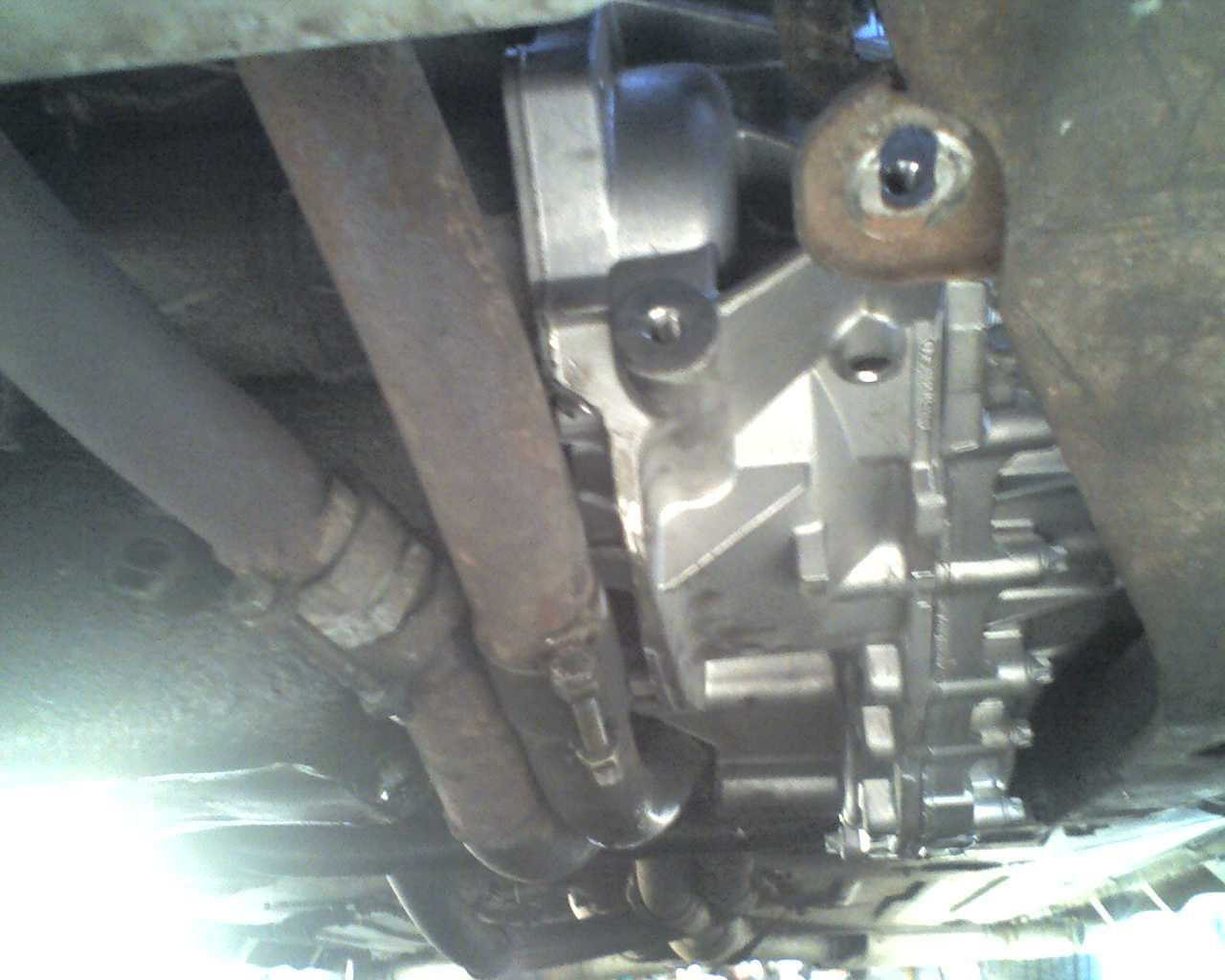

Becaue of the insane headers on my car (which are not as badly rusted as they look, but they are showing a lot of surface-rust at this point), I had to modify the bell-housing to clear two of the primaries.  Stock 3800 exhaust uses a cross-over on the top like the stock Beretta V-6s.
