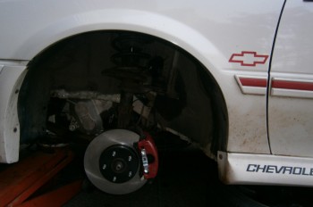

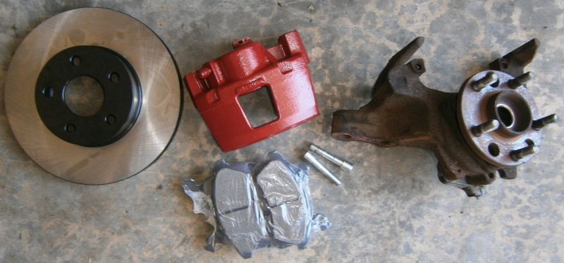

Also worked on the GTU's VSS issue. I initially bought a Dakota Digital speedometer calibration unit to correct for the over-active VSS signal from the F40 six-speed, but now I'm saving that for the '90 turbo instead. I bought a used newer-style spindle, new brake rotor, caliper (which showed up looking so pretty in gold anti-corrosion coating, I decided to protect it with some red caliper paint), and Raybestos pads (I installed Raybestos pads on the '90 turbo many years ago, before I even owned the car, I have yet to replace them again and they stop the car great). I still have the entire left spindle/hub/brake assembly as a spare, and it directly fits four of my cars for sure, possibly two or three others, and in a pinch can be used on two more, so it is nice to have. I had to re-mount the ABS sensor because of the different shape of the Cobalt outer CV-joint pushing the Muncie 282's VSS reluctor-ring deeper into the car, so that was a headache. But it is done now, and working fine -the speedometer is just as accurate as it used to be, and that is remarkably good on this car. So now, it is test-driving time! :twisted: I should have shot a video of the speedometer before I corrected this though -0 to 118 in five seconds flat!
I know I'll take some heat for putting one new-style brake in opposite an old-style brake, but piston-sizes are the same and rotor-diameter is identical despite them being different part numbers, and at least under light to moderate braking it does not cause the car to veer to one side or another at all, so pending a severe braking test, I'm going to go on record as saying that the newer-style brakes are newer, not more effective (although they do look a little more rigid, maybe heavier-duty, but as I've never had a brake failure on any of my old-style brake cars, I don't know if that is strictly necessary). I will eventually paint the other caliper now, but someone paying attention might still notice that one side has the caliper on the front, and the other side has it on the back. :roll:
Too much time invested in this part of the six-speed swap.  But it was cheaper than another VSS calibration unit.  I feel good about all the new parts though, and better about not modifying the car's wiring to fix the VSS issue.
It looks good in there.  The F40 is peaking out.  I should have re-painted and protective-coated inside the wheel-well, I'll probably do that when I do my inspection on the assembly again in the next 500-1000 miles.  I am also kicking myself for forgetting to order a new brake-hose since I had the lines cracked anyway -the old hose looks ready to retire, it is doubtless the original hose, 24 years later.
