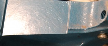

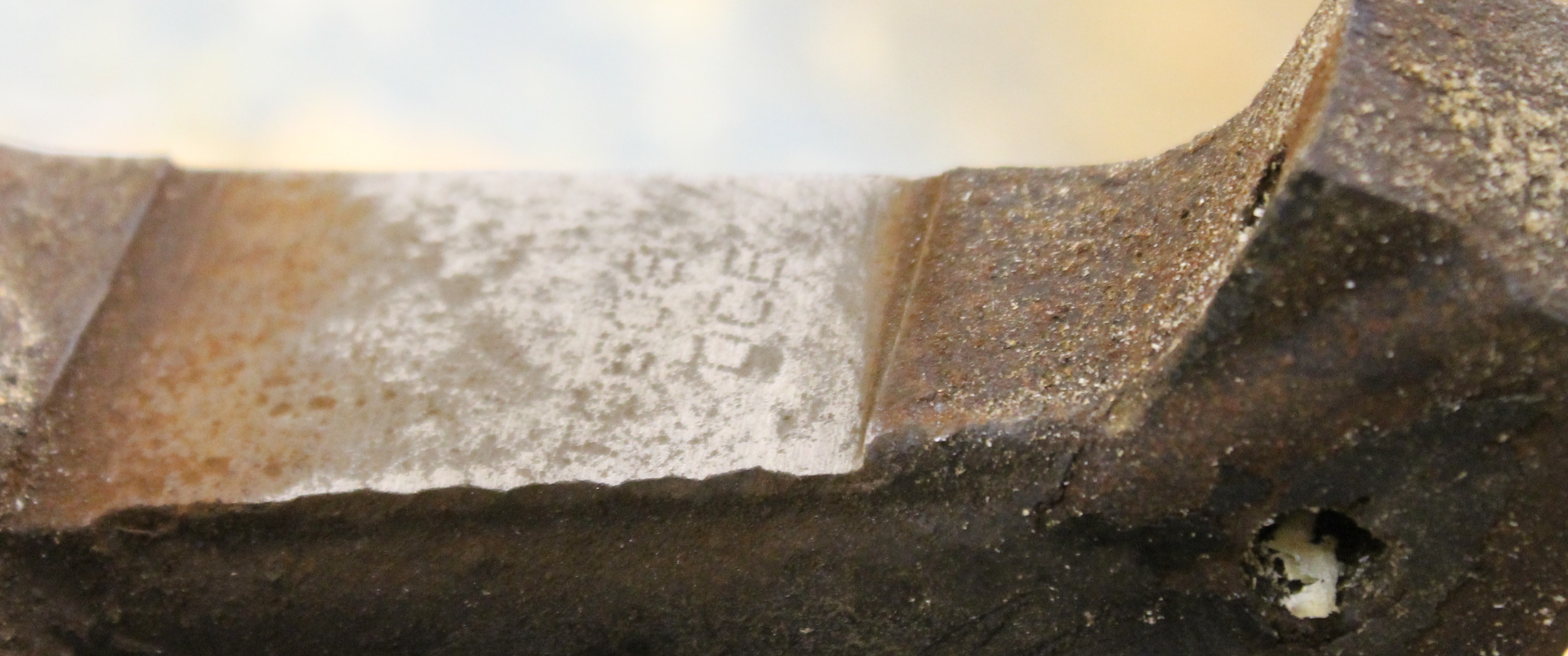

Engine ID is dot matrix stamped (pin printed) on the engine block. It's impossible to see if the block is badly rusted. 1992 Beretta GT (the rusted block), 1996 Z26 the blue block

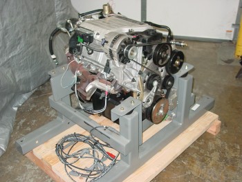

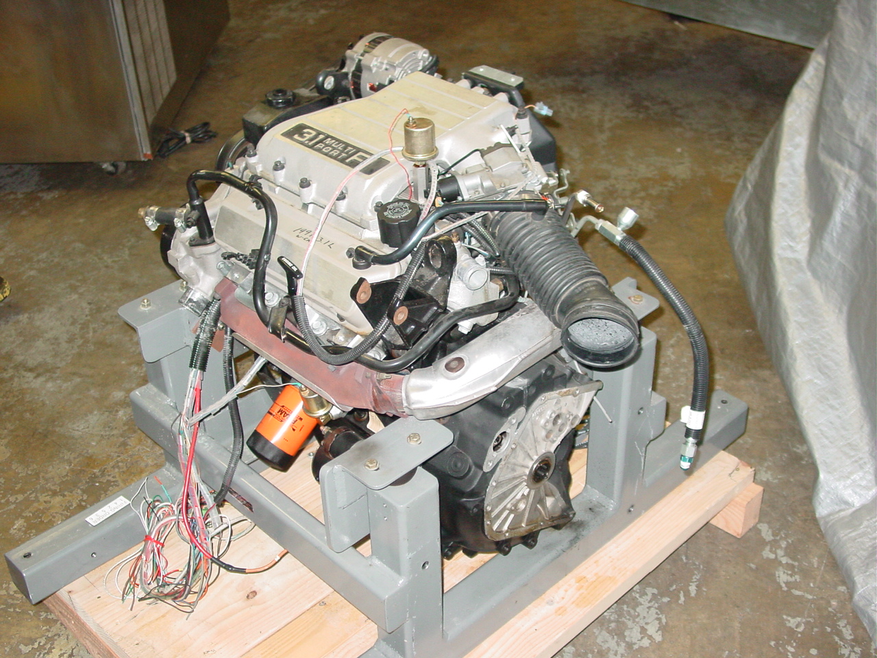

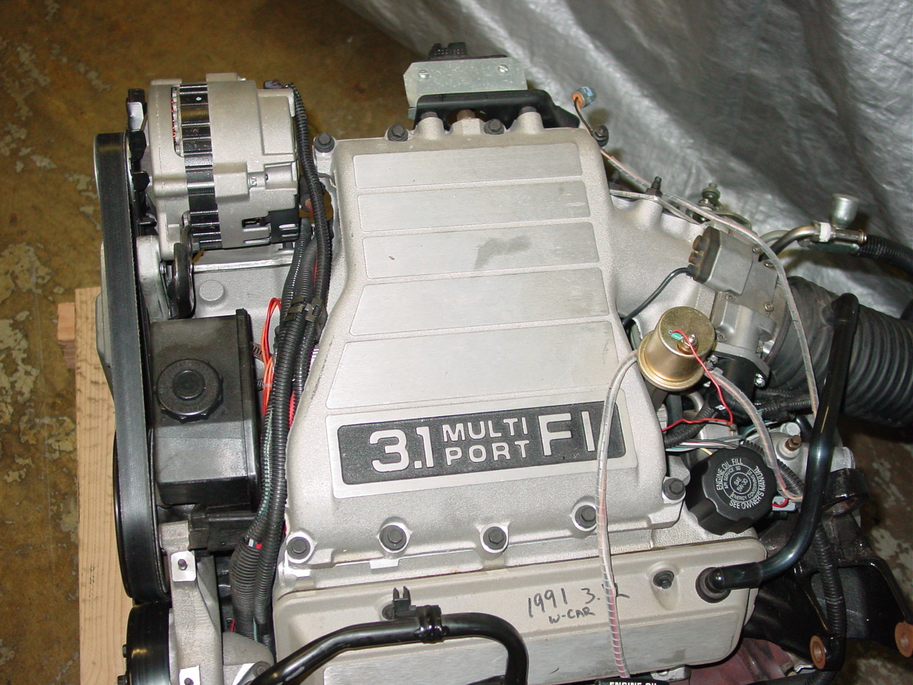

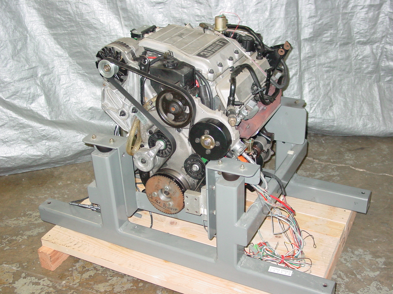

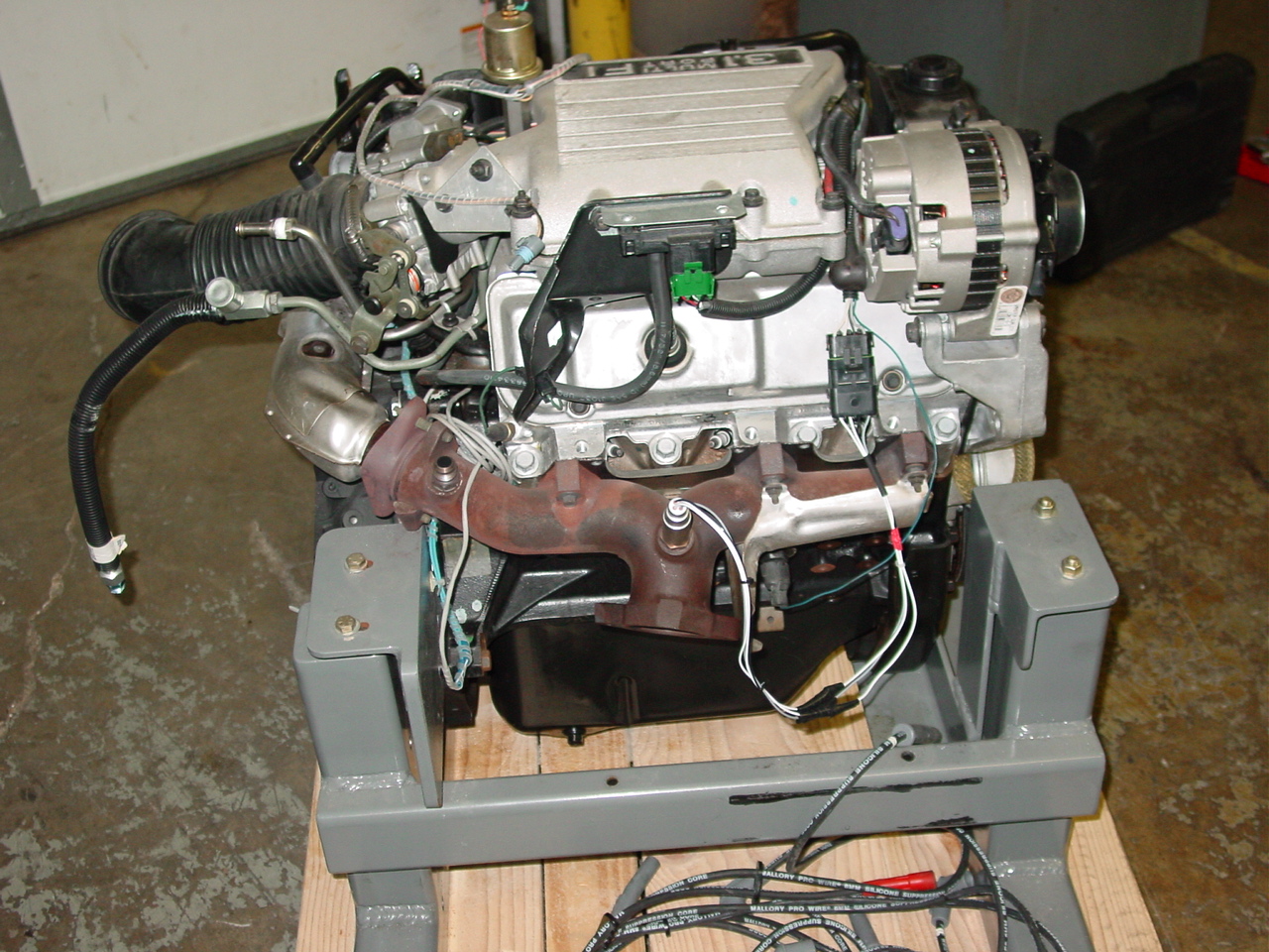

Here are the photos of the engine the seller sent me.....now I am concerned that it wont work based on the issues of the mounting bracket etc.
Any thoughts after seeing these?
Re: 1991 3.1L V6 Compatibility with Indy
That is the same as yours!! Good to go.
Thanks Eric, that is a major relief.
- Posts: 10919
Well externally it is the same yes, but there is some funky crap on that motor... They have an oddball crank sensor on the main pulley, not sure why thats there and a few other electronic sensors.
I'm guessing if you pull all that off and just use the engine as is and bolt on your items you should be fine, but I would definately check everything over including try to measure the cam or anything else to see if there are some odd parts in it as well.
