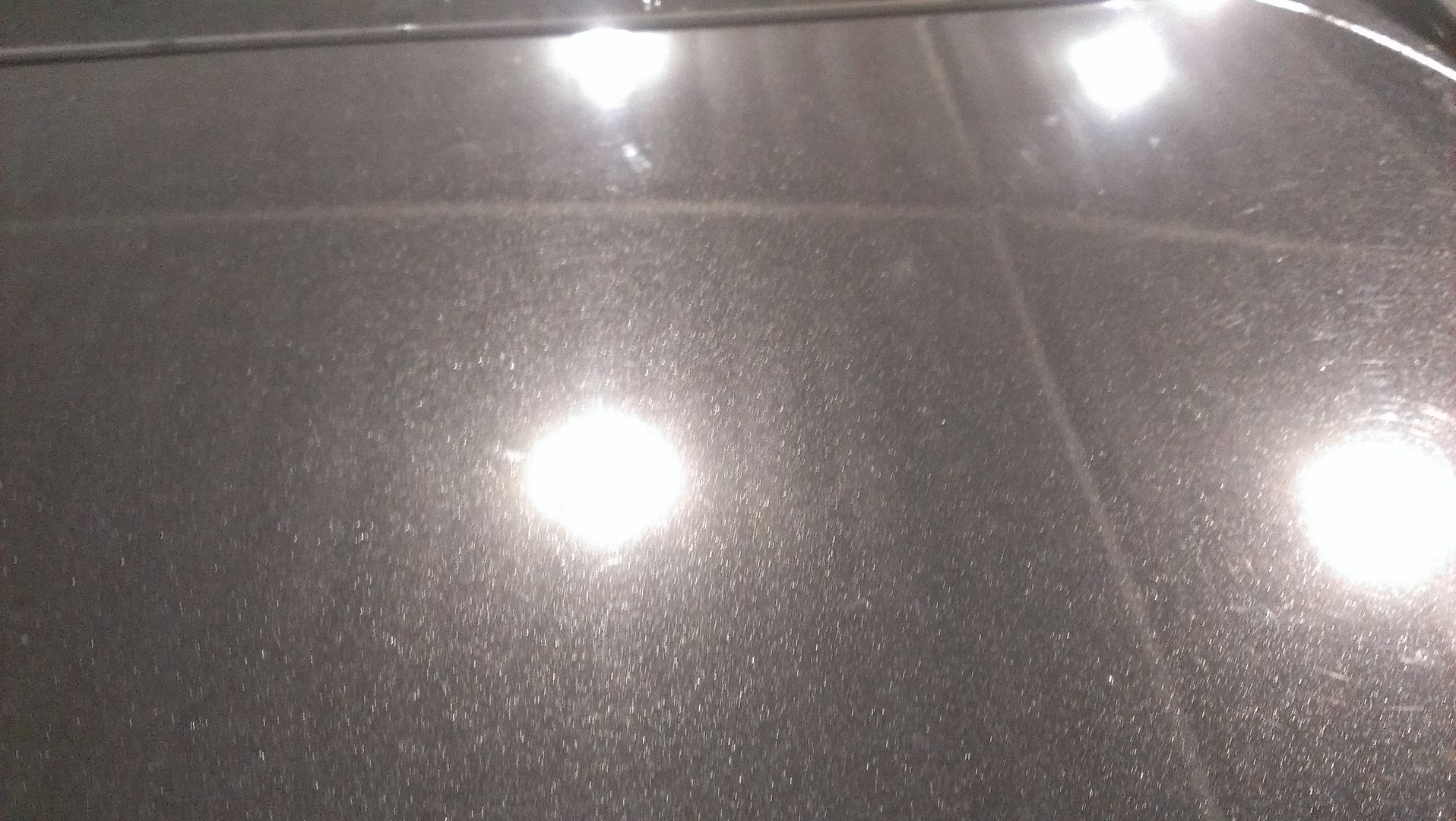

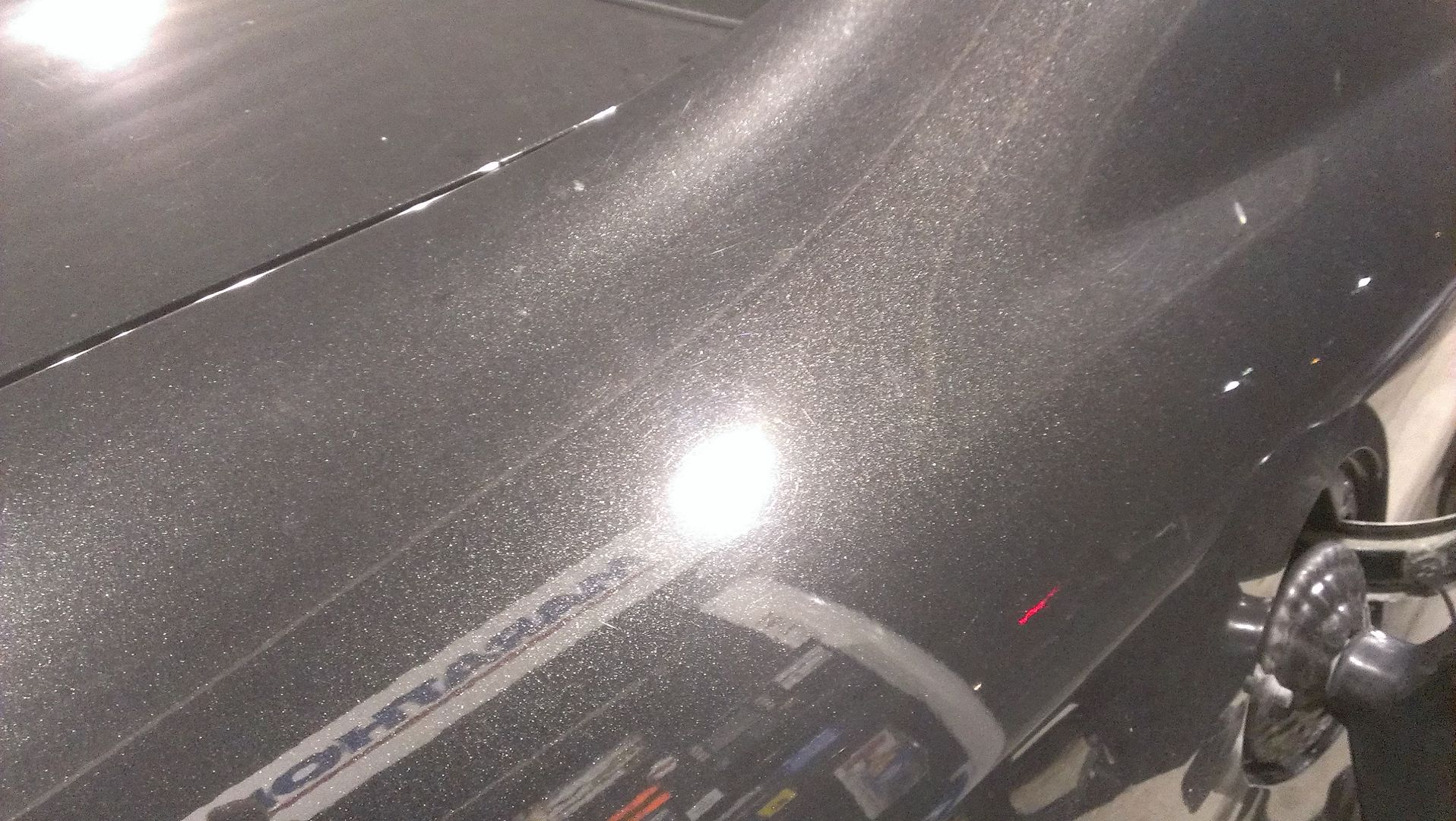

I know a lot of people in the group didn't like that I took the rarity out of this car by putting a V6 and all that in.. but I am glad the rarity is gone. I was afraid to make the car what I want because of that.
The overall plan is all the darker plastic trim on the interior is going to gloss black.
I am covering up the ZR1 shift pattern with vinyl (i tried using several different methods to remove the shift pattern to leave the brushed aluminum but no luck) then putting a emblem I got from Rodney Dickman on the shift plate that has the right shift pattern on the shift plate.
I am also ordering factory suede ZR1 black suede with red stitching e brake handle and boot to custom fit on the center console to match the shift boot.
Sometime during this winter I am sending off the factory Beretta steering wheel to get covered in black suede with red baseball stitching. Already have a price quote for it.
If all that gets done and I have extra money I want to get the factory seats redone in black . I haven't found a place to do that yet.
Future? I think within the next couple years I would like to get the car painted the same color as my 2010 Malibu. Its black granite metallic.
I would love Cayenne red.. but since its a factory black car I just want to make it a deeper black..
