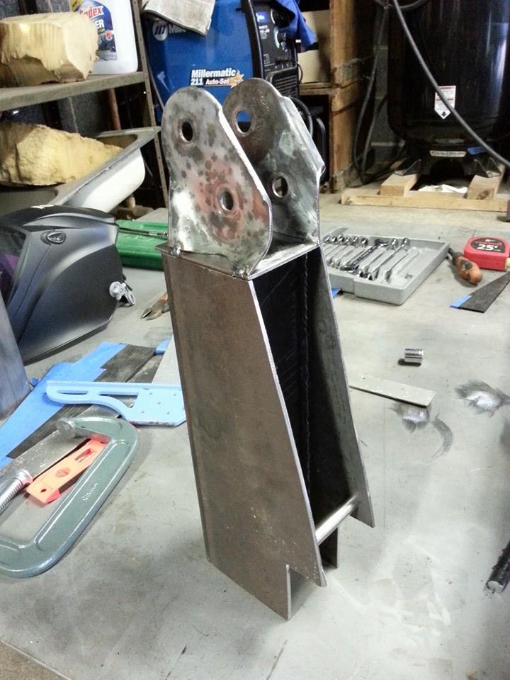

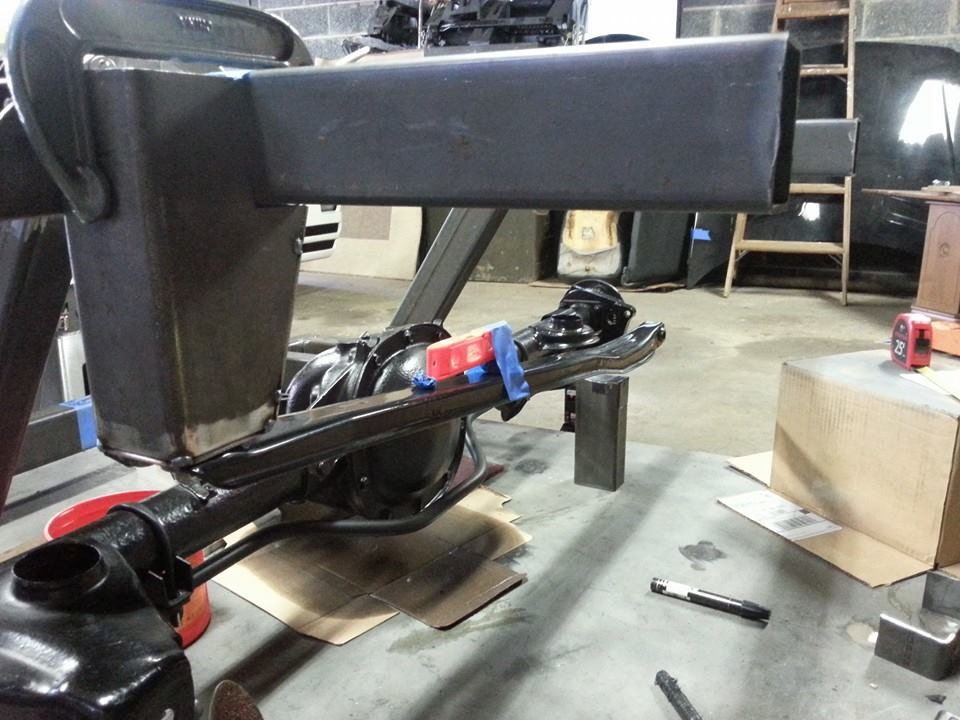

Driver side panhard bar bracket done and upper panhard bar brace cleaned repainted and mocked up

Post by jjanke »
panhard bar

Going to add subframe connectors?

Im gonna run 3x2 box (body rails) from the rear sub up to the fire walland tie a cage into that......im thinkin the cage will add all the strength I need but we will see......sub frame connectors cant hurt.....

passenger side panhard bar bracket mocked up and panhard bar installed

made some more room for the new rear subframe

That looks like it's going to be really uncomfortable to drive... LOL ;)
Posts: 1822
Re: Beretta Z28
3X00-Modified wrote:That looks like it's going to be really uncomfortable to drive... LOL ;)
Very safe though! %)
