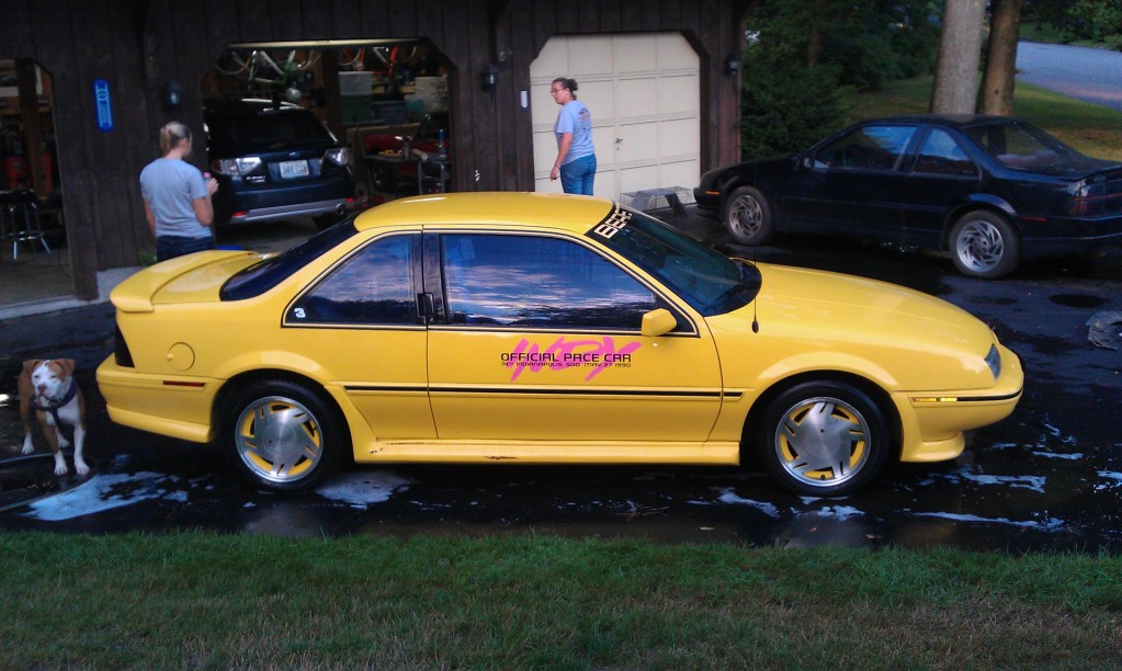

Car all loaded up on the trailer... We drove down with the trailer expecting to just buy it after negotiation because the pics of the condition were that good.
Car had been painted at one time, that was the only downfall... The trunk and hood were done very poorly so I knew I had to get those re-done... The right side GFX was also hit at one point and flexed and cracked off the paint so that had to be re-done/replaced. The big "Problem" with the car was a bad injector that was preventing it from running properly.
Home off the trailer...

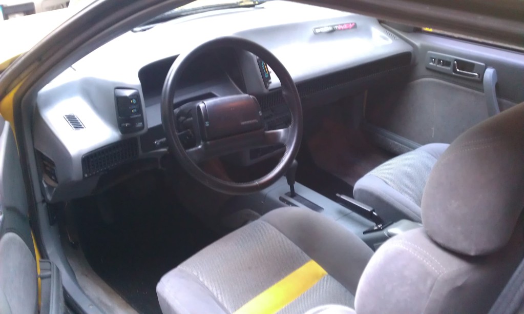

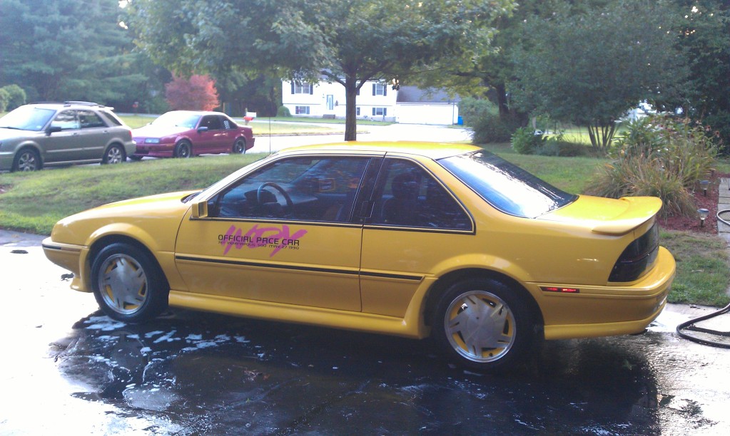

Scuffs Poor wheels Reproduction die cut decals already on the car Very good condition interior... Dash bubbled and cracked though. Missing Lower panels as well Surprises in the glove box Rust free rockers, just lots of mildew... First wash Making Decals... Time I invested in Indy stuff all makes sense now doesn't it

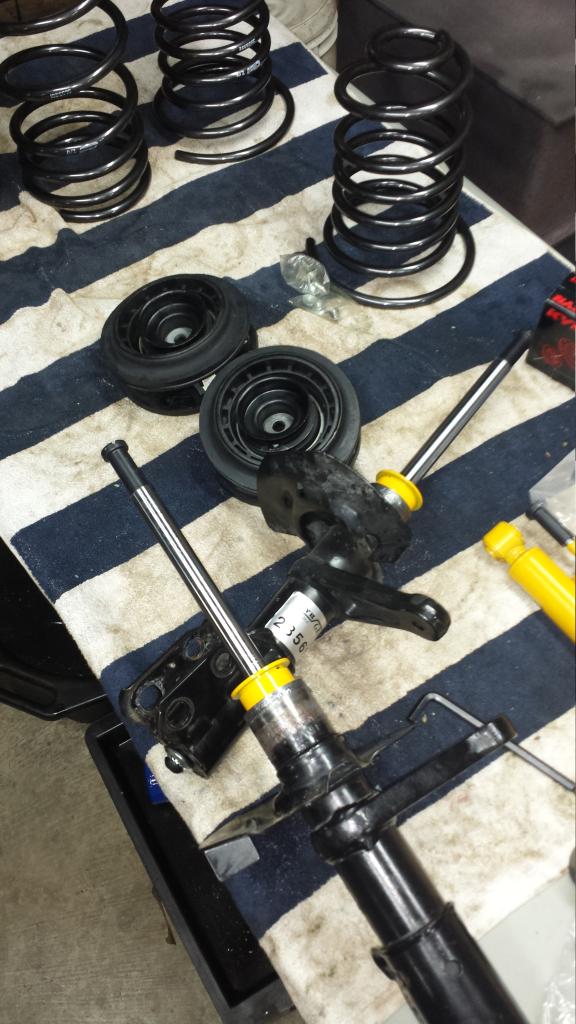

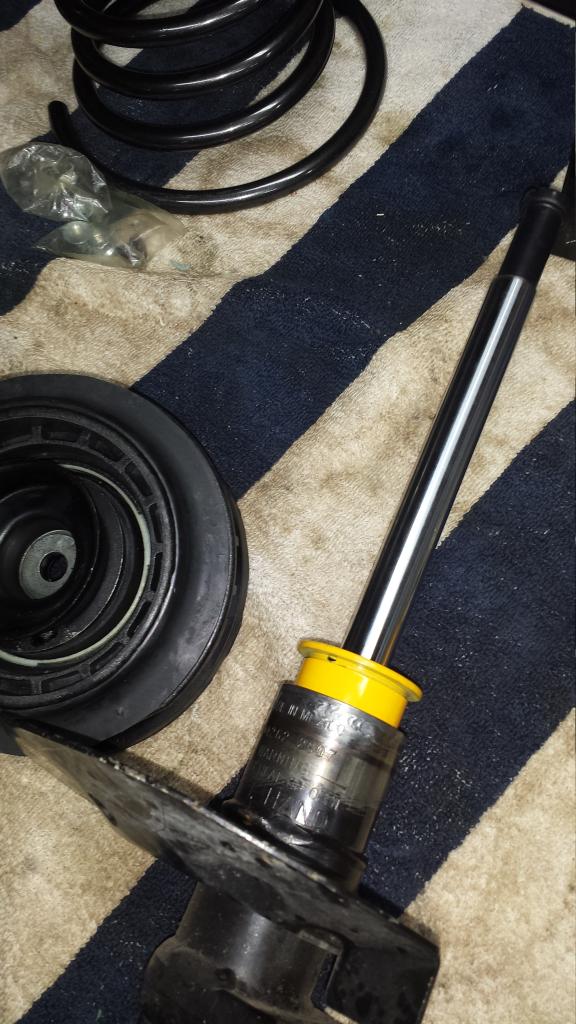

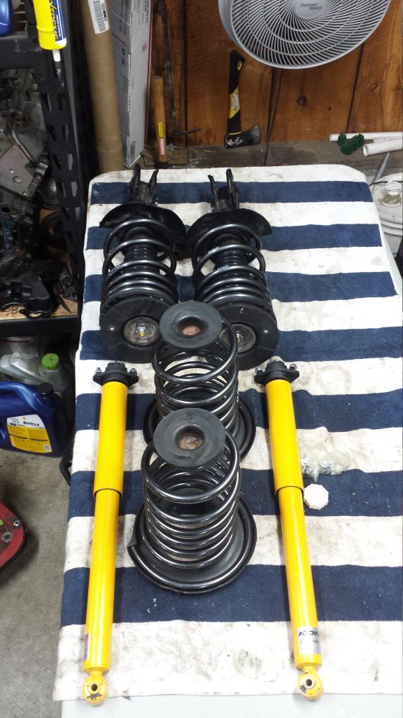

Koni's for the front
Already had rears because the first set of Saabs I bought for the 96 were too long for it and are direct bolt in for the 90.

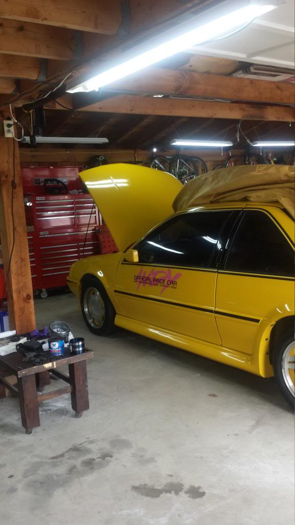

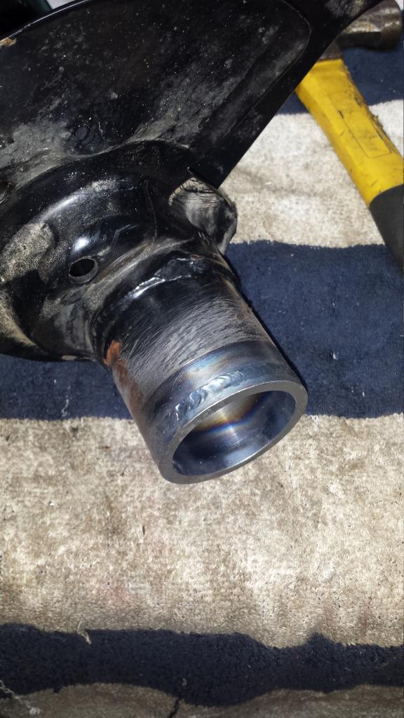

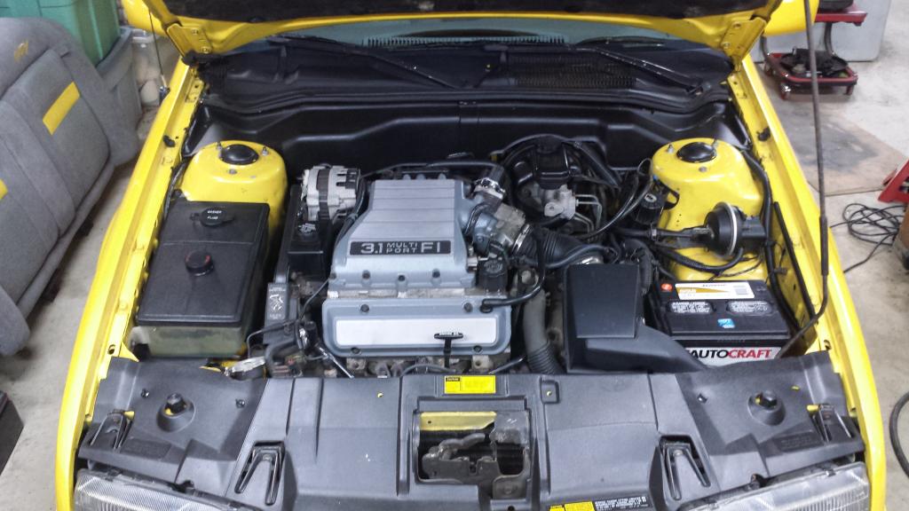

ORIGINAL AC delco plugs... Another reason why it ran like crap, in conjunction with the original wires. Bfest Prep, still need to get hood painted and full suspension upgraded but back to running properly... New wires new plugs, new crank sensor, new oil pan gasket new valve cover gaskets new EGR. KONI fun Weld in bushings KONI installed Suspension TCC and trans filter/fluid all changed, waiting for parts back from paint Applying new decals waiting for drivers door decal and spoiler... Other parts on Engine bay Rolling through the mountains... I will post other photos as other stuff is done to it.
I plan on pulling the engine eventually doing a full freshen and maybe slipping in a new Crane H-272-2 cam in there, a set of 1.6 roller rockers, as well as making a set of my TOG headers fit it... Unless I fall upon the parts it will probably remain an auto though.

Amy loves how it handles with the Koni Eibach combo but says it could use a bit more pep. LOL go figure.
